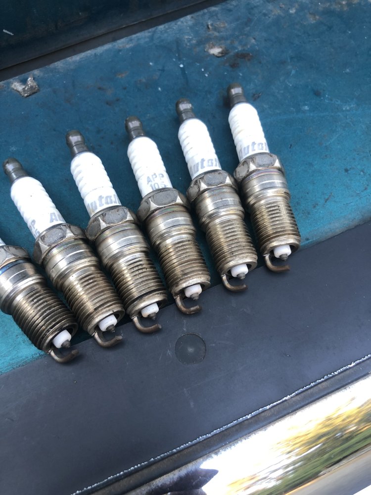

I just have a simple question... what spark plugs did you put in it?

The test was performed with the engine about halfway up to temperature after having driven it and letting it cool, Because nobody needs to burn the crap out of their hands and fingers pulling these plugs especially on the first bank where it’s crowded by the AC unit
The plugs are autolite APP105 double platinum gapped to .053.
Plugs pic after thirty miles driven.

Listening patiently for results of thoughts on compression test versus the issue this truck is experiencing.
I’m kinda insulted, but not in a fluffy democrat way, but in the way where I know that the overall compression has zero to do with an electrical issue or fuel pressure issue.
