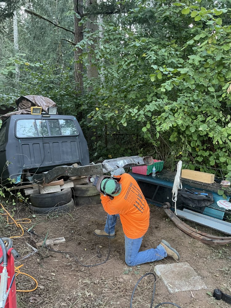

Hey guys I’m looking for some input on my memorial truck build, doing a axle swap on a 92’ standard cab ranger, I have a Dana 44 HP for the front and a Sterling 10.5 for the rear, it’s going to be leaf’s front and rear as far as the lift goes, also dropping a HO 5.0 from a 86 mustang to replace the blown up stock 2.3, my questions are what the best combination of leaf’s and shackles would be for the goal of running 39.5s, also with dropping this 5.0 in, I have both the wiring harness from the 92 ranger and the 86 mustang, but both were automatics, but wanting this build to be manual transmission.. will either of these harnesses work for the swap or is there a better route to go… also open to other issues I may run across that I may not have thought of! Thanks!! And if anyone has detailed pictures of a similar build I’d really like to see them for reference!
