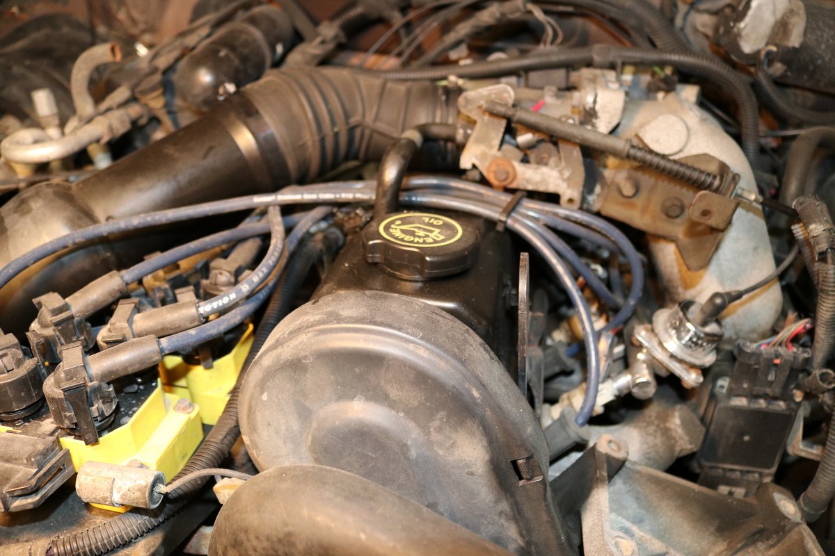

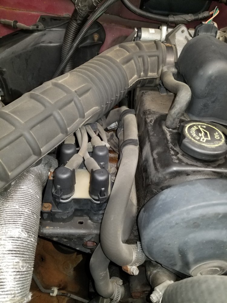

I think what threw me off was the coil pack, I will attach 2 photos. I did look closer and find the other 4 spark plugs so I should be good to go with the swap I think?

Yes, 1989 to 1994 2.3l dual spark plug engines can be easily swapped, 1995-1997 are another story, lol
That does make it a whole lot simpler, direct swap for the most part, they changed a few things here and there, some '90's had a MAP sensor with vacuum hose above the heater box on the firewall, some were MAF. Take pictures before you start, cell phones are good for that...

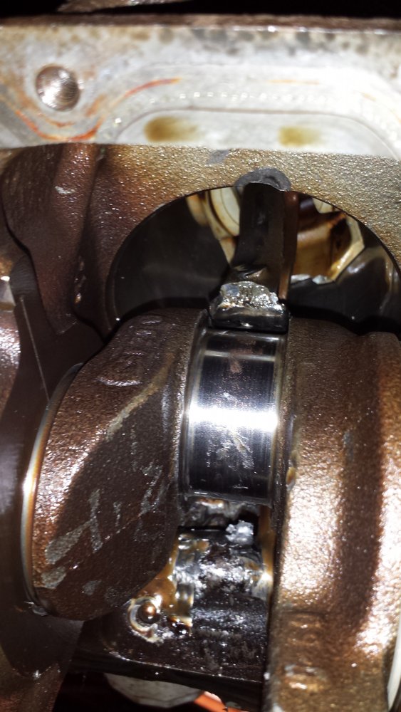

FWIW it isn't that hard to add a crank sensor to the old blocks, I've done it twice but the oil pan does have to come off.
Engines is goes vroom.
This engine stopped going vroom, went kinda clankity clank when it was running when I turned it off... only happened at WOT ~5000rpm... hence why I've put crank sensors on two blocks... it's sad too, that was a great running engine compared to the hack job I did throwing this one together...
Looks like a manufacturing defect for sure :)
It's a common misconception that engines need ALL the connecting rods attached to continue to go vroom.
