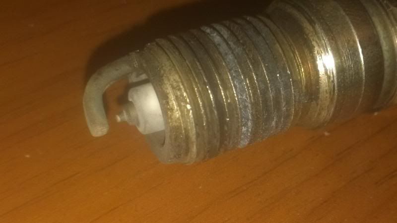

Here are the spark plug pics that I just took.
They look a little brown, but it's a stretch.
Have you tested a bad spark plug with an ohm meter and then a new plug?
Can you clean the plug and have it work again?
