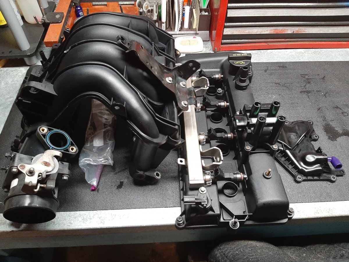

I have the 4 cylinder engine with 4 spark plugs (not the 8). The plug socket won't fit down the recessed head, and not because it's not long enough, and not because I don't have a long enough extension. It won't fit because there is some kind of a plastic guard at the top. How do I remove the plastic/ rubber guard in order to fit a socket down there?

I'll try to get some photos today. The plug wire came out with an angled needle nose pliers. The plug itself is down into the head about 3 inches but that wouldn't be a problem with an extension. The hard rubber ring assembly is at the top of the opening where the long plug boot sits and it seems glued in. Certainly, I'm not the only one to encounter this. The ring seems to be there as an added assurance that water can't get in the "plug tunnel".

The valve cover is on the right, the spark plugs are down those holes in the center. What plastic pieces are you referring to? Nothing comes off, you just use a thin 5/8" spark plug socket.
