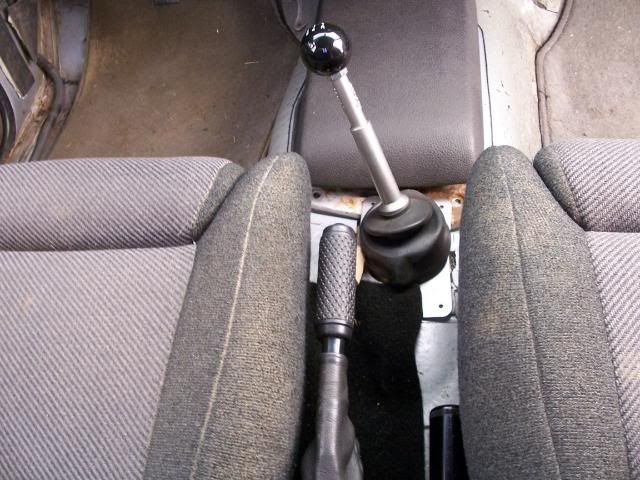

Looks like I can mount it to the floorpan on top of the tunnel close to the left rear trans access cover bolt, near the left front corner of my shifter boot for the T-5 rearmost location.
Here you can see the left rear bolt hole... I'll likely mount the valve about 2 inches behind that hole.

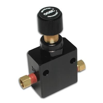

This unit from SSBC is the one I'm thinking of getting...
