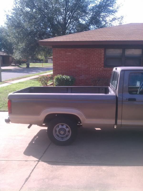

1990 Ford ranger 2.3L with 7.5 rearend, automatic tranny. All stock. Runs fine for 250,000 miles. Transmission kicks when pulling it from park into reverse, and again when shifting from 1st to 2nd. Been doing it for a while.
Goal:
Restored ranger with a 331 stroker, 350rwhp naturally aspirated for now, Street/track truck. Motor/transmission/rearend/suspension first things to be fixed/replaced. After that interior and finally exterior with a paintjob. Had a thread on here quite a while back(year or two), when I first decided I was going to "do something" to the truck. Figured I would let that old post die, too old to recover. I have spent the last year learning everything I can, online and printed word.
I have a general direction where I want to go, but haven't picked out all the "small" parts yet. Plan is to replace the rearend and suspension first. Replace the 7.5 with the stronger 8.8, and new suspension that it needs desperately. After that I plan to hopefully rebuild the motor myself, getting the machine work done here in town(Wichita Falls, tx). I have read about people preferring to do the swap first, and later pull it to do the rebuild. The motor runs currently, but I would prefer to get the short block completely rebuilt and done before installing it. The general picture right now is to rebuild it with a ~forged 331 stroker kit, get the original heads ported/polished, and springs/rollers/valves etc. ~Rebuild the transmission. Install the motor and tranny. Enjoy the new power that this brings for a while. Then after that becomes boring, replace the stock heads with aftermarket aluminum heads, but keep the compression relatively low. Finish up the whole package with a supercharger down the road.
I completely understand the forged internals are not necessary for the goal of 350rwhp, but I am hoping for a one time bottom end rebuild. Have it ready for 500hp later on. I am aiming for a stock looking ranger on the outside, with a 2" body lift to make engine and tranny swap easier. Larger tires than the doughnuts that it has now. Interior will be a black rhinolined floor, new seats(no idea), with an all black interior. Exterior is yet to be decided. Rhinolined bed forsure.
Could really use input on quite a few things. Please give advice on anything and everything.

1. The truck currently is in need of new suspension all the way around. Trying to keep the stock height of the truck. Current plan is purchasing new springs and shocks, for the front, and the old rear shocks were damaged beyond repair so those will be replaced as well., Can/Should I reuse the leaf springs off of the 2002 ranger 2wd, just replacing the ubolts? Or should I purchase new leafsprings for the rear?
2. Will the driveshaft from the 02 ranger be a direct bolt in to my current transmission, or will the end need changed?

It is tough to tell in the last picture, but you can see it sits a little lower on the driver side then the passenger.

As for your suspension. If the 02 rear end and springs are still bolted in as an assembly just bolt them into the truck like that. No real need to replace the U-bolts, maybe the nut if you remove them. You will be fine using those springs, they probably haven't sagged more than a half inch from stock. Coincidentally the 8.8 is a little larger in diameter than the 7.5 so the 02 stuff will probably put it back at right about stock height. No need to install brand new rear springs unless you just want to. As for the front springs, get progressive rates, they'll ride and handle as good as (or better than) stock and will handle the added weight better.
The two of the u-bolts were bent at the top right above the bolt, so they had to be cut to be removed. I am worried that the 02 springs would give it to much of a lift, but maybe it is just because my current leaf springs are that bad.
Okay I will look into progressive rates, dont really know much about suspension.

In that case I recon you do need new U-bolts. Ranger springs are pretty much the same for the entire production run, really only varying in number of springs or spring rate. There were a few special cases like the splash that sat a little lower stock, or a few models came with fiberglass mono leafs, but these are the exception to the rule. Where you find different springs is with the Explorers, some had about a 2" taller spring pack.
Linear coil springs have the same spring rate for the entire range of compression. When weight gets added to the spring such as during cornering it compresses a lot. This contributes to body roll and even more weight transfer to that spring. To for good handling you need a really high spring rate to resist a lot of compression but this makes for a harsh ride. For a smooth ride you need a soft spring rate to absorb impact, but this makes the spring compress easier. As you can imagine, neither would be beneficial to a good riding and handling vehicle. A progressive rate spring has a lighter spring rate for the first few inches of compression, and a stiffer rate for the rest. This allows the lighter rate section of the spring to absorb impacts and such for a smooth ride. During weight transfer such as in a turn, the lighter section compresses and the stiffer section takes over. You will still have the springs ability to compress (though stiffer), but it will limit severe body roll.
