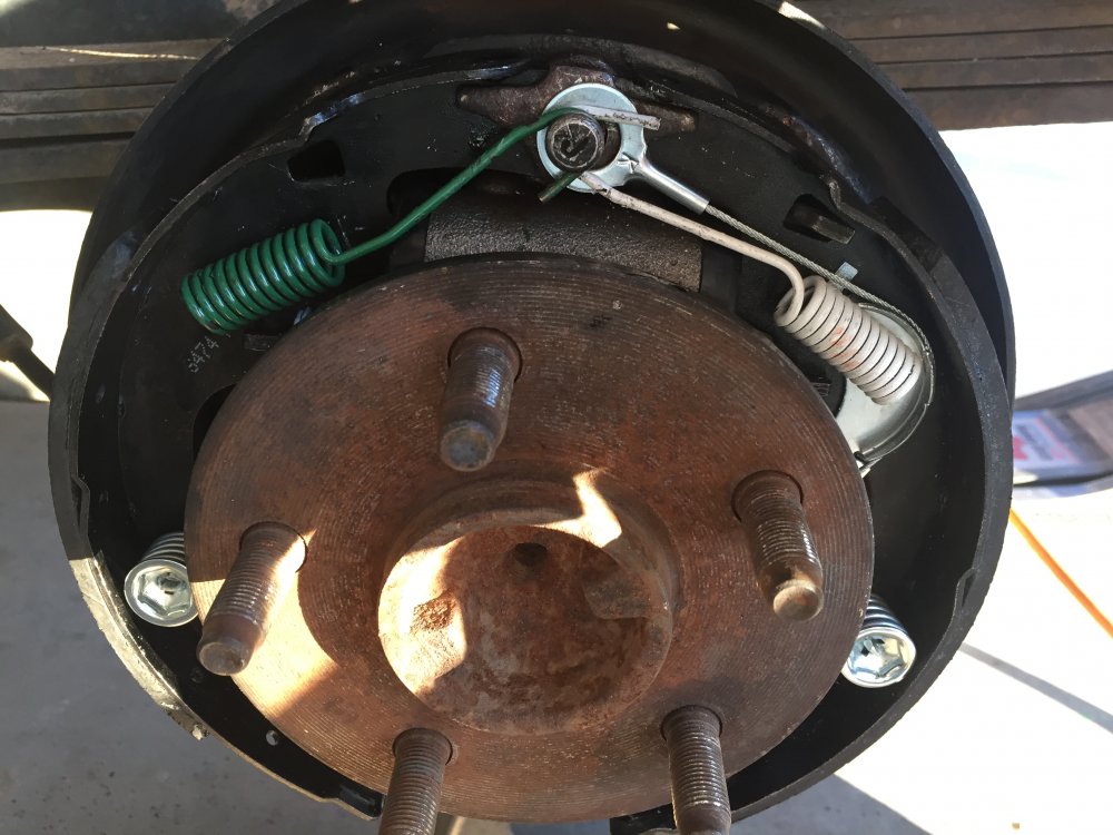

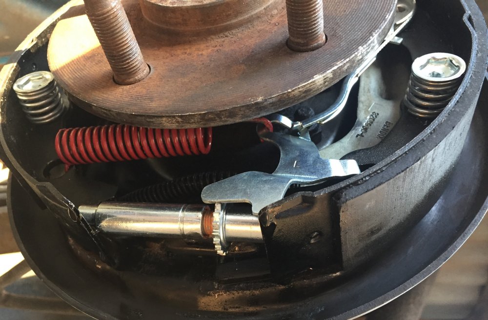

1) I was surprised and disappointed when pulling off the drums to find that some of the interior parts were incorrectly placed or the wrong size. For instance, the adjuster cables on both sides were too long and just hanging freely in there. I was able to confirm at the auto parts store that they were in fact the 10" size adjuster cables, even though I definitely have the 9" brakes. Since I was unable to follow what was already in there (one side had the pads switched too), I had to do my best with diagrams online and the Haynes manual that I have, whose pictures must be for a slightly different model. Since there are 3 sets of 2 springs (3 colors), am I correct that one spring of each color goes on each side? Can anyone confirm that I have attached them correctly? (see picture)

1) Yes, the spring colors correspond to their position in the assembly, and so one of each color goes on each side. Long thin shoe goes in the rear, short thick shoe goes to the front, if you do that wrong the adjuster assembly WILL fall apart the first time you set the parking brake, or once the shoes wear enough to actuate the self-adjusting mechanism. I have many many test runs of that particular incorrect assembly and that exact failure to be very sure I am correct about that part. It does however appear that you have everything together correctly.
