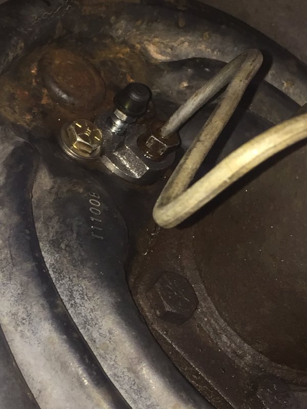

I'm a jerk. Since you had a 10 inch parking cable... And the things look alike...
Could it have just been a wheel cylinder link?
I've never popped a piston out unless stuff was shot. And fluid gushes, etc. That wont seal up tight just pushed in.
If they did come out the cylinder is 13 bucks. Just do it.
I wore the shoes down so far on my colorado i had the piston popped outta the cylinder, causing a no brake condition.
Good thing i had a 5 speed.
Either way, when i did the brakes i just jammed the piston in and kept on truckin.

AutoZone the 9" wheel cylinder part #33904 is $13.99. Just had to replace mine on my 94.
Thanks everyone! I ended up getting a new one. I got everything back together and everything seems great EXCEPT...it looks like I have a small leak from the brake line fitting. Did I over-tighten it? I didn't crank on it, but did get it pretty tight. Or could it be corrosion? If I replace the line/fitting, do I need to replace the cylinder (again)?
Sometimes you have to crank down on them more than what seems necessary, but use your judgement. Dirt/rust/etc on those fittings can make them seem tight when they're not. You're also compressing a steel brake line against an iron surface so it takes some pressure to make that seal completely.
If it still leaks after tightening it again, I'd pull the line and make sure there isn't a burr on the flare or that it's not bent/distorted and same with the inside of the wheel cylinder.
Just curious, the wheel cylinder that you popped the piston out of - was it new? Looks pretty shiny in your first picture. I probably woulda reused it if so...
