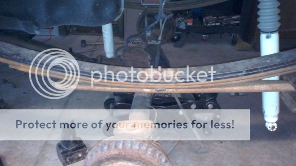

Got the springs back together, I took the old ranger springs apart and used the lower two leafs plus the overload. Hope it wont make it to stiff but I had to fix it and this way was cheap. The ranger leafs are the ones not painted black.
Going to do the samething to the other side?
Glad to see you were able to fix it.
Yeah I did the same to the other side. They are now identical and is sitting back on all fours again.
i like to add the b2 springs as they are thinner and make tuning ride a snap, just hard to find them that arent beat to death in the junkyard..

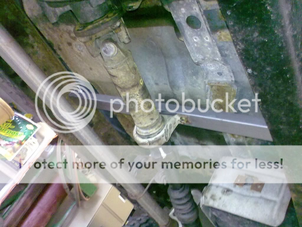

Got the truck drivable again. Here is what I did to stop the two piece driveshaft from vibrating...
I made a new crossmember that the bearing mounts to. This way I was able to make it as straight as possible, no more vibrations:headbang:

You should get a one piece driveshaft so you can elimnate that two piece shaft, tech. library has more info. on that.
yeah one piece would be nice, but this only cost me $10 in steel. and doesn't vibrate now.

excellent idea, though i think it will be short lived...you just put it in a bind so it cant flop as much.
i hated my 2 piece shaft cause of the wobs, but the one piece is more vulnerable wheelin....so build accordingly. making a longer intermediate and shorter rear section is actually ideal:icon_confused:
but costly.
my whole build is low budget, so this driveshaft setup will work for me.
