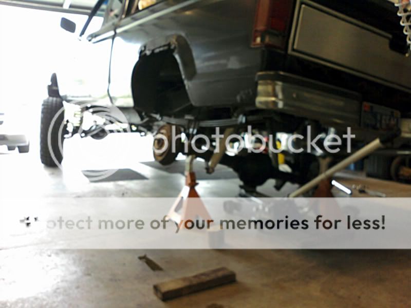

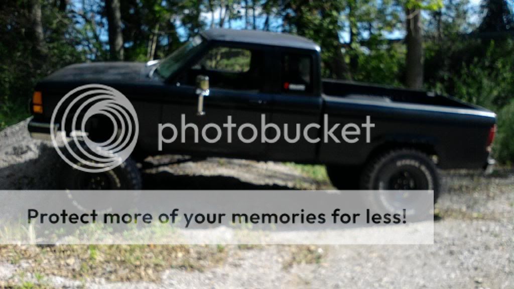

I changed the rear lift blocks a couple days ago and took a few pictures of what little flexing I could get with a jack and stand.
Sorry for the blurry cell phone pic

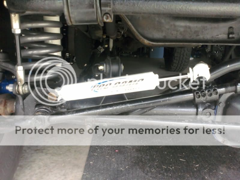

I replaced the steering stabilizer today that I got when I was at 4Wheel Parts store in Indy. Hope it works better than the stock one I've been using.

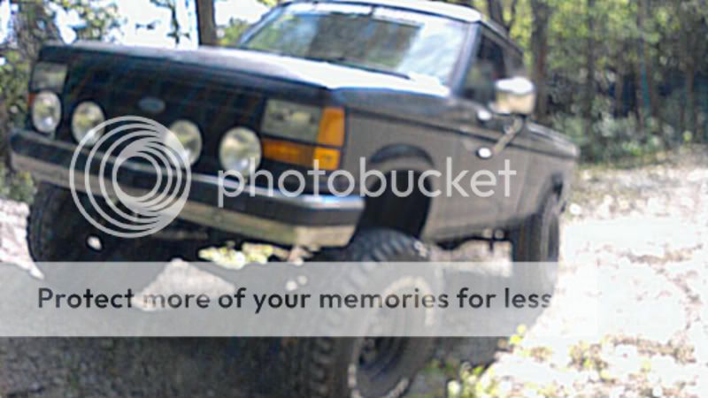

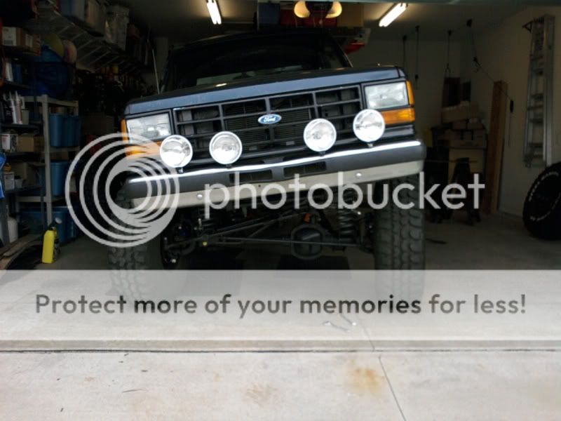

Did you put new fog lights on or was I not paying attention again?
Yeah I added another set of Hella's that I had laying around the garage for a few months.
The new steering stabilizer works much better. Should of changed that during the swap.

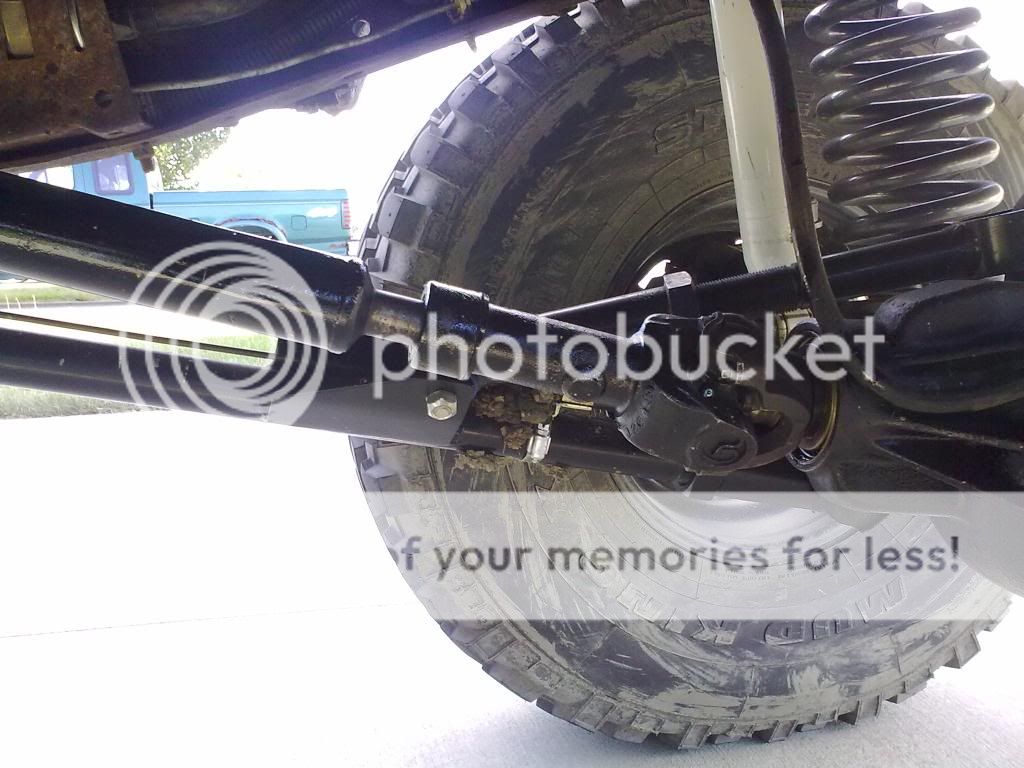

I got the front drishaft done today had to shorten it by 3 inches. And took it for a drive to a local spot I been eyeing to check out.
Here is the driveshaft. Forgot to take a pic of it till after I took it for a drive.

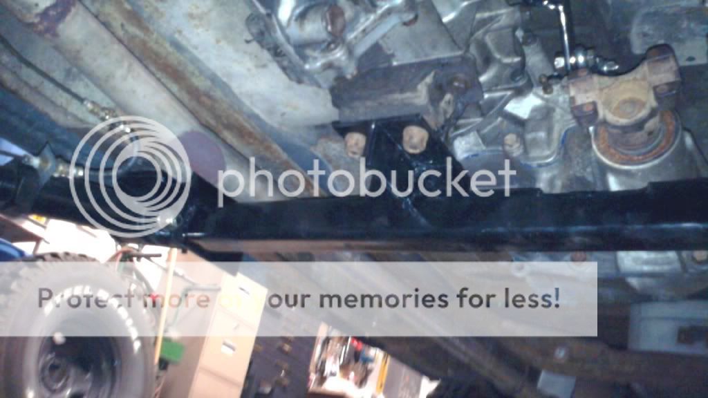

I had to make a new transmission crossmember...

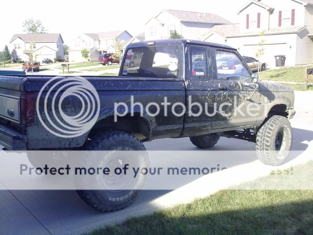

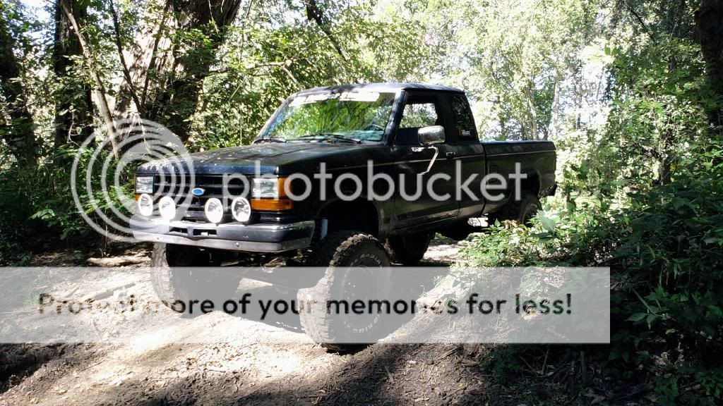

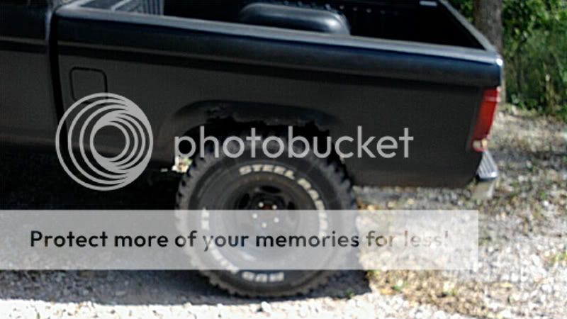

Here is some shots of testing... (sorry for the blurry cell phone pics)

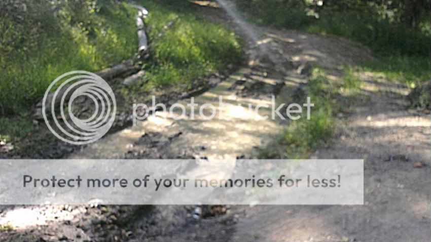

Here is a water hole I went through. Tire was about 3/4 in the mud.
My 11 year old son took the pics and a small video.

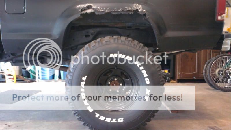

One thing that is still fuzzy to me is the brakes lines and how they are ran. I guess either Im thinking about it all wrong or I havent been puting as much thought into it as I should or Im over thinking them. Do you remember what vehicle the short rubber brake line that you used (where the long arms connect to the frame, picture number 2) are from?
Did you have to end up using a drop pitman arm or use the factory one, from the looks of the pictures, its not factory?
