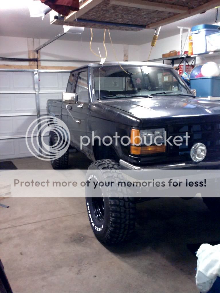

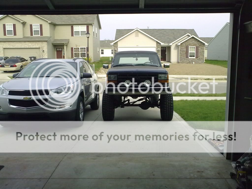

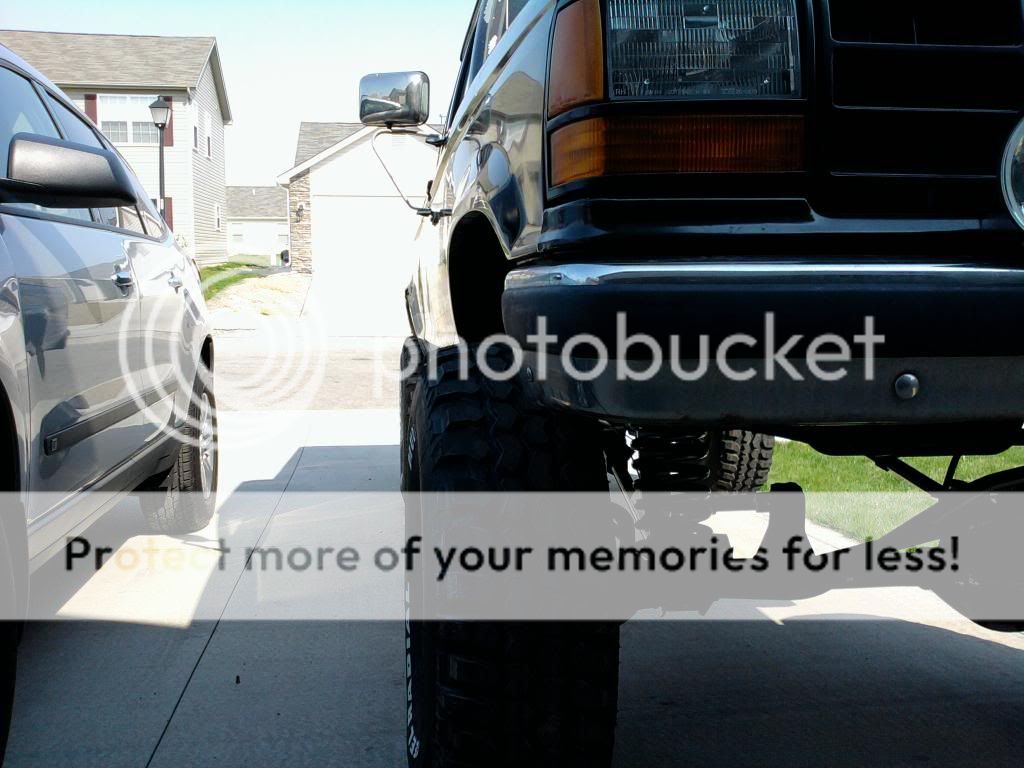

Almost done with the swap. Here is a pic of it after i moved it out of the garage to clean the floor and get the lawnmower out to start mowing for the year.
I have to bleed the brakes, order rear shocks, tighten up misc bolts, put the bed back on and align the toe and trackbar.
Had some issues with installing the 63" leafs. Had to replace the leaf bushings and ordered them from Rockauto.com. Got them for $4.26 for a box of 2. My front driveshaft wont work. I will have to make one myself or something.
Will be driving it soon. Can't wait.:headbang:

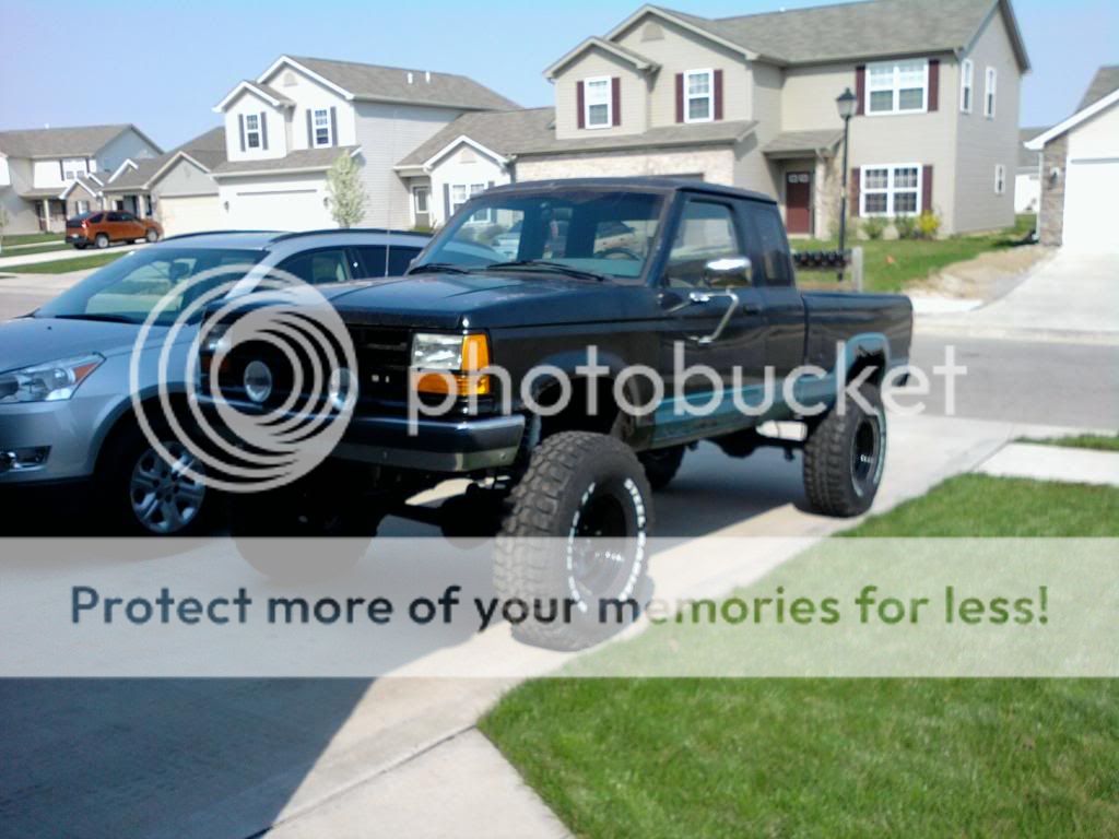

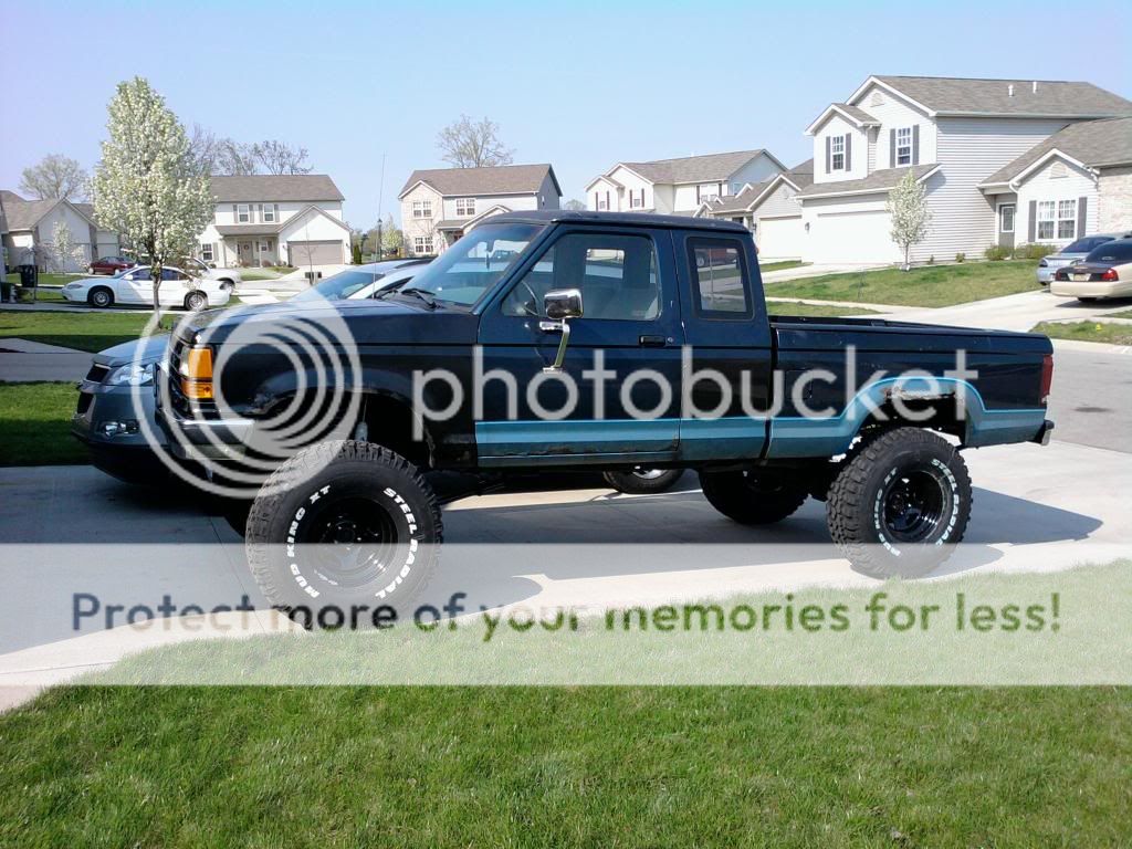

Drove the truck around the addition. Needs rear shocks still but I was surprised that it drove very nice with the toe being way off still. Shocks should be here tomorrow. I got Rancho's for the rear. Here some more finished pics.

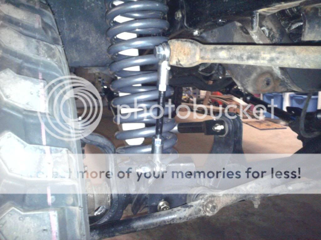

Had a few bolts that worked their way loose, no biggie. I used lock washers on the link bracket. I think i will replace them with nylon lock nuts.

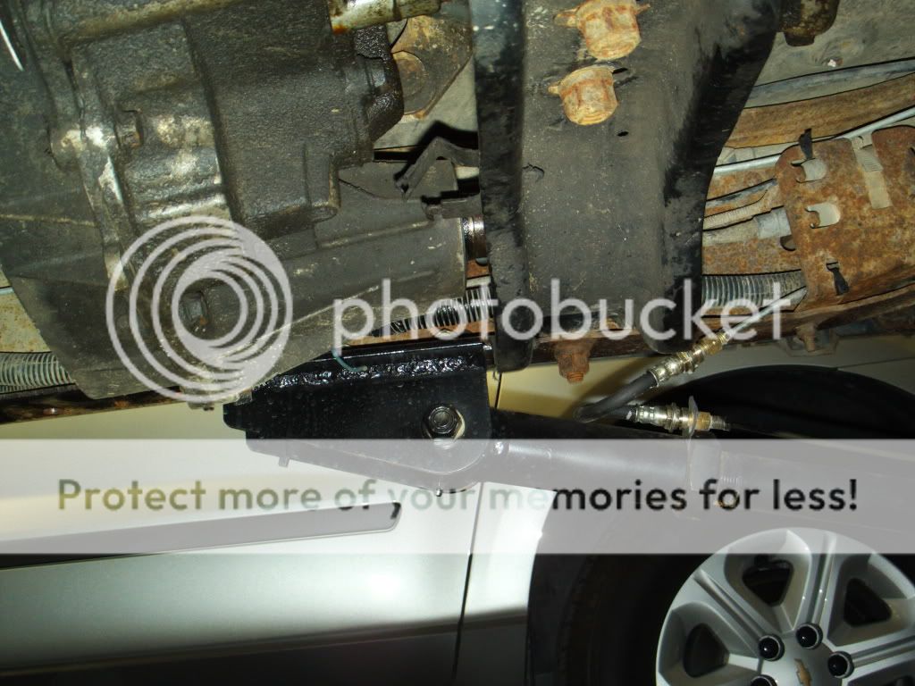

I just left the factory crossmember in place for now. Later I want to swap trans and might look into custom fabricating one. I will post a pic of that area soon.

Here is a pic of the link brackets and the trans crossmember. The crossmember is the between the frame type out of a 84 B2. I used this one because the trans and case came out of the B2.
