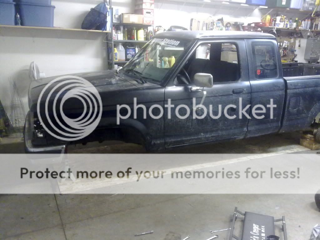

This is the last picture of the truck. It will be gone in the morning.
