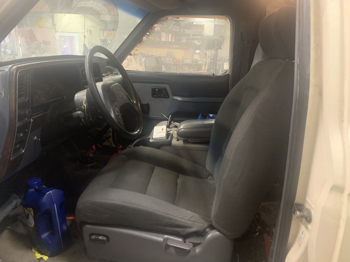

I pulled the seat out of my 01 parts explorer. The drivers side is powered. Still have to mod the front mounts. The rear mounts bolt right up. Front mounts at least one of them are way off. Not to extreme. Going to run power from one of the relays, that I'm not using anymore. or Ill just add one, well see I need to clean up the i wiring in that area anyways. no big deal. It is pretty cool to have a powered seat! The other side is manual. Wish I had heated seats, that would be even cooler but olwell. This is way better than the old seats.

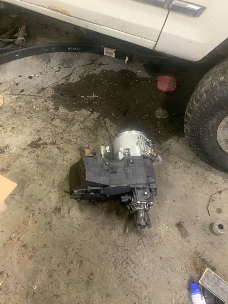

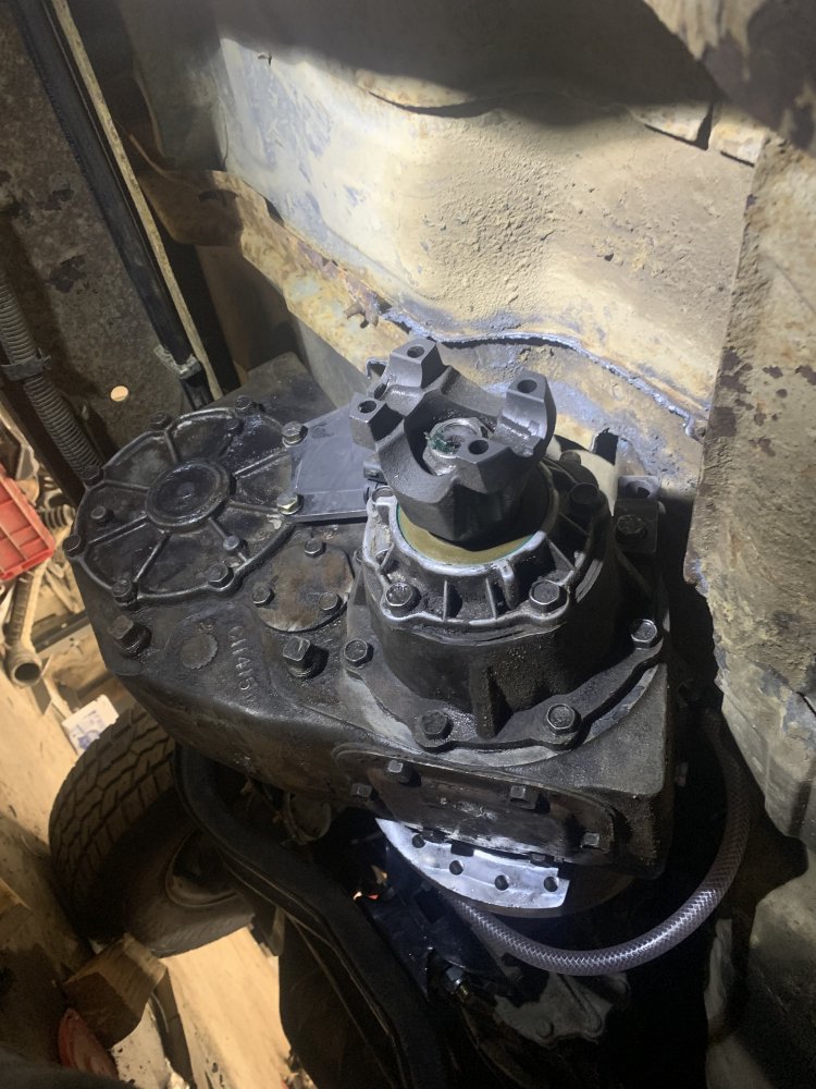

Man that was not fun… but it’s in. Had to trim some of the body frame supports. I’ll have to build a new x member which I had knew I was going to have to do anyways. This 205 is just heavy and with the crawl box it’s even worse lol good news, front drive line will bolt right up. Rear driveline is going to be shorter lol I was hoping to not need the Astro van speedo cable but between the body lift and around 4.5 inches longer I’m gonna need to install it. It’s coming along!

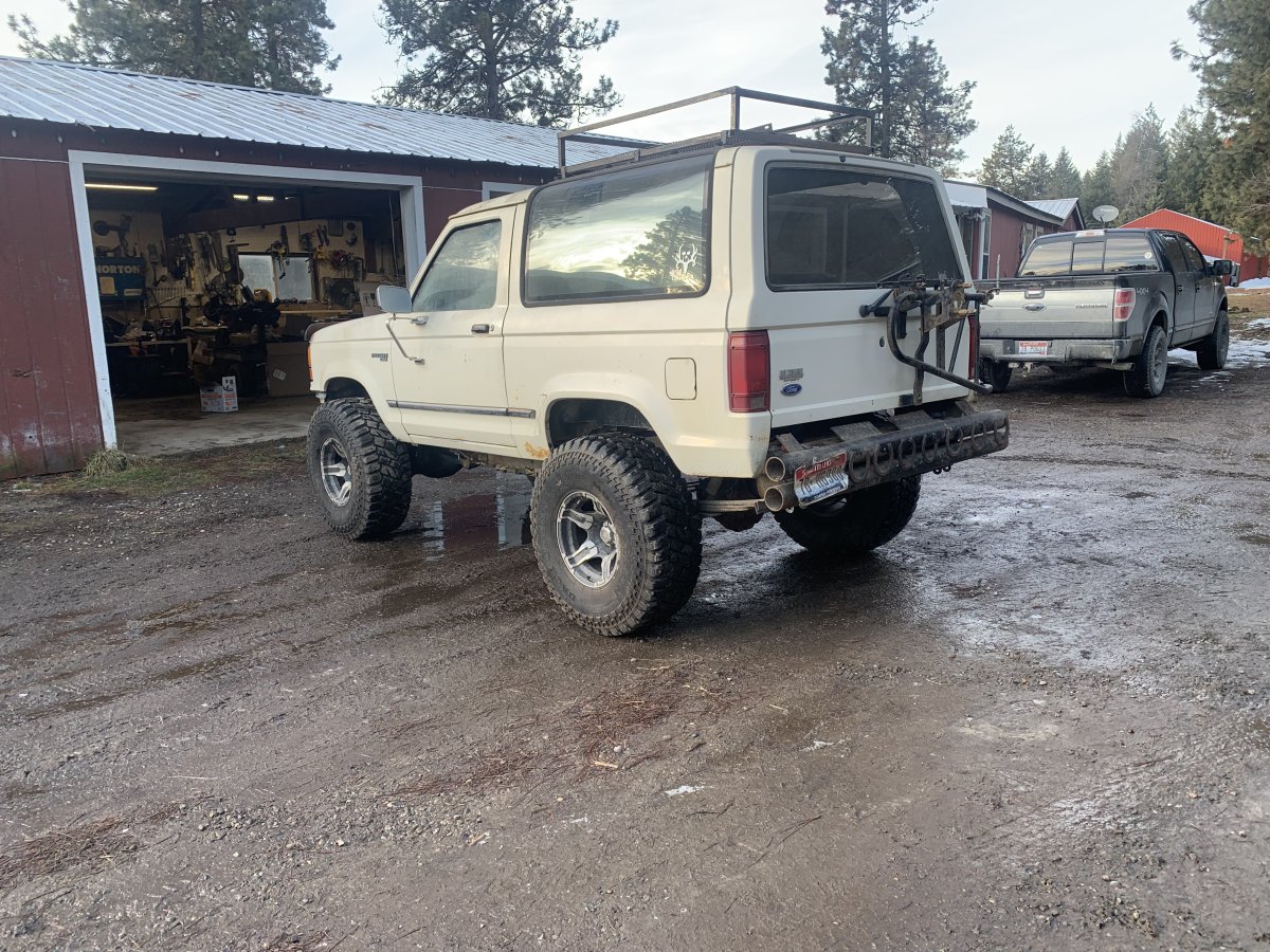

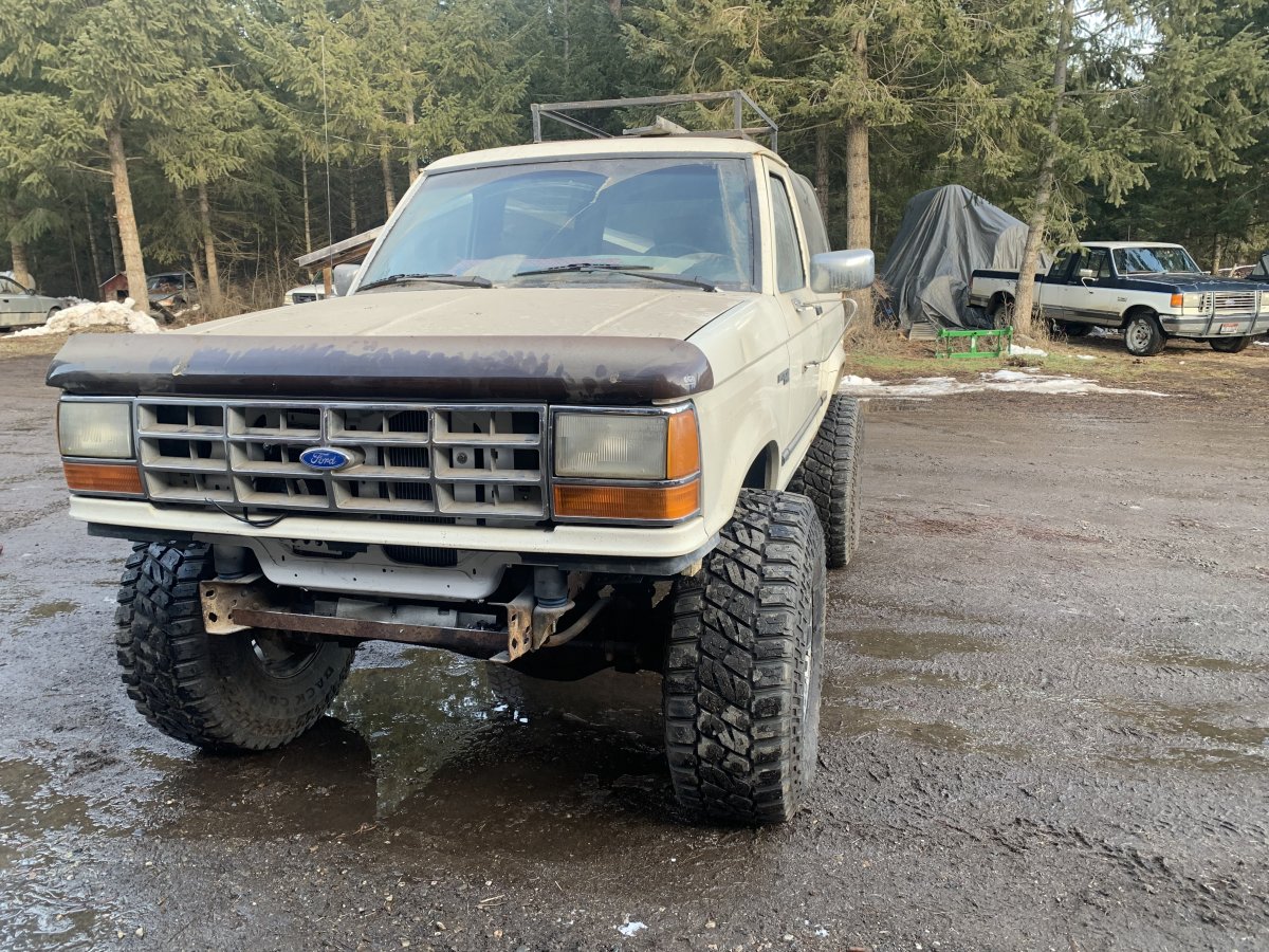

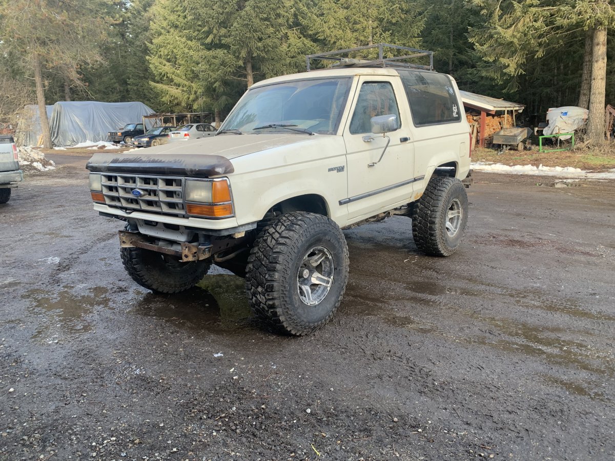

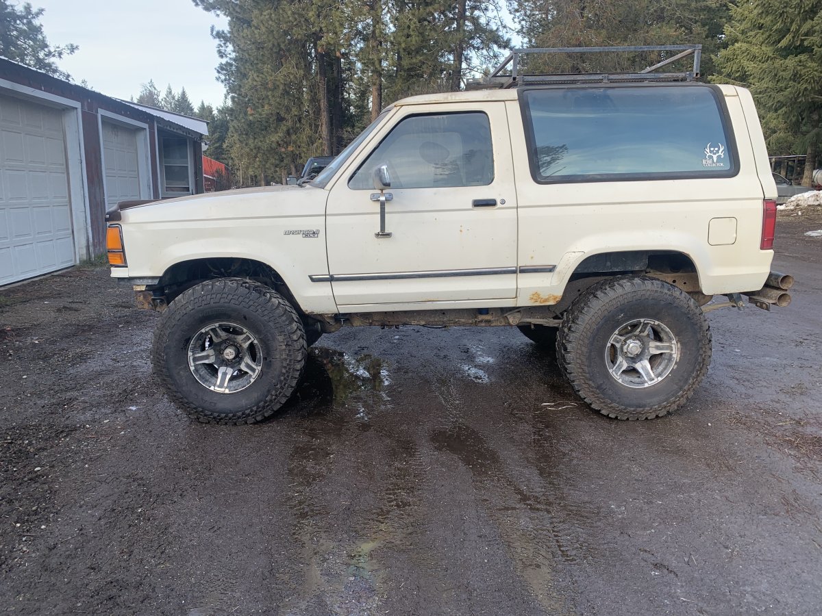

Well flushed oil in the transmission, filled the crawl box and the 205. Swapped out the 31s for my 35s.

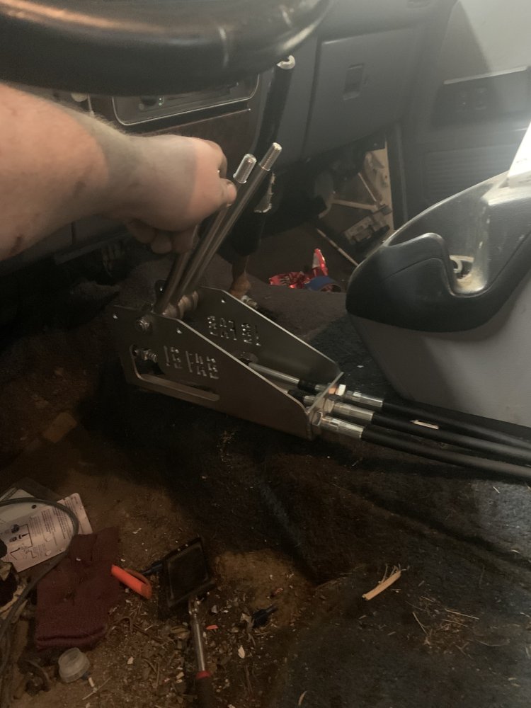

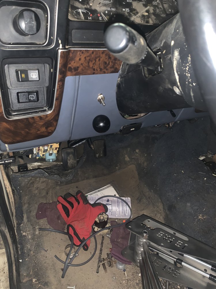

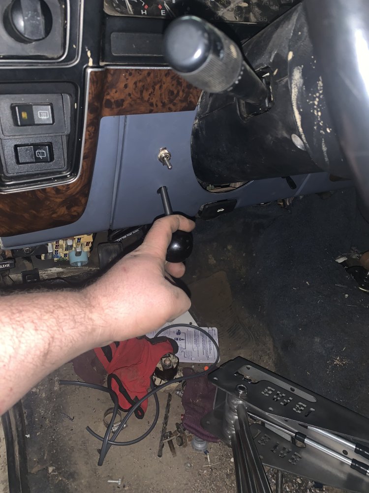

Started my mock up of my shifters. I’m hoping I have enough cable. I ordered the next longer ones. We’ll see I guess.

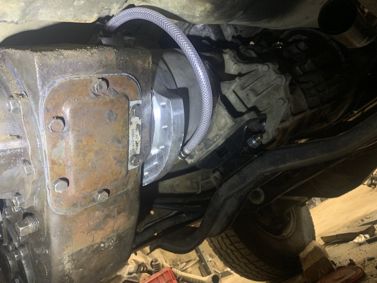

Got my shut off cylinder in. I just pull on it and it pulls a vacuum on the shut off valve and it turns off. Not to bad!

looks like if you put the radiator up to about a half inch from the grill, you can run the mechanical fan.
I should of took a picture with the E fan in, I wish i had enough room. I'm max'd out. The electric fan will just have to do for now.
i am referring to the plastic grille. cut that metal out of the way and mount the radiator farther forward. i have a bigger engine and monster radiator with a gen 1 that has less room. that engine will make heat if you load it down.
