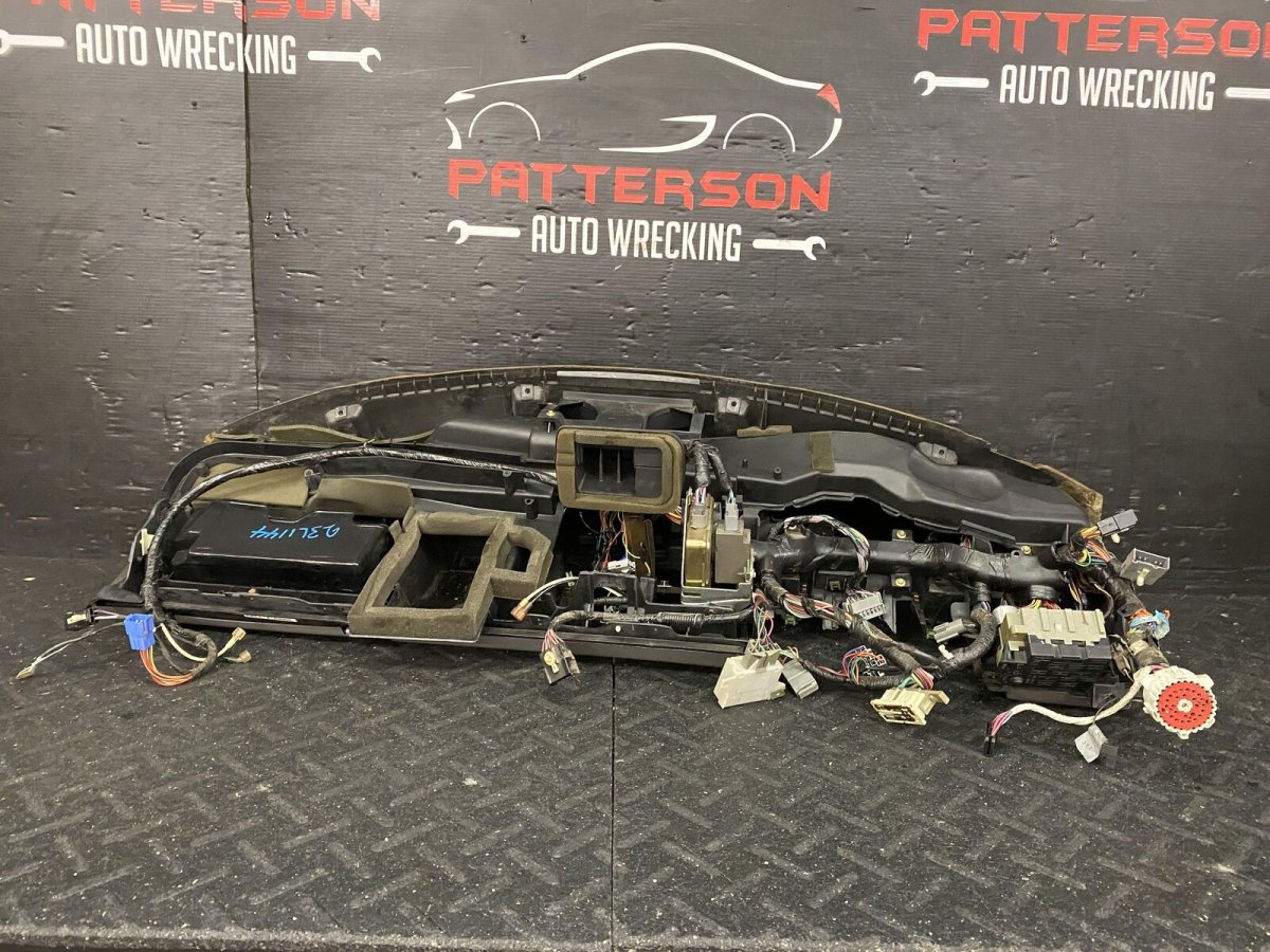

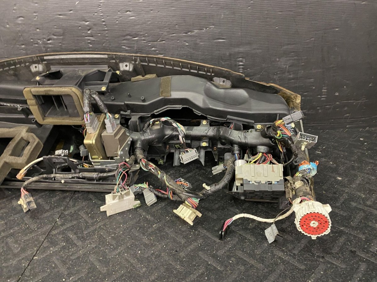

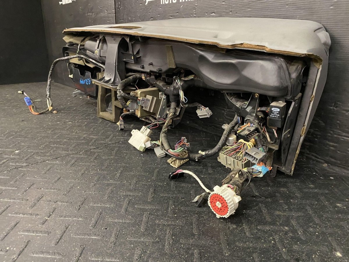

Here are pictures of a 92 dash I found for reference, it looks like alot of work.

I replaced the dash in my 93. It wasn’t a bad project. I removed the dash and left the wiring in place. Pictures in my build thread. I’ll try to put a link here when I get a chance.
I would put in another 89-94 dash, no 95+ dash.
You left the harness in the truck? It’s SO much faster to pull it as an assembly and remove it from the dash when it’s sitting on the tailgate.
Dash removal on 89-94's is like a 20 minute deal if you know where all the fasteners are. And I agree, leave the wiring attached and then remove it once it's out of the truck.
I didn't know where all the fasteners were. It still didn't seem like a bad job.
