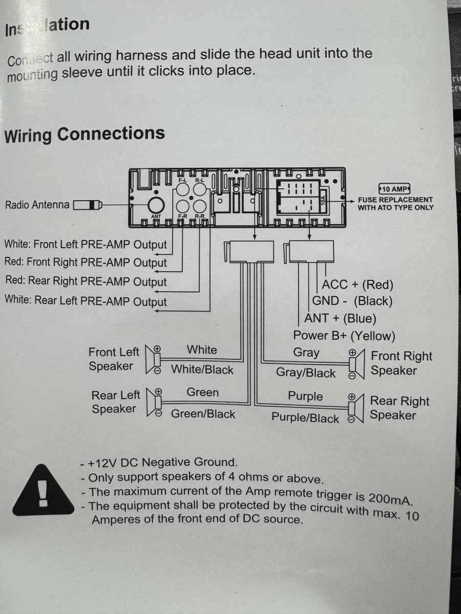

So the radio I bought (a cheap Boss Audio with bluetooth and USB) on the Power harness has a red 12v acc, a black Ground, a yellow it calls power b (Im guessing they are referring it to be a 12v switched circuit ?) and then a blue for power antenna.
Thats why I was thinking i cur and cap the blue/red ilumination wire as the new one doesnt have that one. unless maybe the acc red is actually 12v switched and the yellow power b is the illumination?

ACC is accessory in wiring lingo, and that would be switched (and match with the truck harness "hot in ACC or Run" pin 3, Y/BK).
Shit, I forgot to post the pic of the boss audio schematic! Doh!!!!
I see a smoke show coming
red 12v acc = 12v switched
yellow it calls power b = battery/constant power

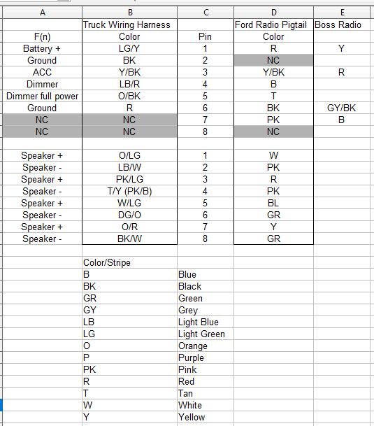

The spoon fed version - I read your manual and made a cross reference page, took me a few minutes:
88 xlt radio help
Edit: gridlines did not come through - redid spreadsheet, fixed "grouund"
someone double check my insanity before he hooks it up... I see I misspelled grouund already...
I did not go to the effort to do all the speakers, cause that would have taken me twice as long and you said you had it figured out already.
all wires that have a "NC" are Not Connected, and any wire that I have left no cross to is either A) not connected or B) referenced on another page of your manual that I have not seen.
That did it; go stand in the corner!
On your Boss wiring sheet, go with Boss Red to truck Yellow/Black; Boss Yellow to truck Lt Green/Yellow (as @2011Supercab called it, too).
