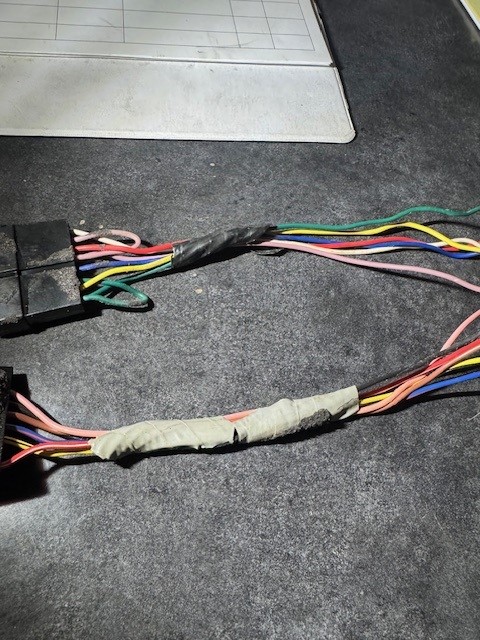

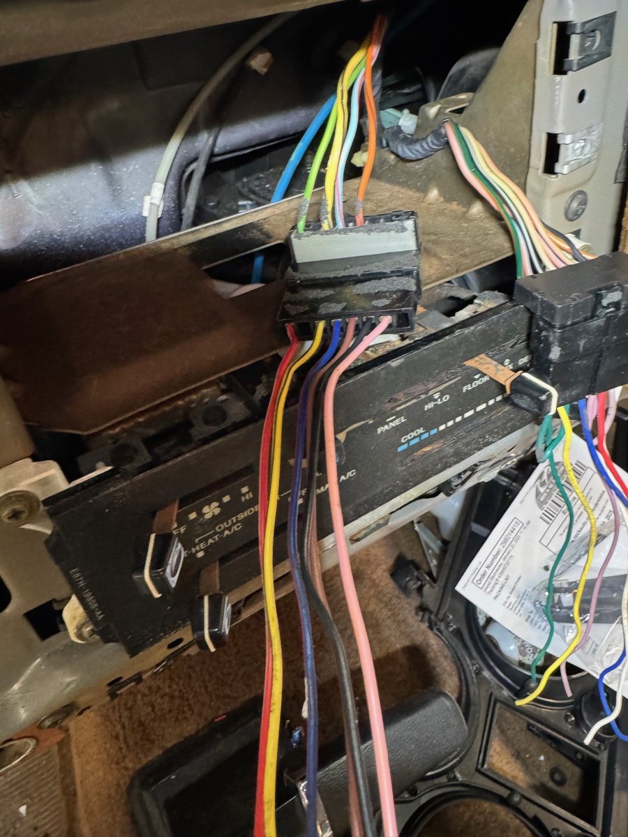

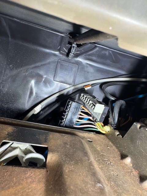

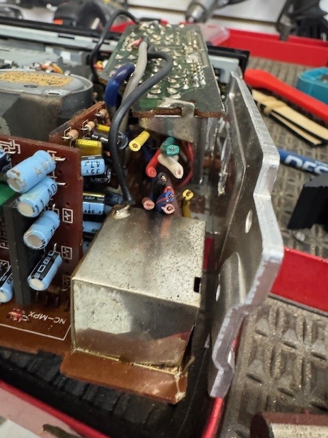

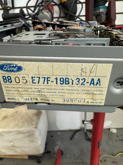

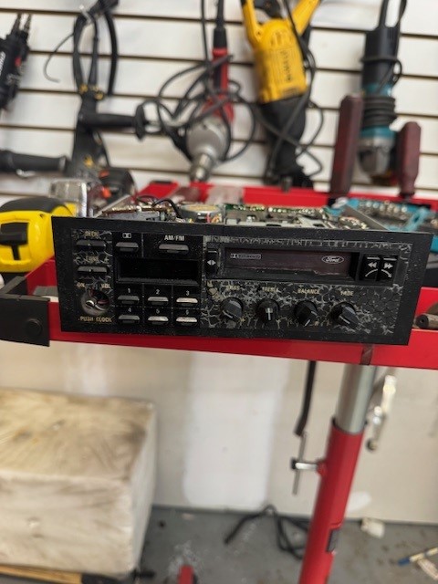

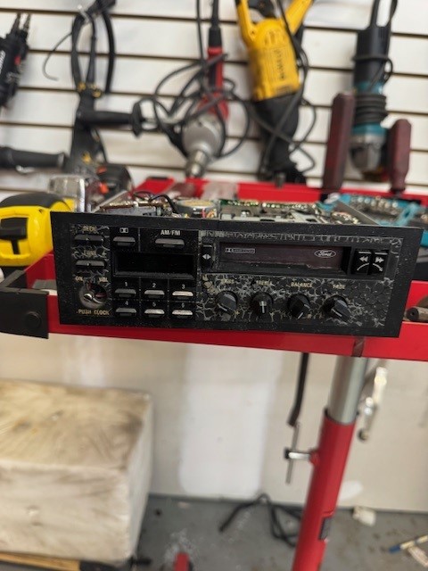

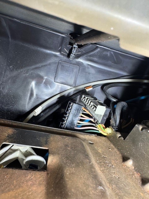

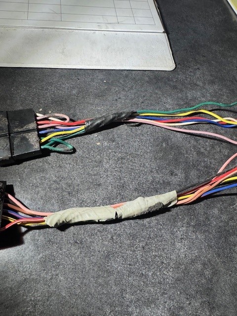

here are some pics I took of the radio I removed yesterday. first is the face. second the part number on the side sticker. third is where I cut them from inside the radio since it was hard wired in from the factory. And the last 2 are the body harness with the clips mine plugged into and then the foam wrapping. I could be wrong about it being factory, but I have been in the auto industry for over 25 years and everything I see makes me believe its factory parts. Let me know your thoughts. thanks.
also I'm thinking since I have 6 speakers its the premium system and that's why things look so different?

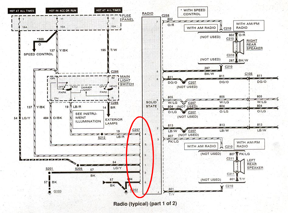

These wires are the ones that should match the wiring diagrams

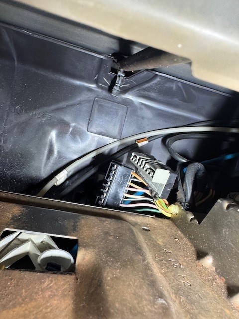

Yea I guess Im gonna have to plug these harnesses back in and then see what colors are plugged into the other side of the body harness to track things. Or just run all new wiring for the radio, but I would prefer not to do that. Im just installing a little digital boss audio radio with bluetooth and new speakers so my son will have a decent stockish sounding radio that works. the stock one had a screen that stopped lighting up and when you turned any of the knobs it would be loud static that sometime would or wouldnt go away depending on the day

Thank you for the pictures. Please give me a few to look them over real good.
One comment right away, is that 6 speakers is not from the factory, even with Premium Sound. If memory serves, Rangers with Premium Sound that vintage would have an added "Premium Sound" emblem, on the instrument panel trim piece. Premium Sound added an amplifier, for the rear speakers only, and in first generation trucks it would be mounted high in the center of the dash, below the metal plate next to the windshield.
Does your truck have speakers in the doors?
I'll add some more here after I look over the pics.
<edit> added comments and images
That certainly looks like a factory Ford radio. What is unusual, is the wiring colors of the pigtails that you cut from the radio. I'm used to seeing the normal Ford speaker wiring colors, on the older radios with pigtails. Another thing, is I'd have to dig through my stash, but it seems that Ford radios had "Philco" on them somewhere, like on the paper labels. Can't rule out, though, that Ford at times outsourcing some of the radios from third-party suppliers, which would then make sense on the wire colors.

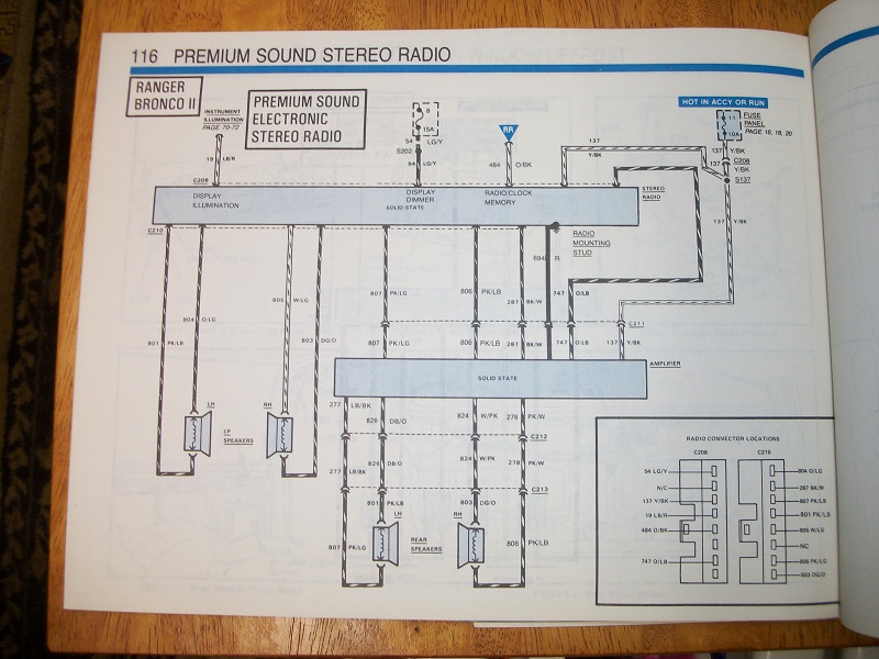

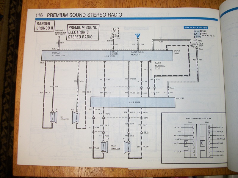

I'm including a wiring diagram for the Premium Sound unit for '88. The plug pin-outs should be all that you need, to wire in the new stereo. I'm sure that your plan, is to use the salvaged pigtails to make an adapter harness for the new radio to the truck's power and speaker plugs. The wire colors on those plugs should match the colors on the schematic.
1988 EVTM pages attached:

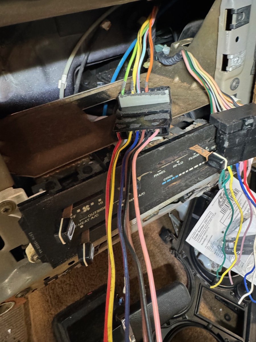

So I have the speaker side figured out now. I do have a couple questions on the power harness now that we have determined I DO NOT have a premium stereo. So i am gathering the Green/yellow is constant hot and yellow/black is switched power and blue/red is illumination which I believe I wont need since its a new digital head unit? but what about orange/black? is that ground?
and also what about the black and pink at the bottom harness pic? Cut and cap them? just like i plan on doing with the illumination wire?

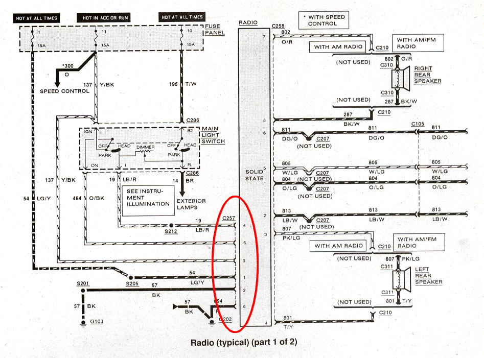

not being an ass, but in post #2 I gave you all that info:
here it is again with a big red highlight.
88 xlt radio help
1 is LG/Y
2 is BK
etc etc
1 is LG/Y
2 is BK
etc etc

"blue/red is illumination which I believe I wont need since its a new digital head unit? but what about orange/black? is that ground? "
you need illumination (dimmer) unless you want your radio display full 100% brightness all the time, even when it is dark, the headlights are on and you turned the dash illumination down so that it doesn't blind you inside the truck. "Illumination" is dimmer, it is a 0-12v signal that tells the radio how bright it should be displaying the display (in practice I have found it to be 2-12v though).
No it is not ground, it is a 2nd illumination - hence my comment in #4 about ford moving around, marrying or deleting pins. some years it is there some it is not.
pins 2 & 6 are ground (black and black).
"and also what about the black and pink at the bottom harness pic? "
black (pin 6) is ground, some radios only use 2, some only use 6, I would ground both.
pink (pin 7) is not connected to the truck at all (unless you have some premium custom ordered oddball or else someone has redone the radio), I believe it is power retractable antenna, since it is not connected, do what you want with it, cap it / cut it off (makes that wiring connector plug useless for another vehicle).
