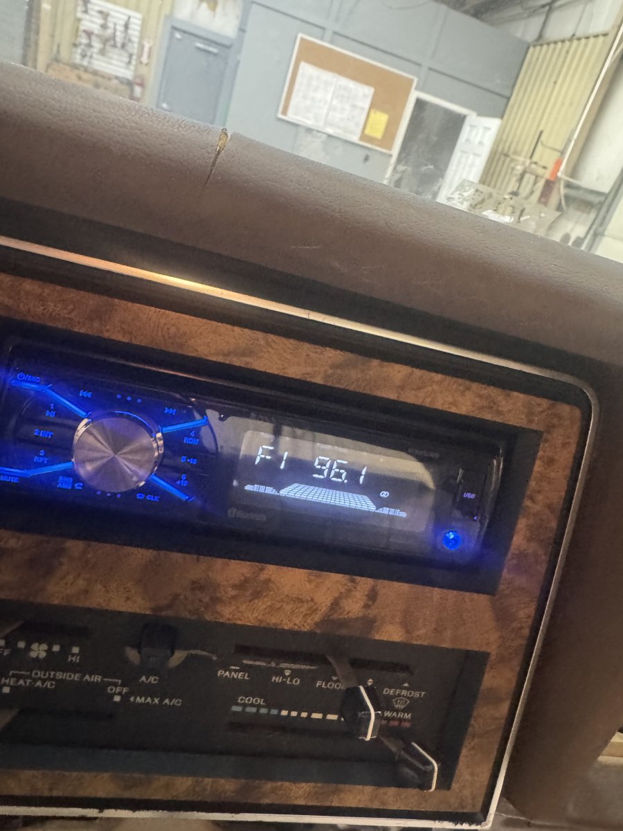

I want to thank everyone for the help. I’ll post up again possibly tomorrow but definitely by Monday.
Hopefully now vehicle fire pictures! Hahaha
thanks again everyone!!!!!
