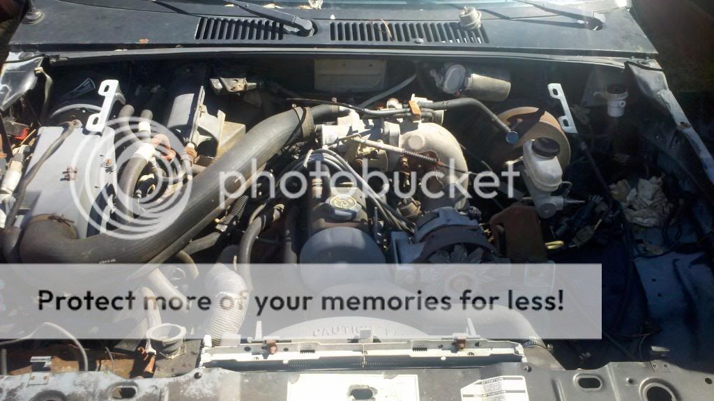

Engine bay before we started working

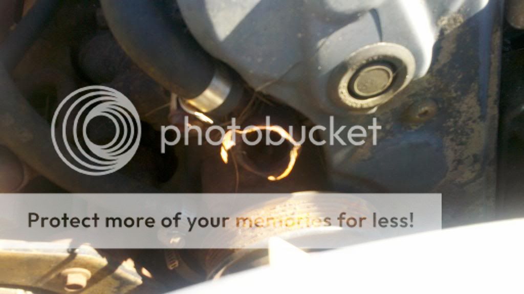

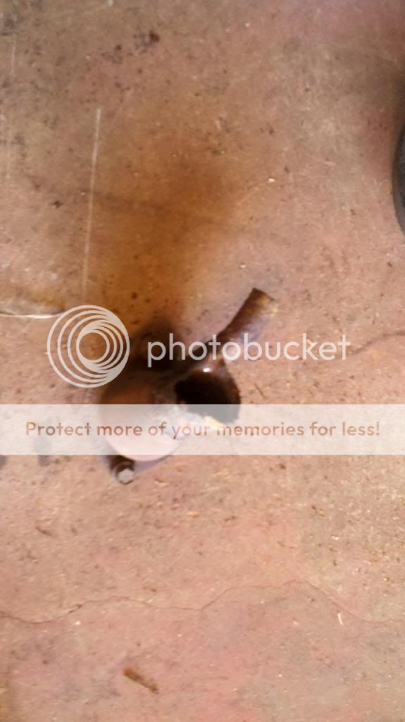

Just a slight bit of rust damage on the thermostat housing:icon_rofl:

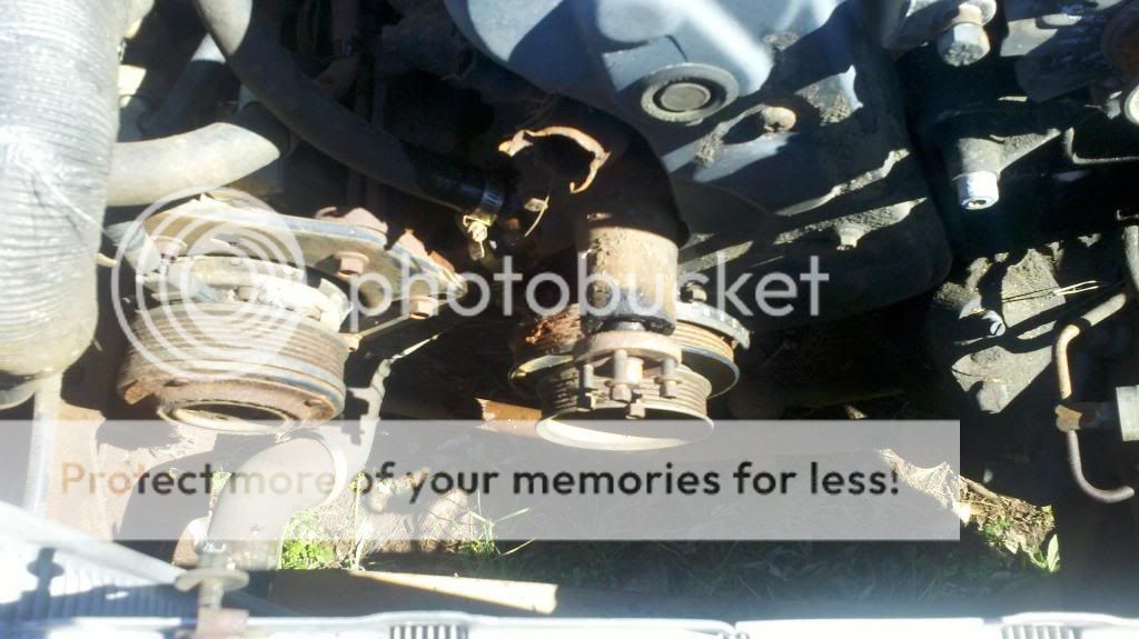

Front of motor without accessories. Note leaking water pump.

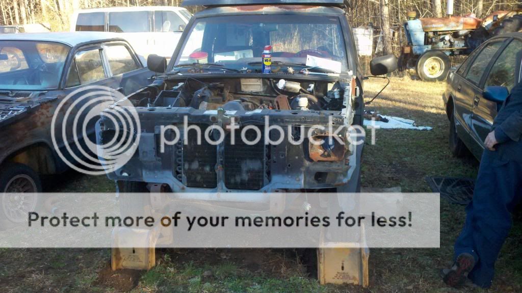

Front end in the air so we can get under it.

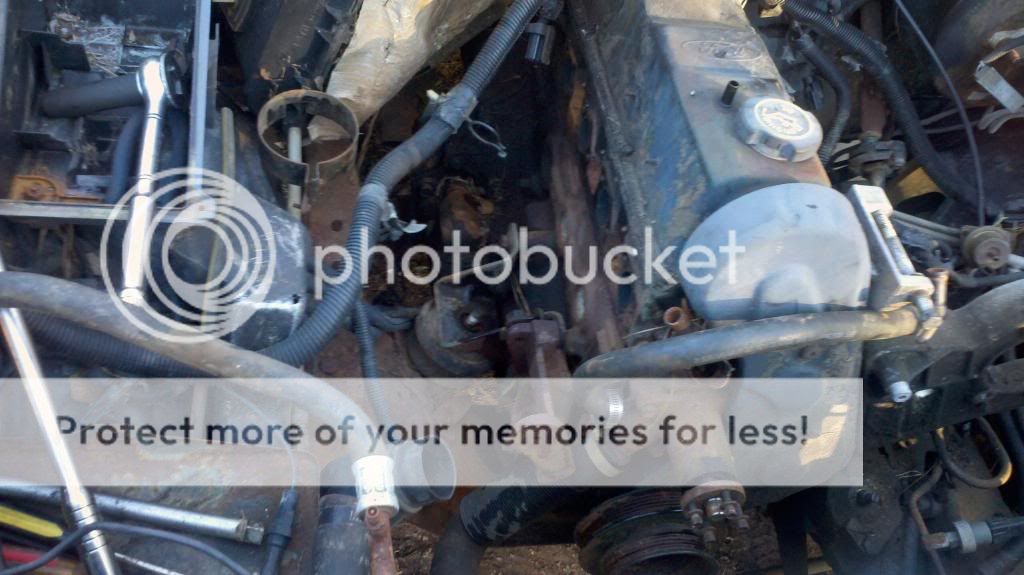

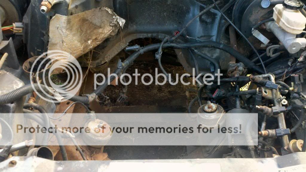

Driver's side of engine before pull.

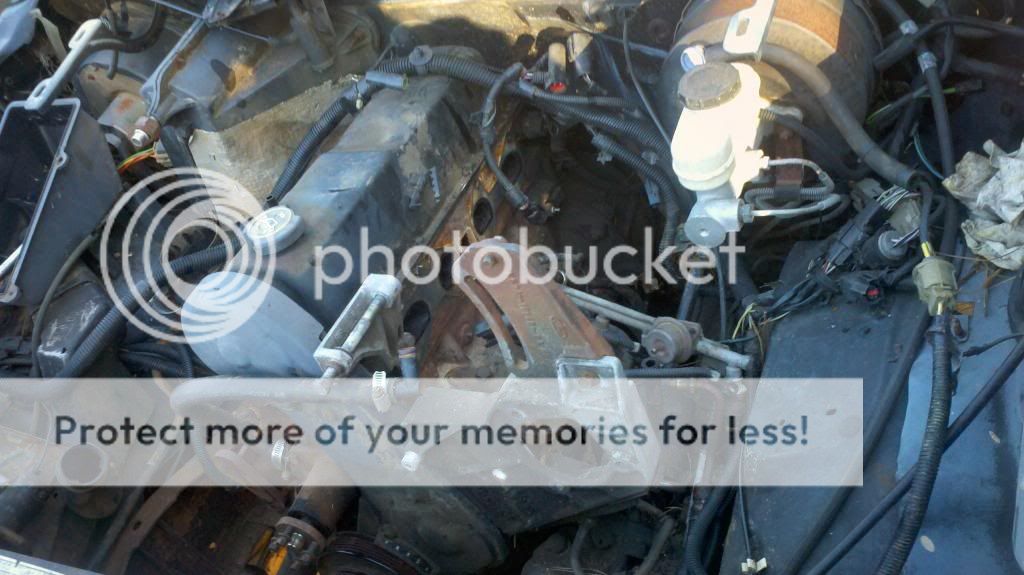

Passenger's side of engine before pull.

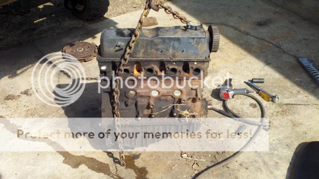

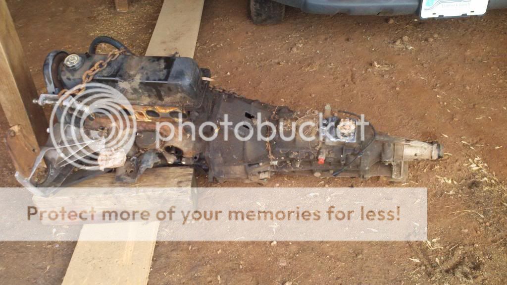

Engine and tranny in full view.
Engine free of tranny.

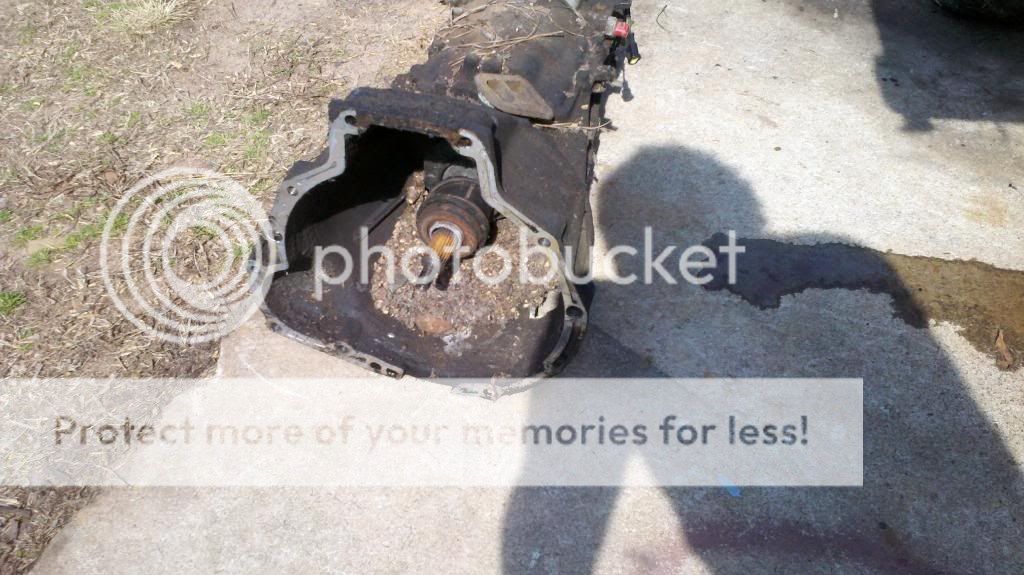

Little bit of wildlife in the bellhousing.
Another pic of the therm. housing

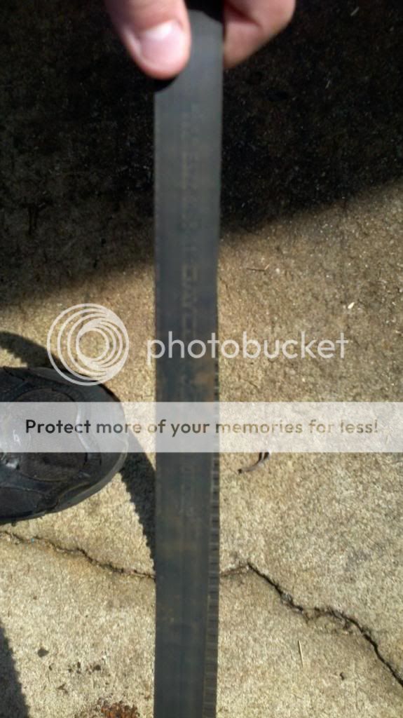

You probably can't see the date code, but I think this is the timing belt that came with the motor from the factory. It says Dayco and it has a Ford symbol on it.

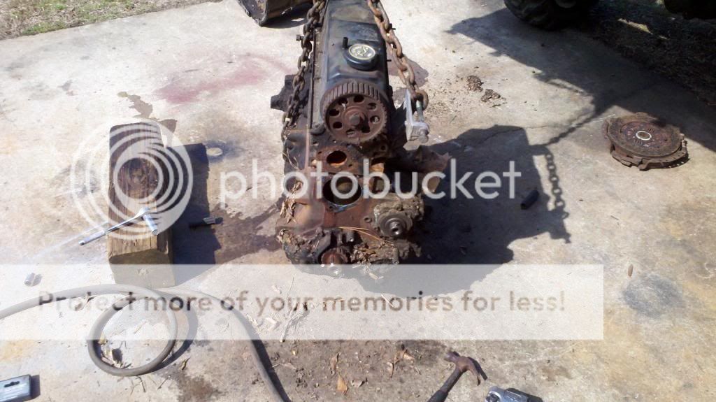

Front of the block.

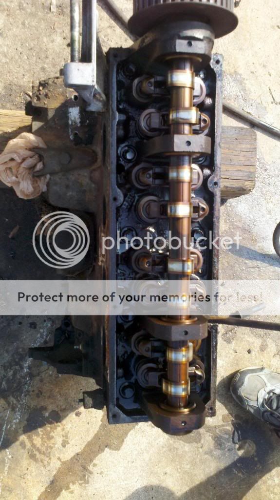

Head.

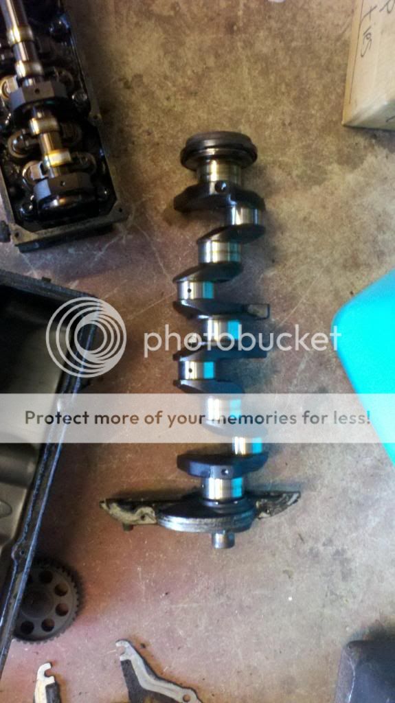

Crank.

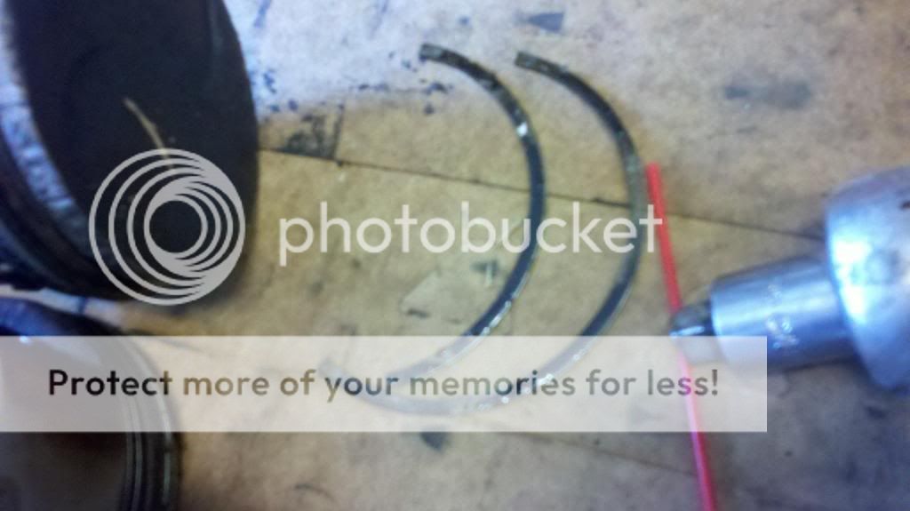

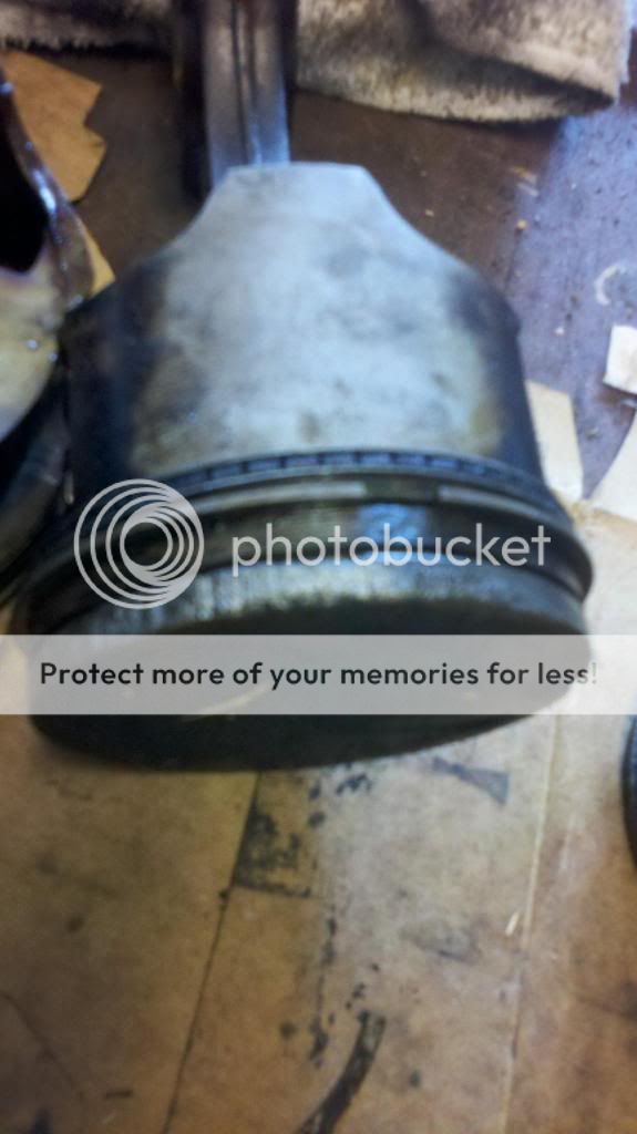

Mangled piston.
Broke ring.

Well, the damage to the block wasn't that severe, just needs to be bored to take the lip the broken ring left off. i also would prefer to keep this motor since it is the original one. And besides, I did my homework and the difference between fixing this block and getting another block from pull-a-part is only $40. And we might spend that much in gas going up there, so why bother?
