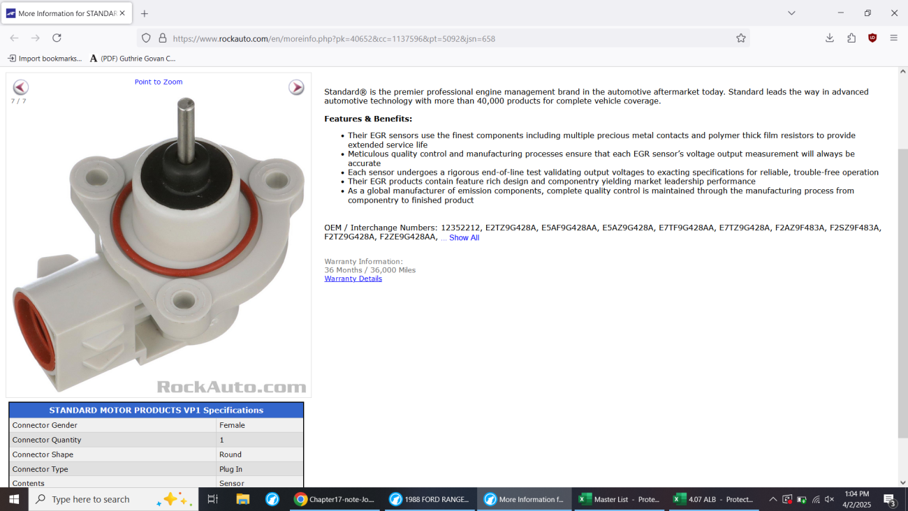

This is the sensor I changed that related to the egr, I think I saw somewhere online about a 1st gen ranger dpfe but I must've been mistaken.
