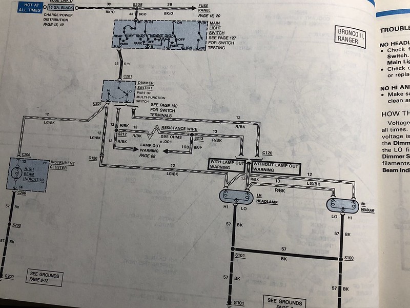

I have 1988 wiring diagram for light switch, page 1 is the one you want
Looks like both high and low beam get 12v from the same wire out of the main light switch, a red/yellow wire to Multi-function switch(aka Dimmer switch)
So if high beams work then the fusible links are OK, and the main light switch and the red/yellow wire as well
Brown wire looks to be for Park lights, exterior lamps

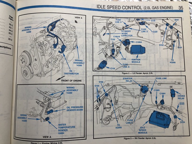

You can see the wiring sneaking along the inside of the driver side fender in figure two.
Unplug the dimmer switch and use a jumper wire between the 12volt in from main light switch(turn it on) and to the OUT to low beam wire
That is what the dimmer switch does
On the diagram it looks like red/yellow wire is IN from main light switch, and red/black wire is OUT to low beam bulbs

Yes, that's it
Electrically you are doing what the switch does, should do
Connecting R/Y to R/B
If still no low beams then wire from switch to bulbs is the issue

There's only one connector between the dimmer switch and the headlights- that's C120, on the driver fenderwell and shown in figure 2 (and in the wiring diagram). If you do have +12V on Red/Black at the dimmer switch with low beams on, then next see if you have the same voltage at C120. The splice in the wire is at the driver headlight connector, so that would be the next point to test for low beam voltage. You basically test your way down the circuit until you locate where it changes from "good" to "bad".
