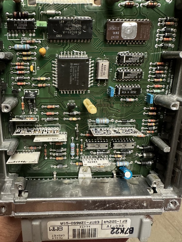

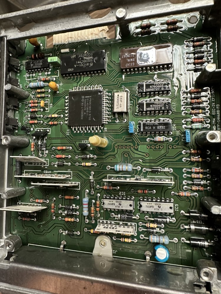

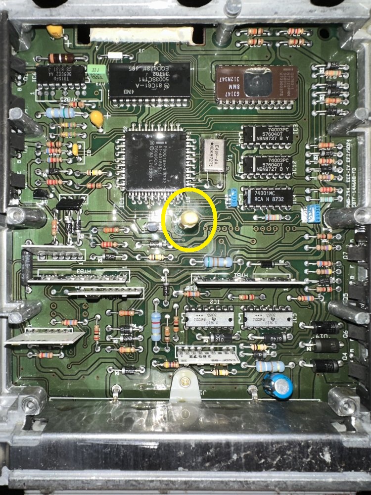

I’ve got spark so figured I start a new thread. I replaced the coil and I’m getting much stronger spark now. I can get a very small hope that it will start then never commits. I can’t find a compression tester with a small enough hose clamp that will slide through the block to meet the plug threads. Still have good fuel pressure (36 psi) and it won’t start with starting fluid. I’ve pulled ECM and it looks mint inside. Anyone see any issues in the pic? I’m going to flip the rotor 180 degrees one more time for giggles. If that doesn’t work I’m not sure where else to look.

It's hard to see in your pic, but if that's a cap that I've circled, it looks like it may have a popped top, and also looks like there's some staining at its base on the PCB.
Or, it's just the fuzziness and reflections of the pic.

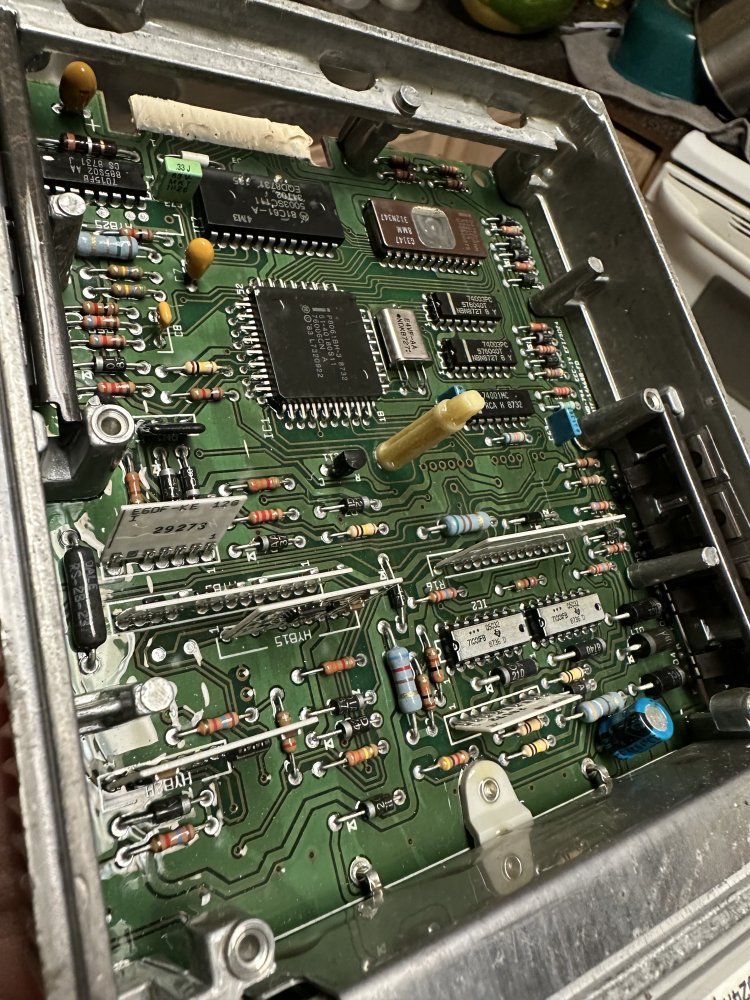

I agree with RobbieD that the one cap looks a little suspect but the glare from the flash makes it hard to see. Could you take a few pictures of the one capacitor from different angles so we may have a better look at it?

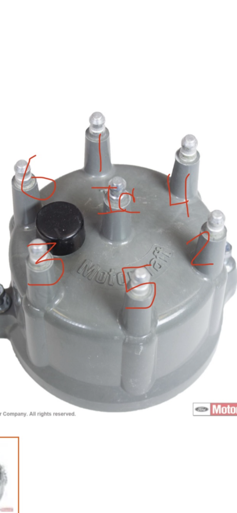

I’ve attempted to set base timing multiple times. Bring #1 to TDC on compression stroke. Pointed rotor at #1 cylinder plug wire on dizzy and firing order is shown in pic attached. I’ve also tried turning the distributor a few times .

That's not a capacitor, and I don't see anything that looks suspect in the engine control module.

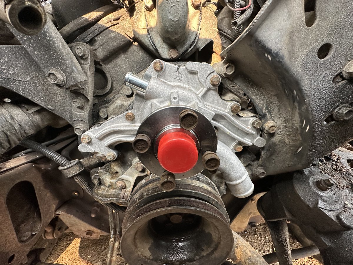

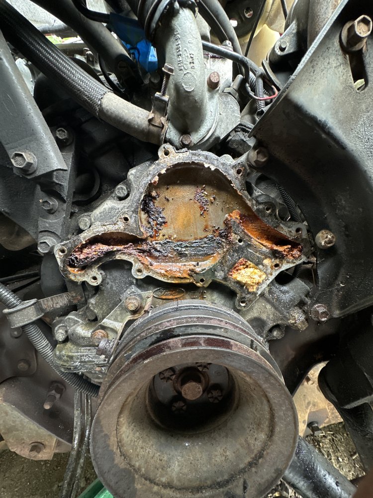

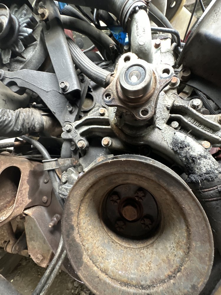

Found it to be the water pump locked up.

I bled brakes they are working now, serviced trans and changed engine oil again. I’m overheating and boiling over at the overflow tank. I used a funnel and let coolant raise up until thermostat opened. Then the coolant went down in the radiator and filled until full once cold. Both heater core and upper/lower radiator hoses are hot. Think it’s just an air bubble?
It boils over from overflow. If I turn the heat in it’s hot air and then you can hear the boiling from heater core.
