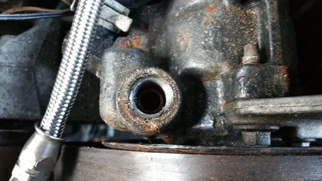

This is the top of the pump.
This is the fitting at the pump 16mm/6AN. i know the O-rings are trash but at this moment that's the least of my problems. Could the line be too small?
Any help would be appreciated!! Thank you
