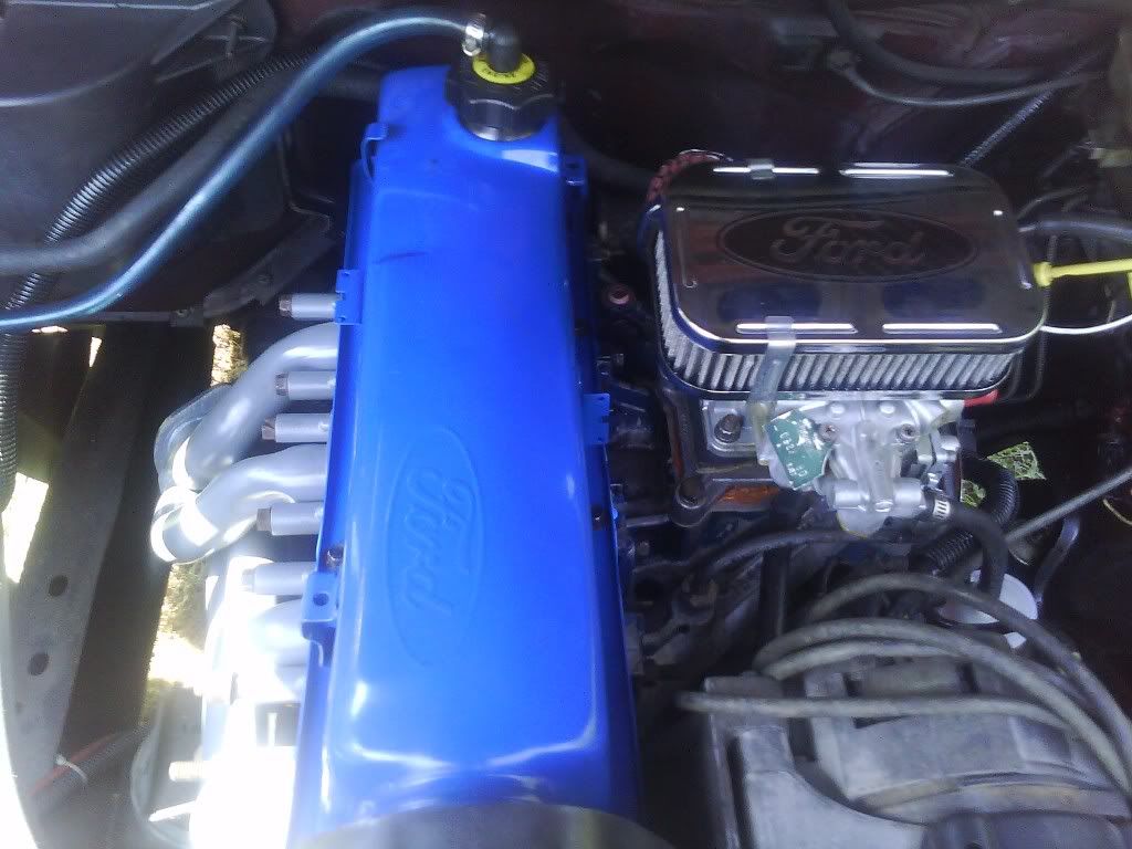

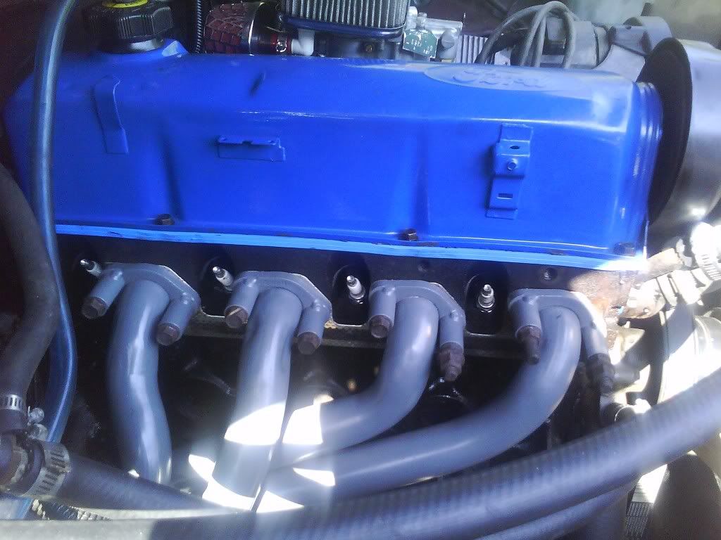

I got my header on today and tapped to 4 holes on the head. What did you use to cap the port near the bottom of the header off with? Thanks
http://i1271.photobucket.com/albums/jj626/slk9275/182-Copy.jpg
http://i1271.photobucket.com/albums/jj626/slk9275/180-Copy.jpg
http://i1271.photobucket.com/albums/jj626/slk9275/179-Copy.jpg
sorry i am just getting back to you computer was down.
anyways I took it to the muffler shop and had it welded up for $5. I had them weld just the inside so later on I could drill it out and hook up a air fuel gauge.

Heater hose in Pix
The heater hose that runs from the Tee fittting at the valve cover runs around the back of the engine and connects where? Thanks
The hose connects to the intake manifold and flows through the intake to the head...there is a hole between #2 and #3 piston chambers for coolant flow...
