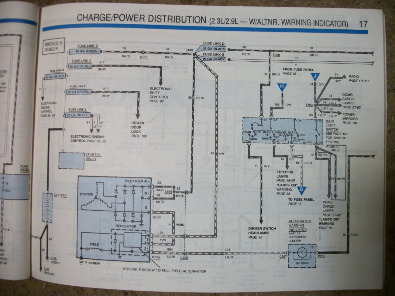

2.0L ('83-'88) 88’ 2.0 No power to fuse block
There are several fusible links, for power, at the starter relay. I'd start by checking all of those.
And besides those, fusible links E and D feed the ignition switch and fuse box; these two are on the driver's side fender apron. Link D, Black/Orange wire, feeds the fuse box.
