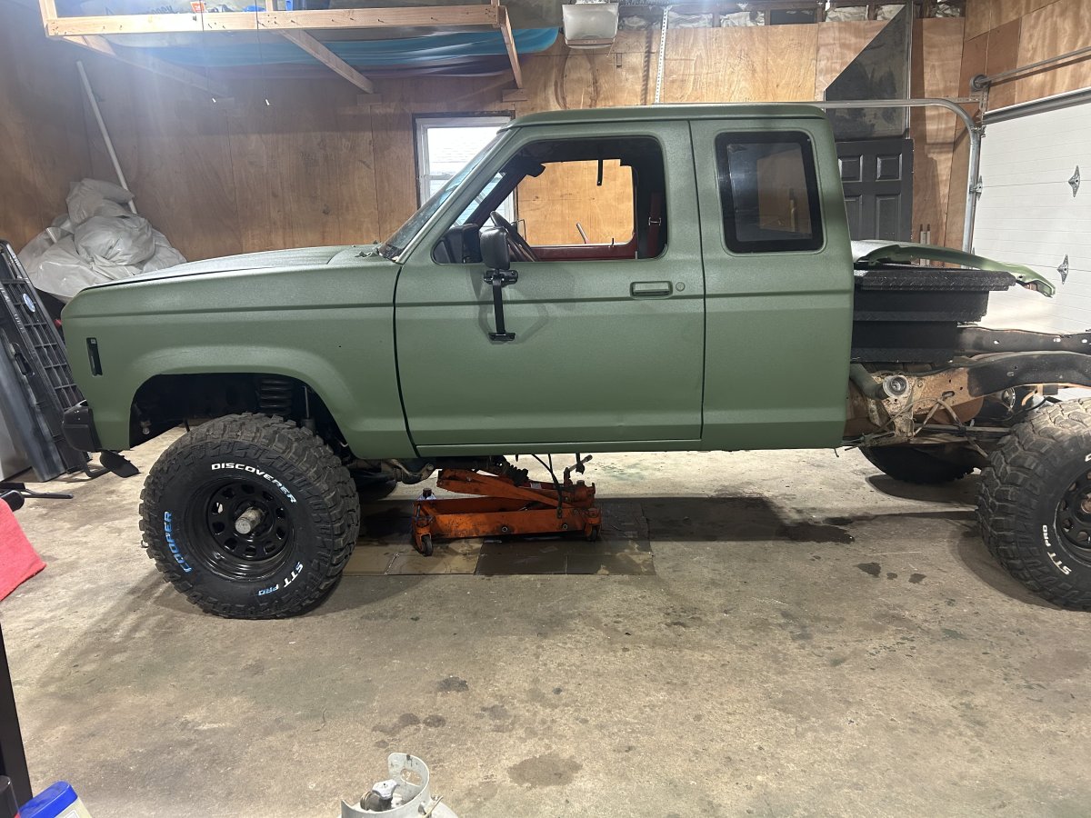

Brand new to the forum and honestly just getting into the thick of the mechanic side of things. I bought the ranger from TN and brought it to Ohio. Was told it ran good just needed tranny work. Long story short the engine was junk. I did have the A4LD rebuilt though. Lots of lessons learned in this project lol. Anyway, I have a 96 explorer but unfortunately it’s OBD2. Is this a possibly swap without having to swap the dash? What’s the best recommended route? I was given the explorer so it would be nice if it worked out. Thanks in advance for the help!! Work in progress!

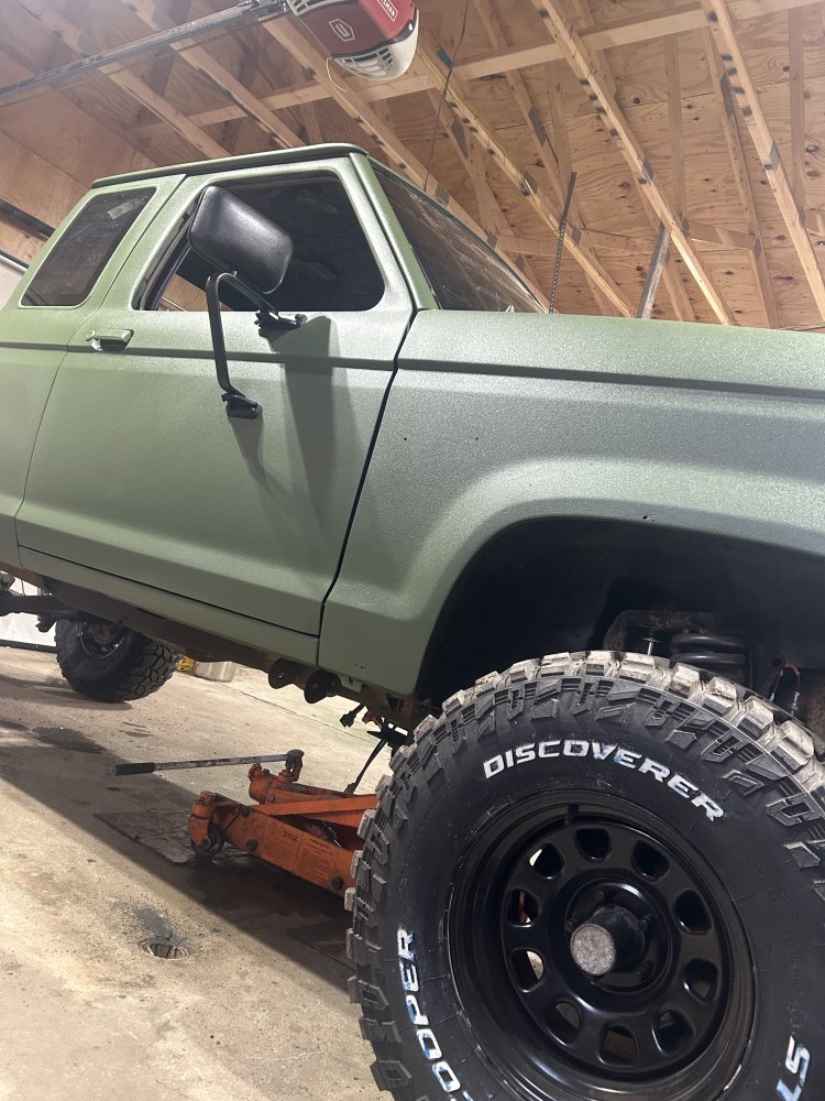

Thank you very much. I too prefer the first gen dash look. For the paint I was a little nervous using the raptor liner! Olive drab with 15% reducer and it seems to have laid down nicely. Thinking about doing a clear coat on top of it. Not sure yet.
