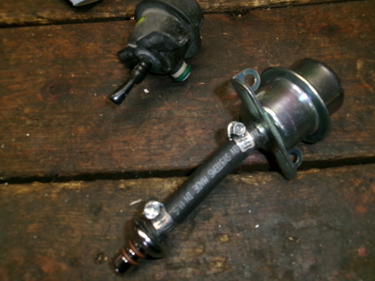

Pretty easy fix. 2 10mm (IIRC) bolts and youll need one of those spring lock tools to uncouple the fuel line

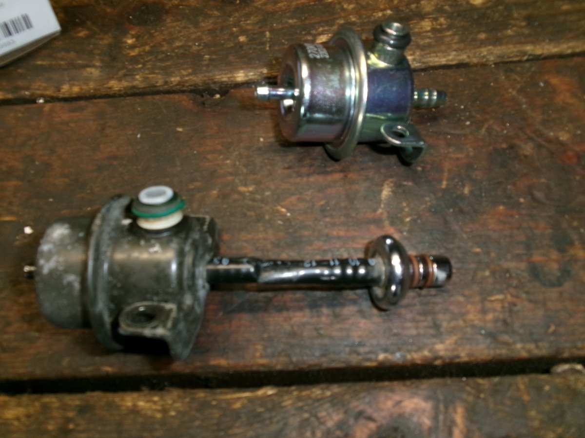

The bolts are 8mm, and I thought I might be able to twist the old reg off that stub of fuel line and not use the goofy tool. Not!
I had some fuel line and clamps so no sweat, but that black plastic stuff that seemed to be heat shrunk on there was a PITA to get off! But neener neener....... I win!
Didn't realize a stub of line came with the new reg until I was done. :icon_twisted:
Whatever, I used my MADE IN THE USA stuff and off we go!

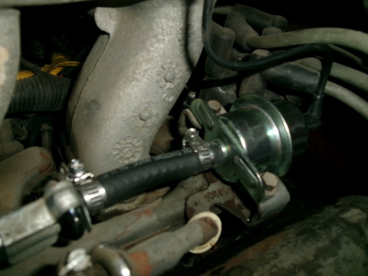

Replaced the brown o-rings on the male thingy.
Easy install, hit the starter and Bob's yer uncle!!
:yahoo:
No leakie leakie, so me happy happy! Glad I don't have to take the top of the motor apart for gaskets and 0-rings, which will happen anyway once it cools down, and I really need to get the new gaskets in the valve covers!
