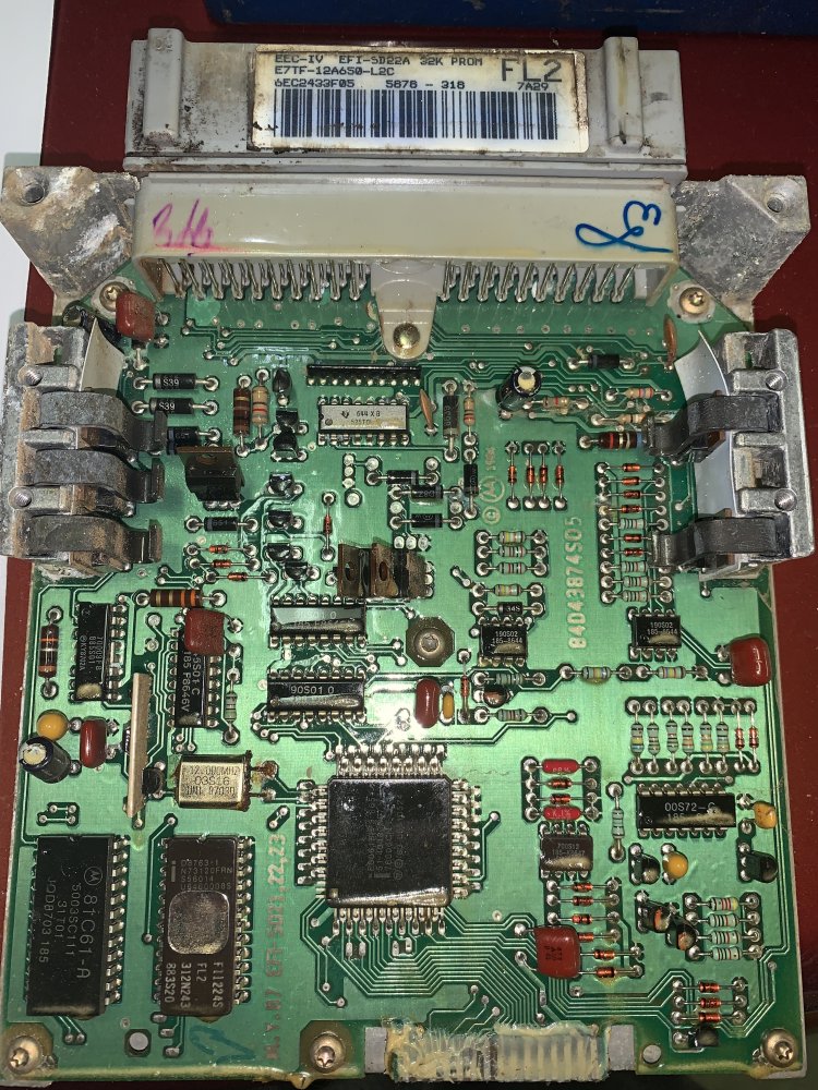

Open PCM up and look at the circuit board for damage, PCMs can fail but its usually just old/leaking capacitors that fail, and can be replaced for under $5
Look for water damage or heat damage

Me PCM is a FL2, not an A9L.
Doesn't matter its just an example

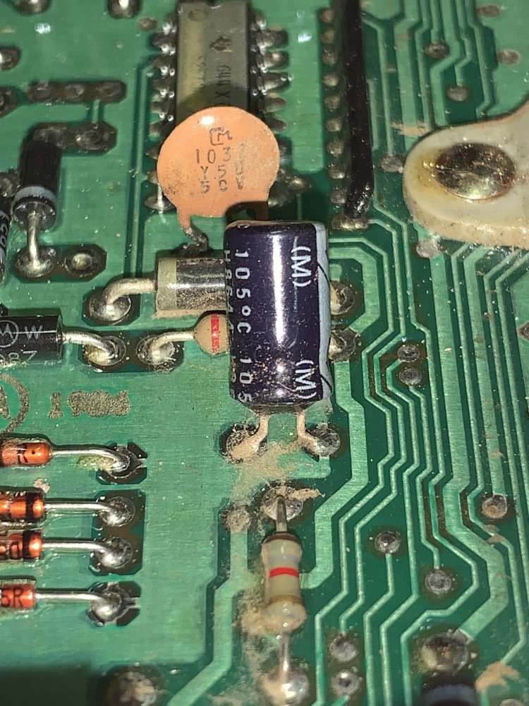

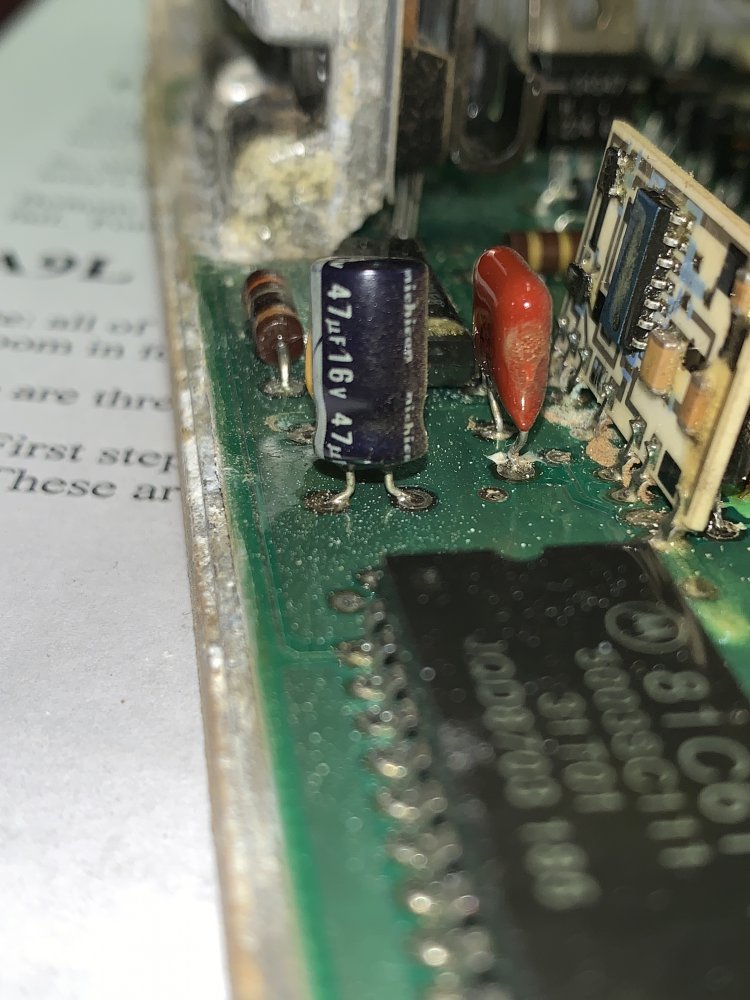

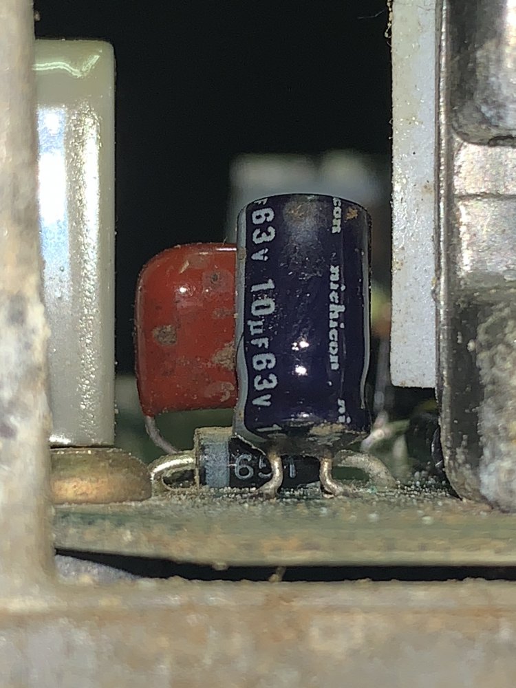

I can only see 2 capacitors from that angle, move them to see if the pins are OK aren't corroded or broken
They are Black so they may have been replaced already, all the original Ford caps I have seen were blue, they are the cheaper version, FYI, lol
But Ford could have used black caps in some years

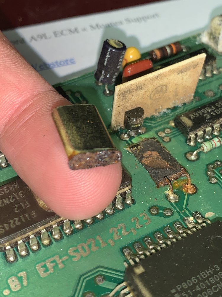

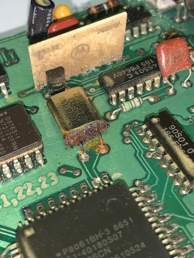

The rusty looking one came right off. Wonder what it goes to.. but that’s not a capacitor.. or is it?

If you got shit breaking off in your ecm chances are its screwed bud.
Haha, I think I fried something when I was trying to run that diagnostic with jumper wire. I obviously did it wrong.
