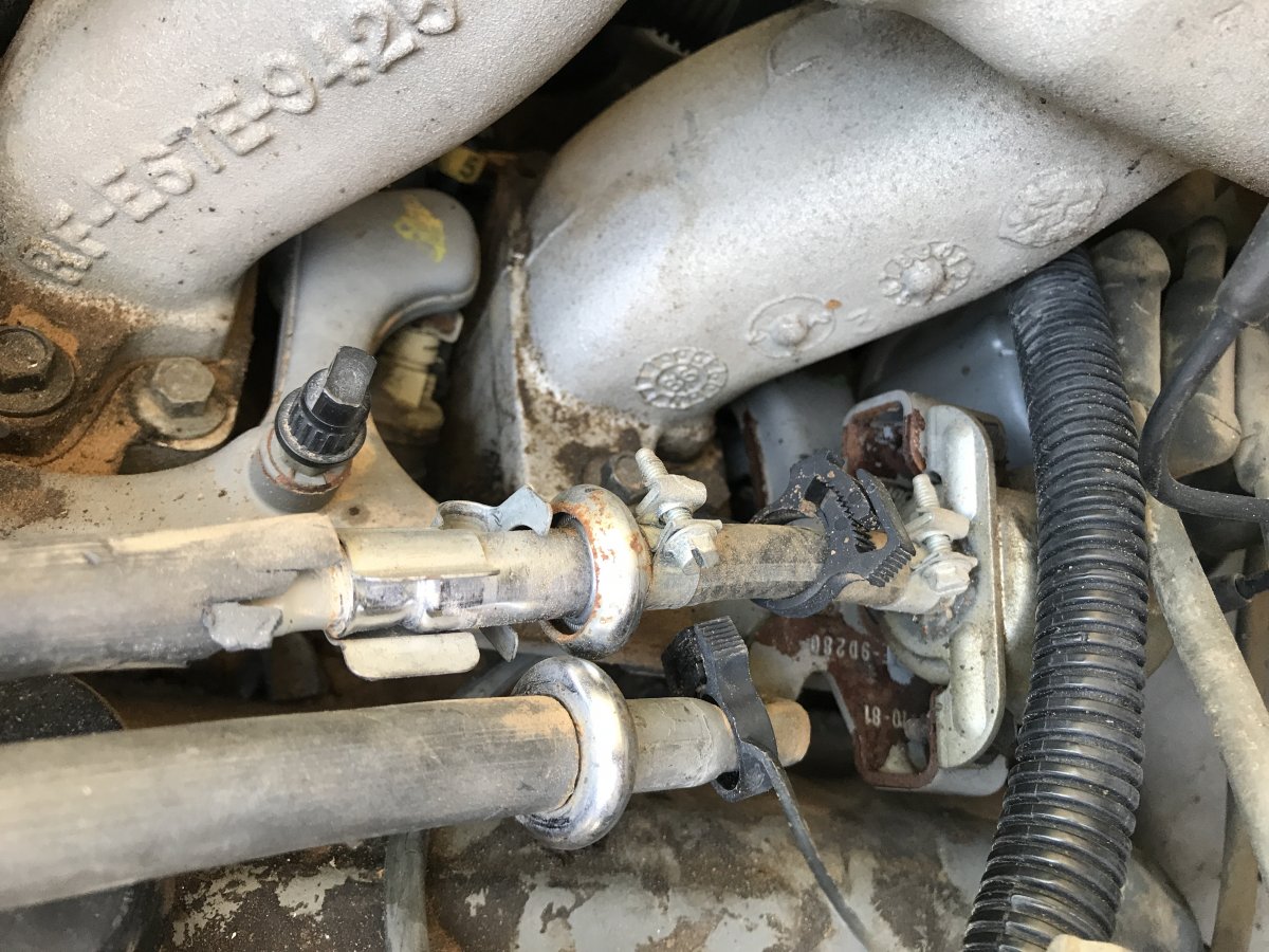

You could use regular fuel line, especially for the return line. But I believe the highest pressure in your whole system is probably only about 35psi. So you don't need anything exotic for fuel lines and fittings. Just make sure it doesn't leak.

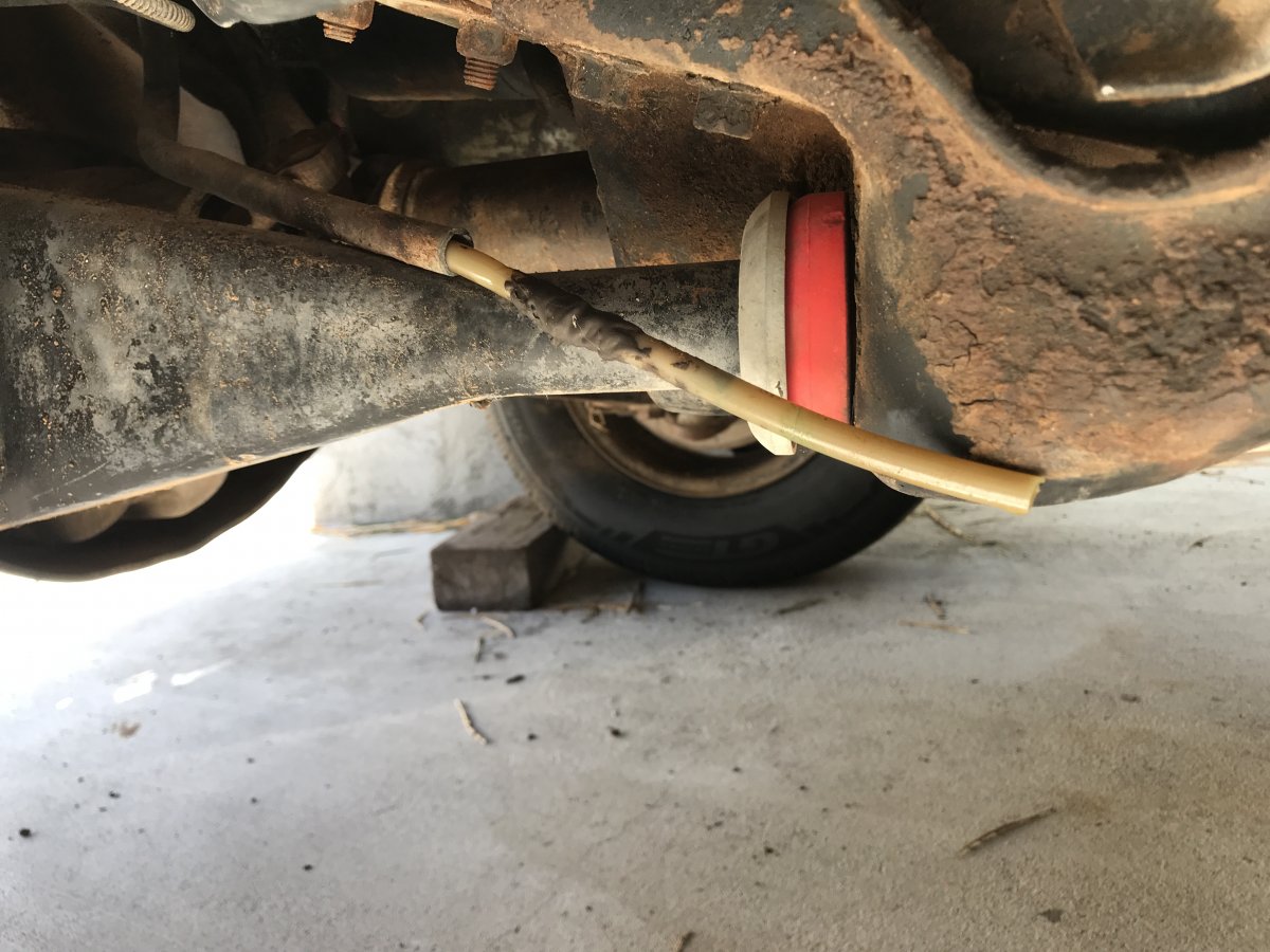

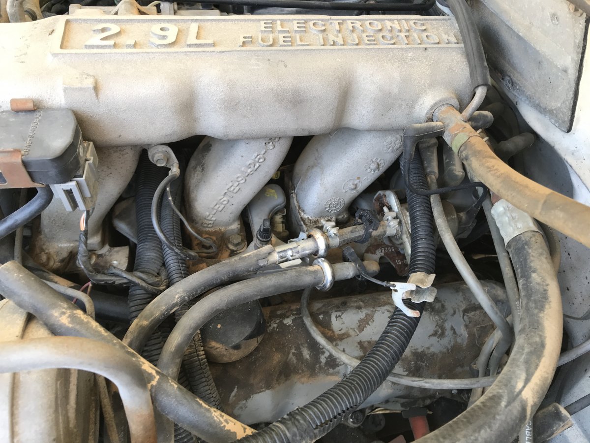

In regards to your fuel line question; use EFI reinforced fuel line, avalible in most auto parts stores and from Lowe's/Home Depot...it will cost a little more than regular rubber hose but it is reliable. Just keep an eye on where you wind up routing it; if it comes near a heat source or even heat shield make sure it is secured/zip-tied with a gap between it and the heat.
Also, they sell special EFI fuel line hose clamps that do a much better job of sealing the hose to fittings and end pieces.
So this little device sitting on top of the engine has a fuel line coming out and going back through the reservoir and back to the tank. Those two hose clamps don’t appear to be standard issue. Can I lose that whole setup and just run a regular fuel line back to the reservoir? My hose is broken.
