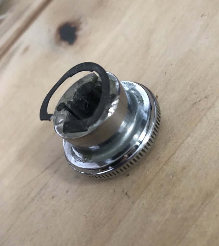

So Hudson got all mad at me for breaking the glovebox knob. Anybody want to bail me out? Where do I find that little retaining clip?
  • 87 B2 restore
The pin and spring setup is confusing me. Does anyone have a picture of what this looks like when properly assembled?
Oh, that thing.
I just looked online and it doesn’t look like those shifter parts are here. I might be able to get the glove box knob.
I might go tomorrow and browse for stuff.

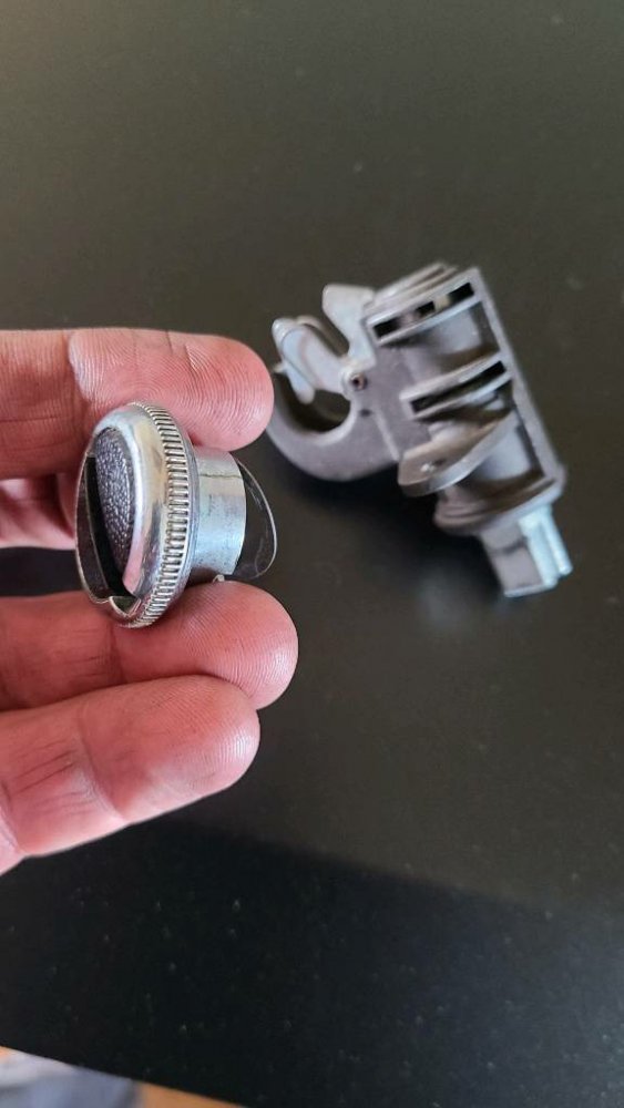

The spring is half way broken on this knob. But it holds onto the lock nicely. PM me your address and I'll mail it to you. As expected, I didn't find the shifter parts. Everything here is column shift or manual.
