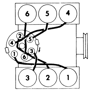

Check the firing order and make sure you didn't cross some of the wires when you changes the plugs..
