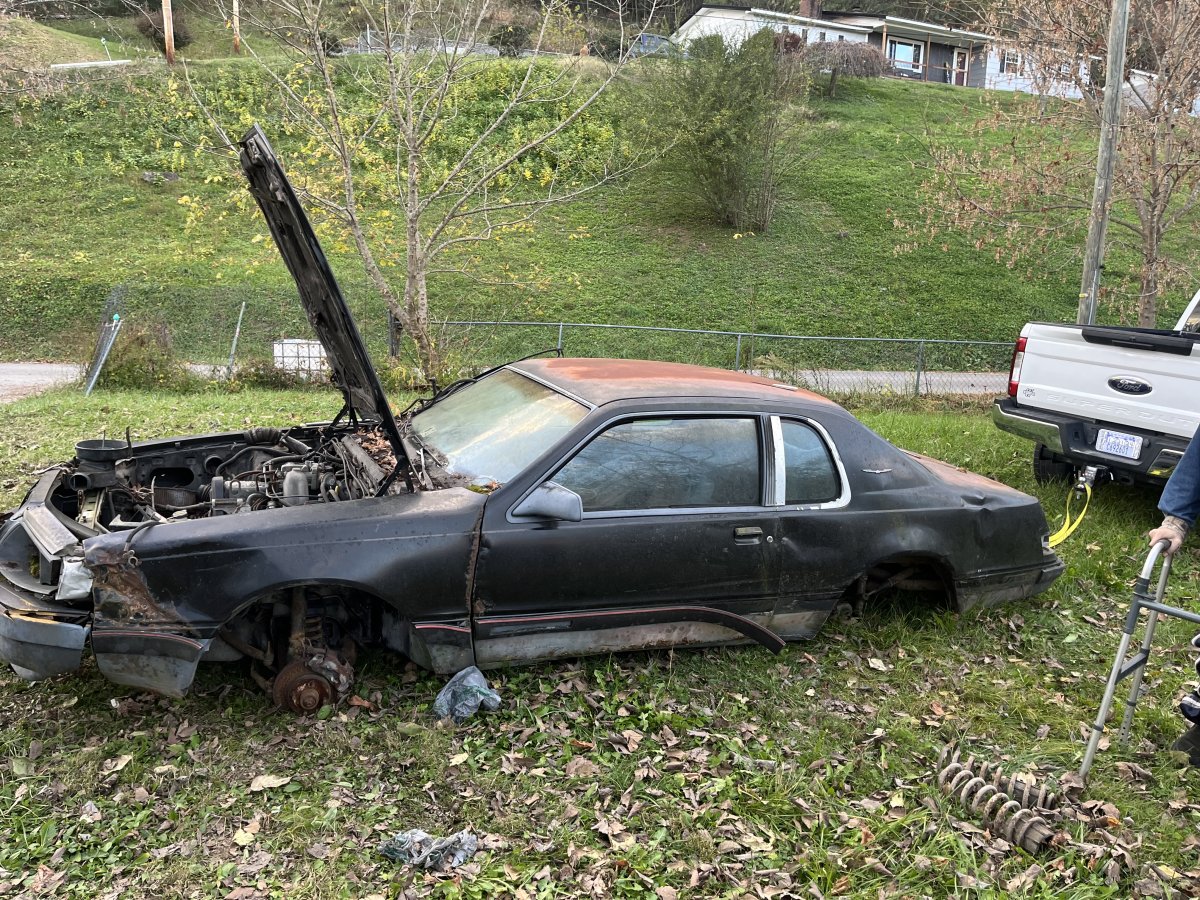

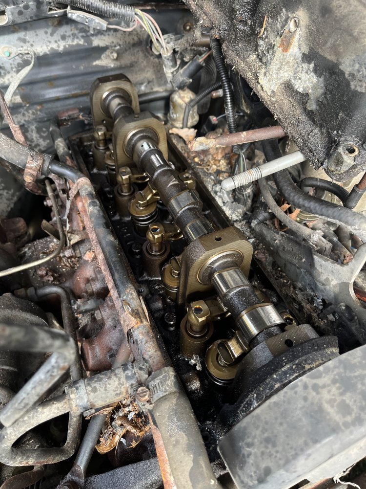

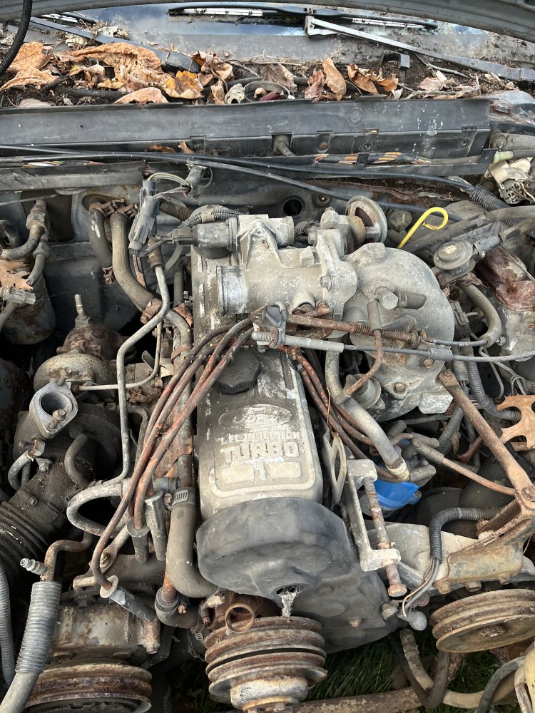

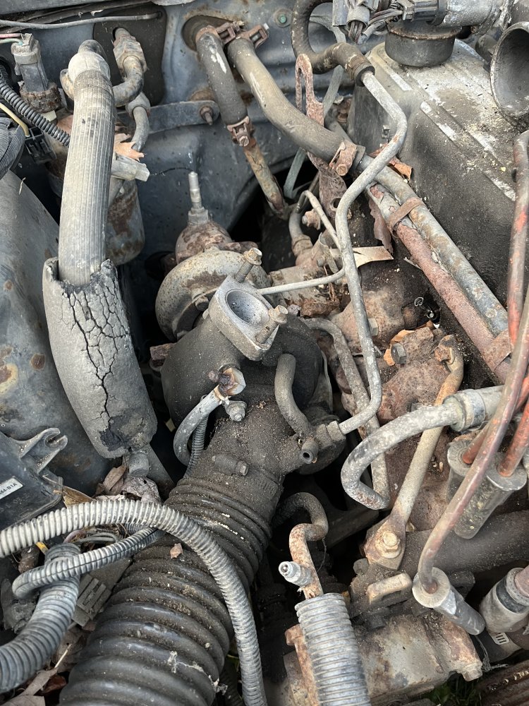

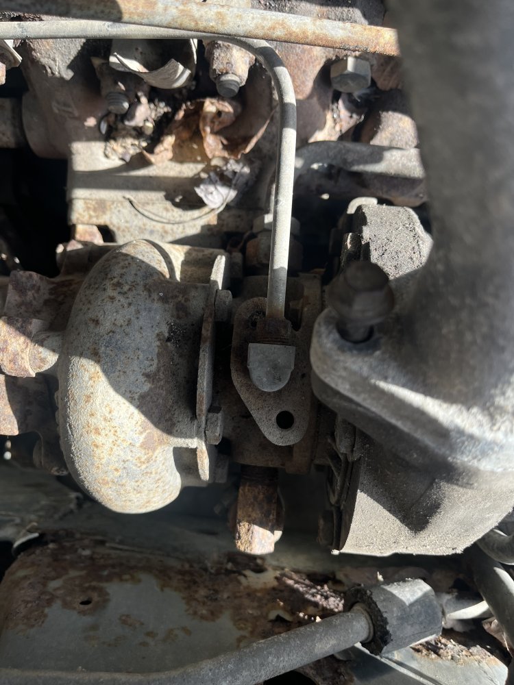

Alright, change of plans...
got the car home yesterday, its an 85.5 thunderbird. motor spins and needs cleaned up bad. However, the wiring is hacked all to s***. every line and accessory is rusted.
long story short, I have decided to just put the pistons and rods into my 95 dual plug Lima and just boost it that way. a guy is selling me an FLH2, quarter horse, 42#/hr injectors and a licensed tuner. for 600.
I'm going to buy some cheap intercooler kit, some rod bearings, gaskets top to bottom, new oil and water lines and fittings and send it on its way.
I'm going to try to have every last piece that I need before I pull my motor to rebuild it as id like to start at 6am and have it finished that evening.. lol
I will keep you both updated and ask questions as I go along
I'll drop some pics below

That sounds like a better plan... Look at the casting number on the exhaust manifold, if it starts with E6 that's the good one, less prone to crack... The good things about N/A blocks is they don't make enough cylinder pressure to really taper the cylinders as bad as a turbo block...
You'll need to drill/tap your block or oil pan for the turbo oil drain back tube but that's the only block modification...
