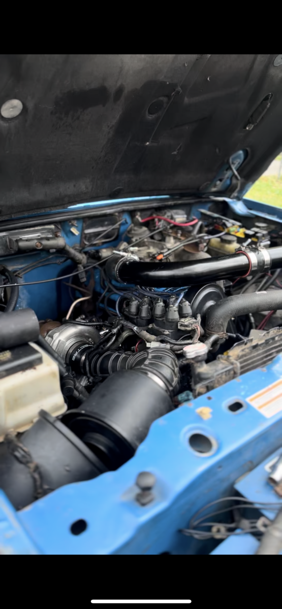

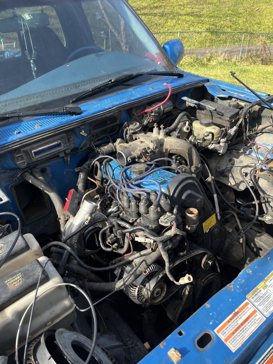

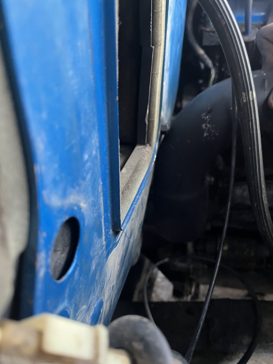

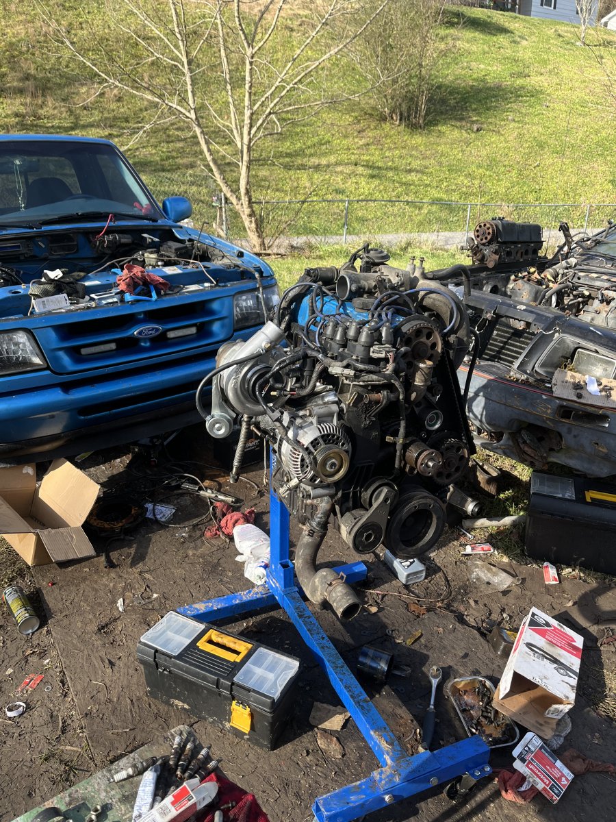

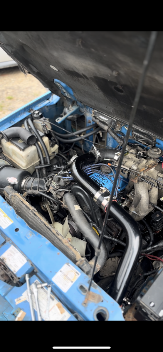

currently waiting on all the parts except the wideband its wired in and ready. I’ll attach some pictures and I’ll recap a “build list” below because the plan has changed DRASTICALLY since the beginning of this thread.
95 ranger block and 8 plug head.
85 thunderbird internals
New main and rod bearings
Re gasket
New plugs
New timing components
Felpro 1035
Factory replacement head bolts
eBay manifold
Maxspeedingrods t3/t4 .63ar turbo
BigRmotorsports oil feed line
Custom oil drain
Seimen deca 60# injectors
Walbro 255 pump
Slot maf
Front mount intercooler
Amazon piping
1998 ranger 2.5L (FLH2) ECM
moates quaterhorse and BE
Innovate MTX-L
Custom 2.5” downpipe and exhaust
Factory replacement clutch
M5r1 5spd (have a cable t5 just need to convert it to hydro)
This is all before the slot maf conversion so don’t mind the inlet tube
And the downpipe clearance will be remedied before it hits the road.
