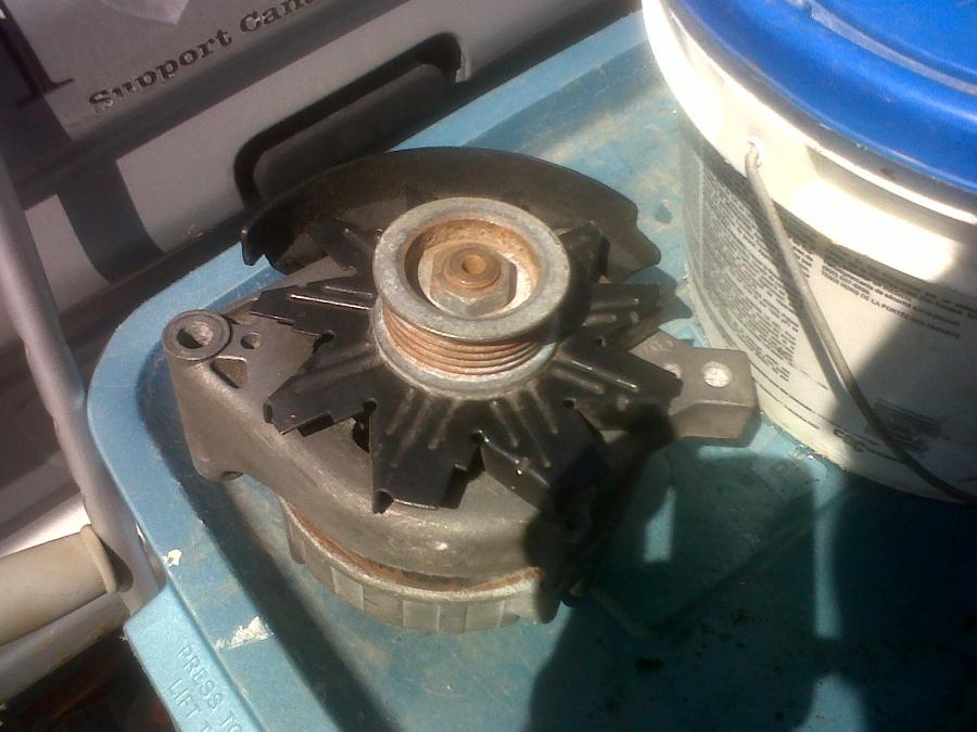

Needing to wire up a alternator. It has a green and a yellow wire going into the plug in. It has two heavy black wires and one tiny white wire going into the case.
Anyone know what does what? The green and yellow wires I assume activate it but I don't know which is hot and if the other is ground or what.
And then the two charging wires, IIRC they were connected together back when this thing was in the truck... which doesn't make a ton of sense either.
And the little white wire I don't think was even hooked up.
86 or 85, I think it makes a difference.
It is a fairly new one that used to be in my '85 with the 2.8 and phase one of my 302 before the Explorer FEAD went in, someone before me converted my truck to be internally regulated. When I got a new alternator I had to get one for an '86, which is what this one is. From the factory '85's are externally regulated.
Almost sounds like the one I have in my 96...can you take a picture of what you have? I still have the wiring harness from the 2.0 carbed engine but that one had two plugs on the alternator...one had three wires and the other had two.
Best picture I have right off hand.

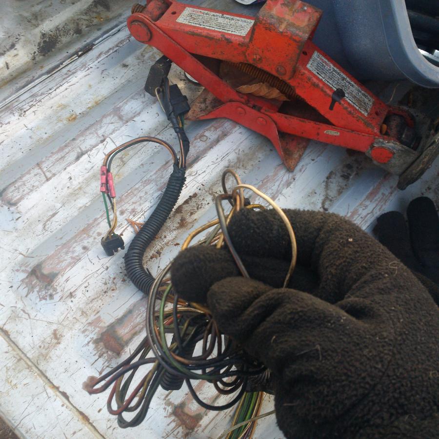

OK, that is the same as the one I had on the 88 2.0/2.3...I have the wiring harness with the plugs on it and was holding it this afternoon but found what I was looking for.
I can take a picture of the wiring harness tomorrow and pop it up here...or send it via pm if that works. There should be two plugs on this unit...one with three wires and one with two...is that what you have?

The side closest to the camera is a plug connector. The one on the far side with the two black wires and a white wire kinda looks like a connector but doesn't seem to want to unplug.
There is only one white wire it is looping around and going behind the case in the pic, but there are two black wires coming out of the unit. They both do the same thing?

Anyway...the two black/orange stripe wires are joined into a single black/orange wire so, yes, they are one wire (I guess it has to do with AC to DC or something)...and the plug also has a singe white with black stripe wire...the other plug has a green and a yellow wire but I couldn't trace them beyond that harness because they go off into the firewall connectors...
I just hope I had enough light to show the colours of the wires...

The plug images...not too clear...but should give you an idea if these will fit...
OK...viewable but not good quality...lol

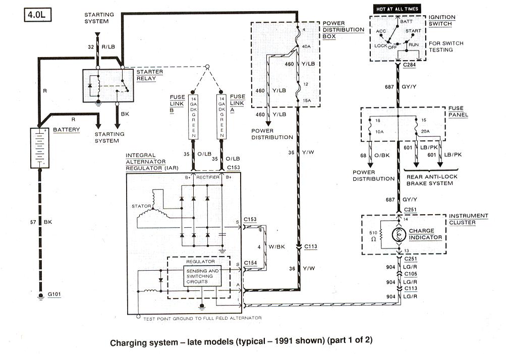

After a pretty extensive detour on the project I am getting back to how I want to wire the thing. It hit me today; "hey, I thought we had wiring diagrams somewhere in the tech library?" Sure enough we do!
Found this and it pretty much confirms what everybody here was saying. The two black heavy wires are both coming out of the alt and go to the battery post on the starter relay (or in my case starter switch) Yellow wire going to the alt connector needs constant battery so it goes to the starter relay/switch too. Green is hot with the key. Don't know what white really does yet, I don't remember what if anything it did when alternator was in the truck.
When I swapped this alternator for the Explorer one in my Ranger I swapped connectors for the Explorer one because they were in different locations and since it charges they must do the same thing per color. That was '86 to '97, not that I wouldn't put it past Ford but is unlikely they changed it for a year or two in the middle.

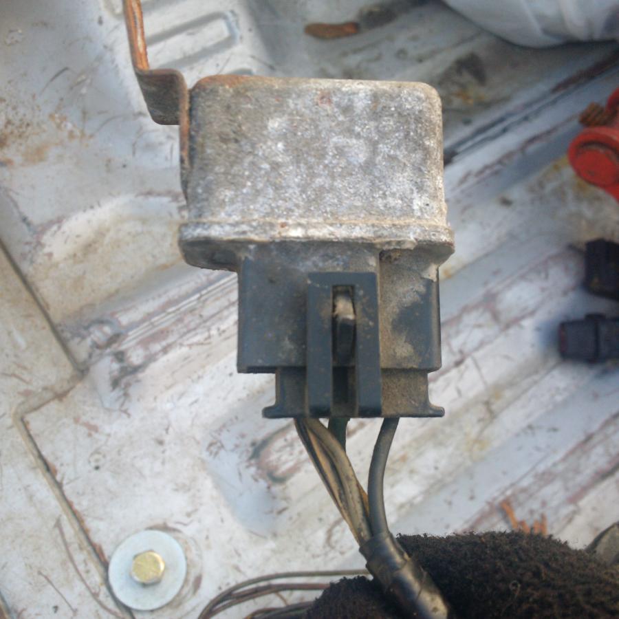

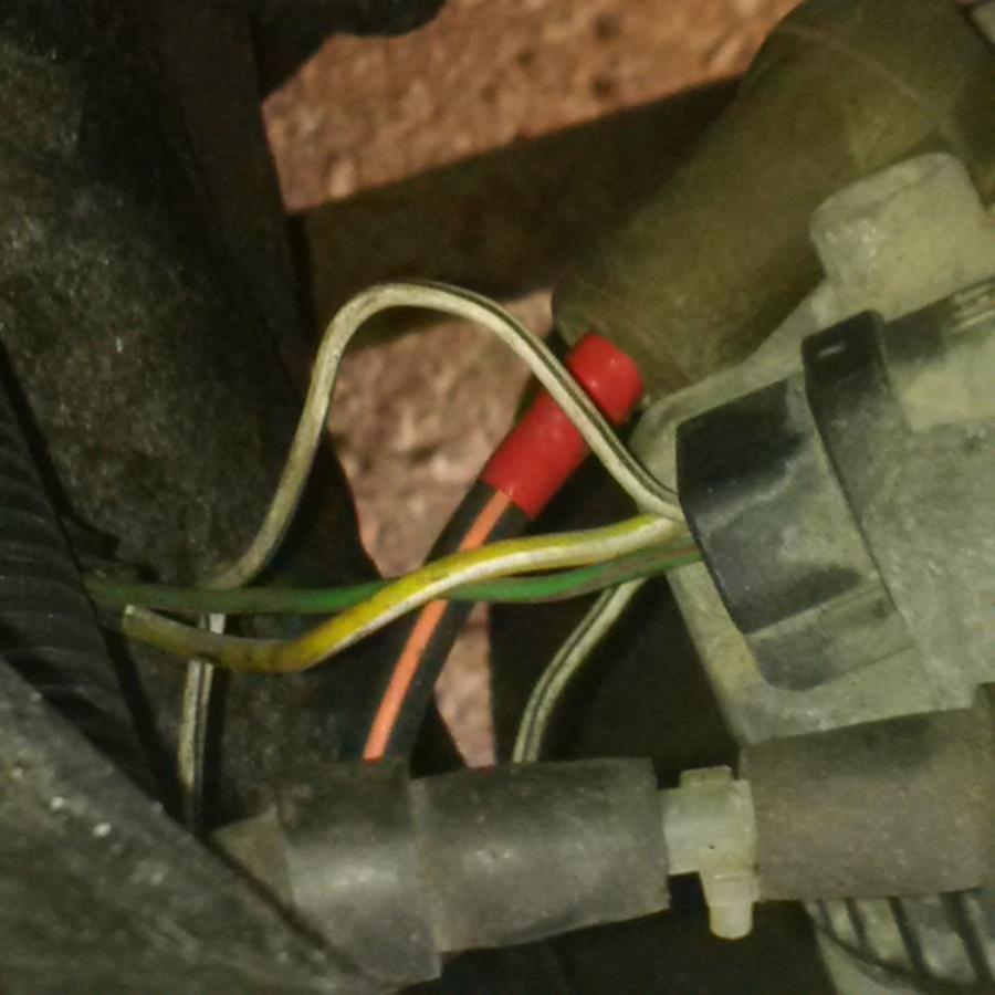

Added the wiring for 96 alternator and another shot of the white/bl wire...maybe relay...

The 1991 diagram shows the white wire (with black stripe) going from one point on the body of the alternator to another point on the body. The wire connectors that you are using there shows a much longer white wire than what my 96 has for the same purpose. It would be nice if they could have shown wire thickness in these diagrams because I've often been thrown off by looking for a 14 or 16 gauge wire only to find out it is a 20 or 22 gauge...the white wire on my 96 appears to be 18 or higher...but my memory needs refreshing.

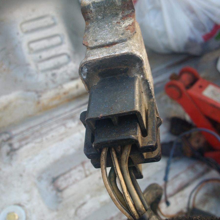

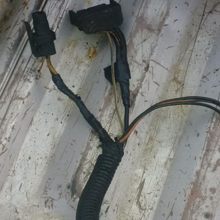

UPDATE: So...I found the wire harness and traced the white/bl wire...goes all the way to the passenger side fender and dead ends in the connector shown in the image below. The black/orange wire is the main power that goes back to a connector that feeds through the firewall to the staring ciruit. I also got a shot of the 96 wiring on the alternator and you can see the white wire loops as shown in the 1991 4.0 diagram (or maybe 1992).
So...I have no idea what that white/bl wire is connected too...but it has several wires so it may be activated by that connector...maybe a relay of sorts that allows the altermator to charge or stop charging...like an on/off switch.
