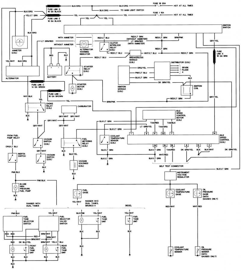

'86 Ranger Alternator Wiring
It is supposed to be for an '86 but the wiring diagram matches up with what I have. The green and yellow do the same things on my '97 Explorer alternator that they did on this one, the two black wires were connected to each other and when on in the truck.
While looking for something else I found the one that came with my '87 302 and it had the same one, with the one white wire hanging off into space just like mine.

I found a 2.0 wire diagram and was able to download it..and it actually shows the white/blk wire going into a relay...that controls...of all things...the CHOKE!
So...you don't need to actually hook it up if you are using a manual choke...so cool...another mystery solved...
When using the on-line manual punch in the 1988 model year and select the 2.0 engine...under the wiring diagrams there is a TON of diagrams for 1983 right up to 1990
