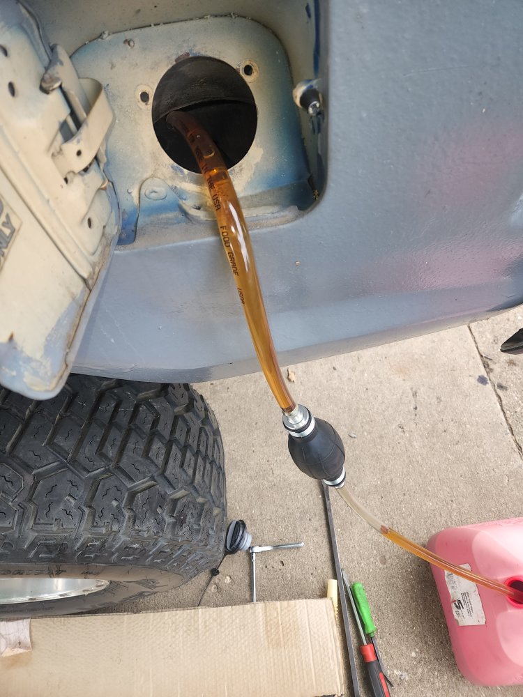

So I'm pulling apart the fuel system to simplify things a bit. My plan is to only do it once. I'm gonna go from the factory 2 pump and canister filter to a single in-tank high pressure pump and an in-line filter.
First step is to drain out the old fuel and get the tank removed. The fuel was about the color of maple syrup and smelled like stuff my grandmother used when she was refinishing antique furniture.

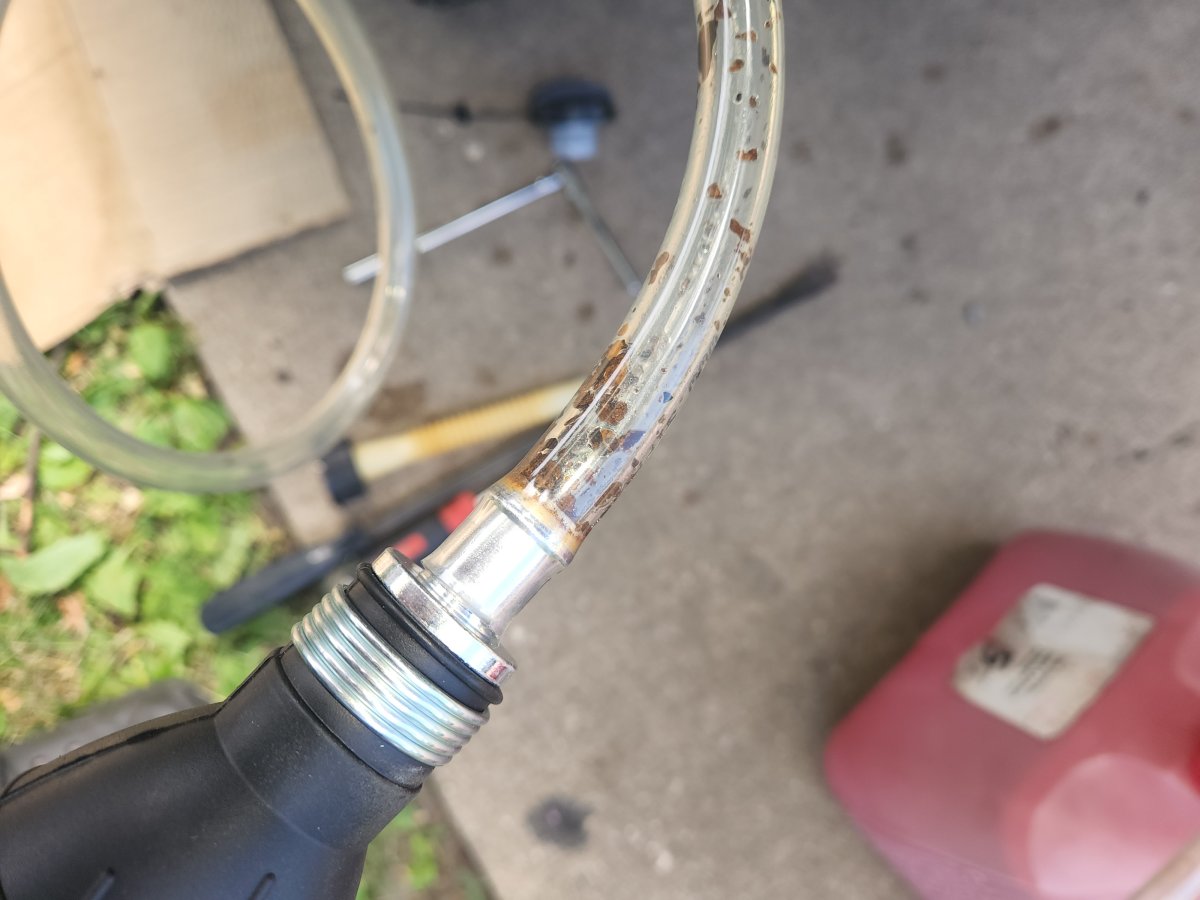

The next picture is what I sucked off the bottom of the tank. Lots of crunchy stuff. I'm not even gonna fool with it... new tank ordered.

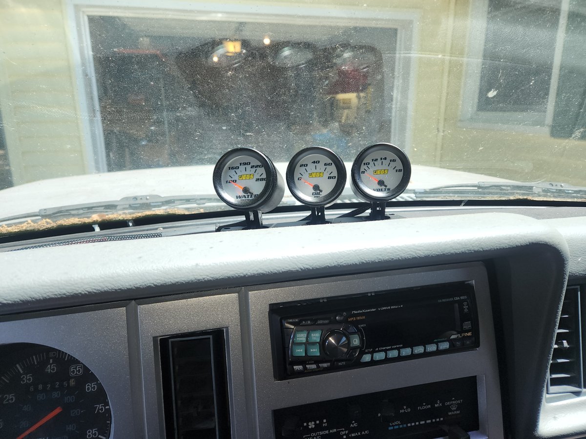

So I'm also set on gauge position. I think I kinda like them on the dash... adds 10 hp easily.

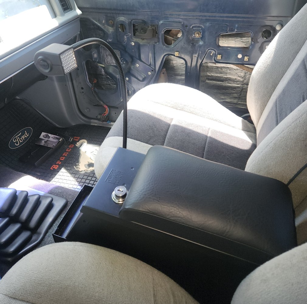

I also set my tuffy console in it and got a feel for it. Drink holders will have to go on the back... and with them there... rear seat won't fold away. Just another reason I guess to just pull them out. This is the 6 1/2 inch wide console... and I think it fits perfect.
Think I'm going to mount the Hella navigation light just like it sits. Will come in handy for covert doobie rollin or maybe reading a map. I told my wife it was for her to scratch lottery tickets at night... she loved the idea!

I like that siphon you have. What brand is it, or where can one be purchased?

I got that siphon from Amazon too. It works well. I can look up a link if you want. There are many to pick from.

Heads up on the primer bulb. I saw two types... I believe one is a flow through. That's the one you want. The other type you have to continually pump the bulb to transfer fluid. Also... the tubing is 1/2 inch food grade tubing that came in my kit.
Try siphonepro.com
