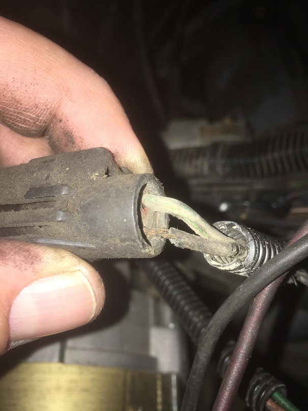

OK, I am a schmuck. I was reading the connector to the ECM backward. There is a wire on pin 7. Duh.
Went out to the connector at the ECT and pulled it. It looks like this:
72119
So that's trash. It's worse in person.
I have 4.57 volt on the black/LT Grey wire pin. I think that is because that connector is so bad, it's losing voltage. So I have ordered a new connector. There is NO WAY I could get my multimeter leads on the posts on the ECT Sesnor itself so for now, I am going to let it ride. If I am losing 10% of my reference voltage right off the bat, that may be the whole problem.

Last night we installed a new temp sender (now the temp gauge finally works), a wrecking yard acquired/Original Ford CTS, and the new CTS connector. I did not drive it but my son did and he said HUGE difference. I notice it seems to idle a little smoother at temp. We had disconnected the battery while we worked so it is hard to guess if the cold idle was any better.
When I clipped off the old connecter, I found three significant cracks in the insulation that were not in that above picture. That's all clean and good now.
