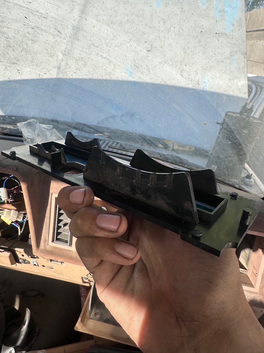

is there a article on swapping guage pods?
I see online a gps speedometer that could work well, and also a quad guage pod

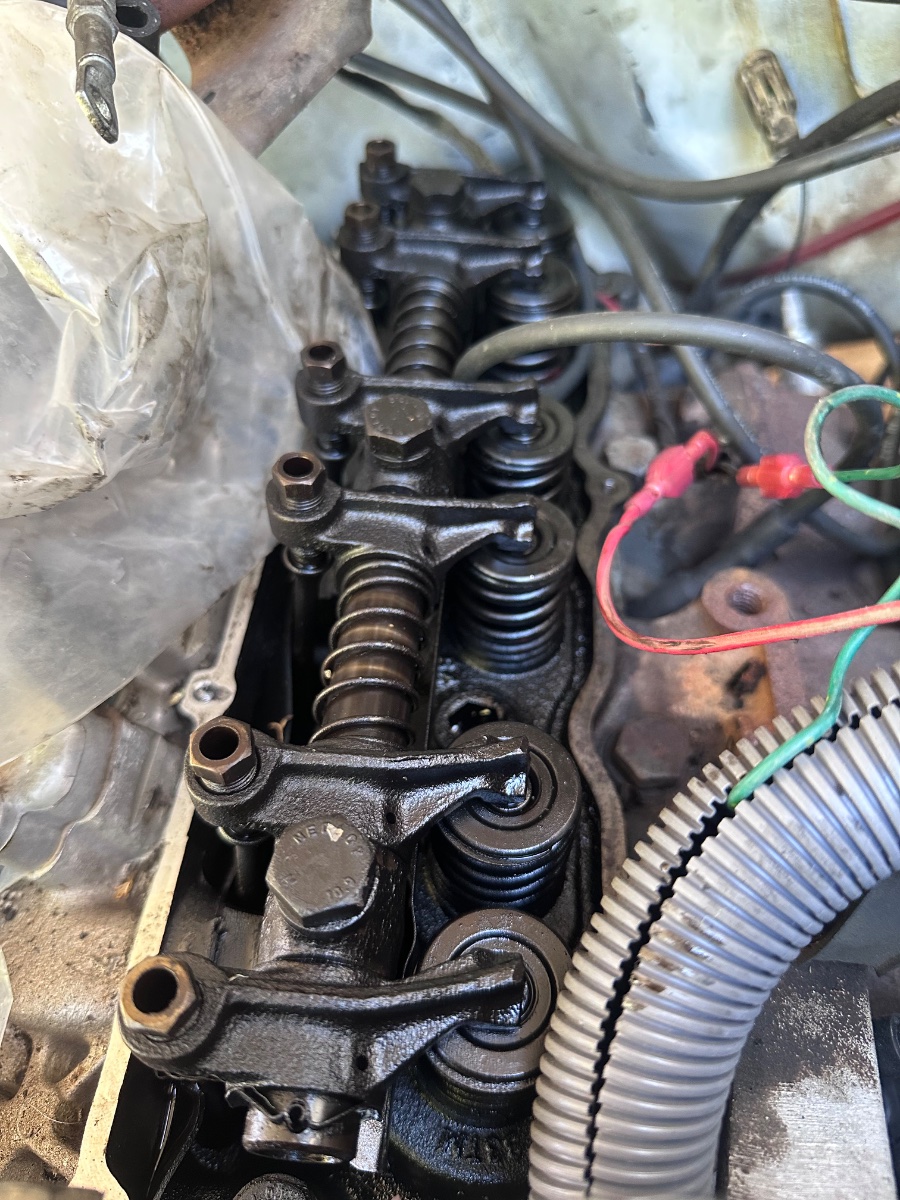

I don't think it would really matter compression vs exhaust. The rocker arm shaft will be removed to replace the valve seals so the valves won't be trying to open. You will have compression at the spark plug hole no matter what.

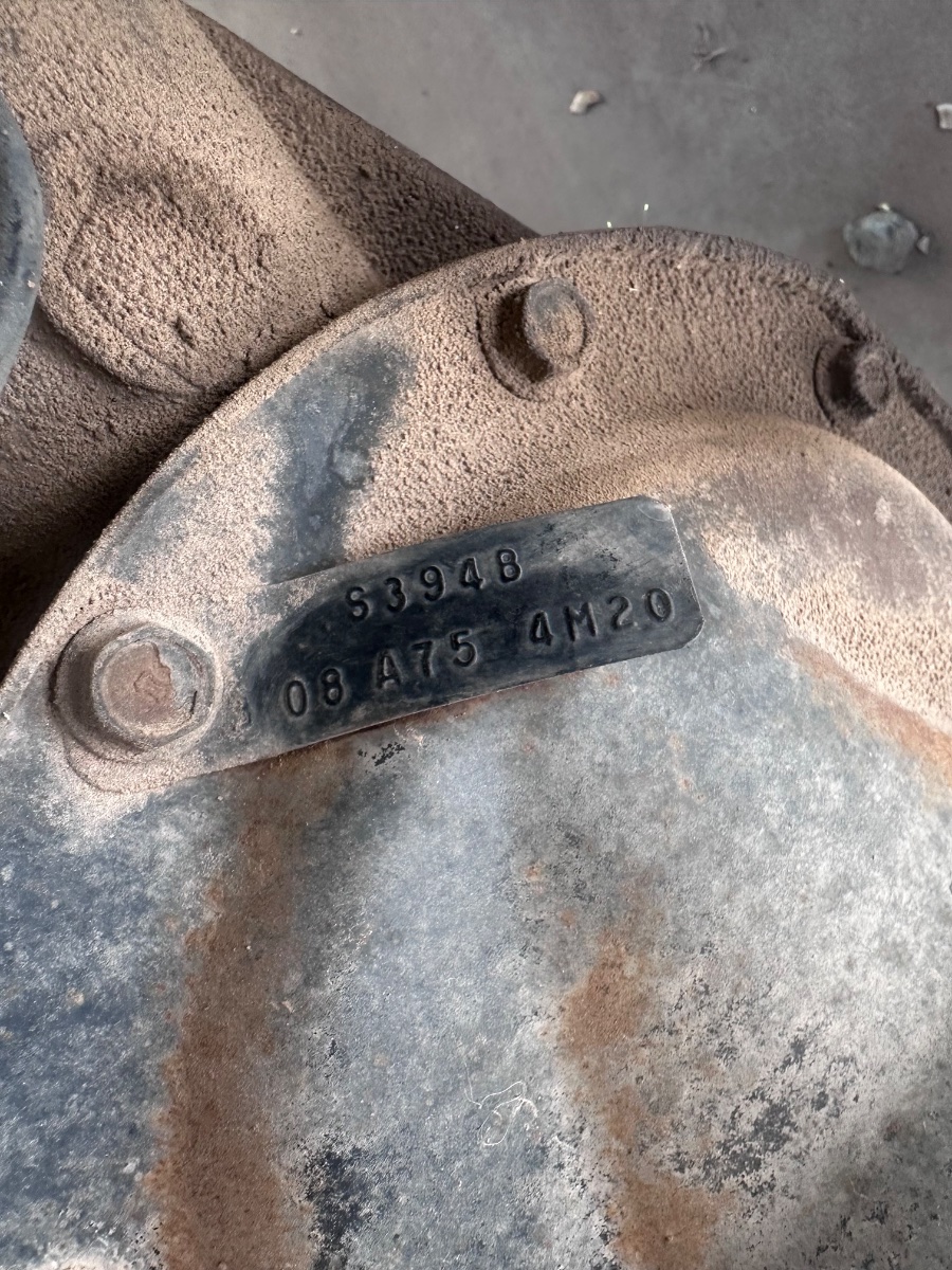

Update, ordering gaskets for engine, and rear differential gaskets, took a gander at the axle code and my god , 3.08 gearing 😬 had to clean up the tag abit more after the photo.

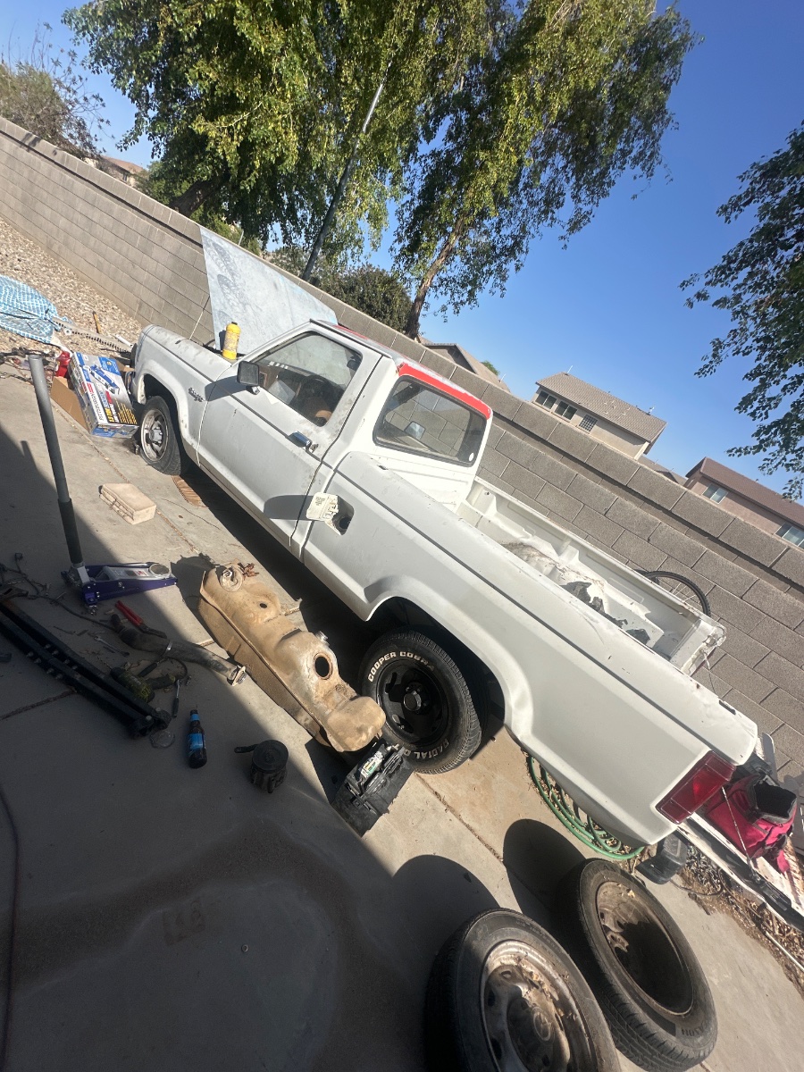

Heres how its sitting, waiting on fuel parts to come in then imma order the EFI kit. While i wait these few days ill replace the gaskets, including valve stem seals. Wish me luck.

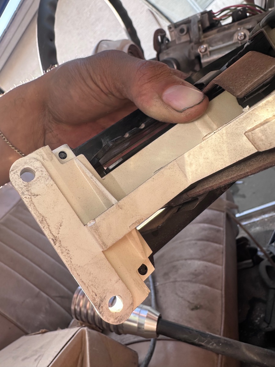

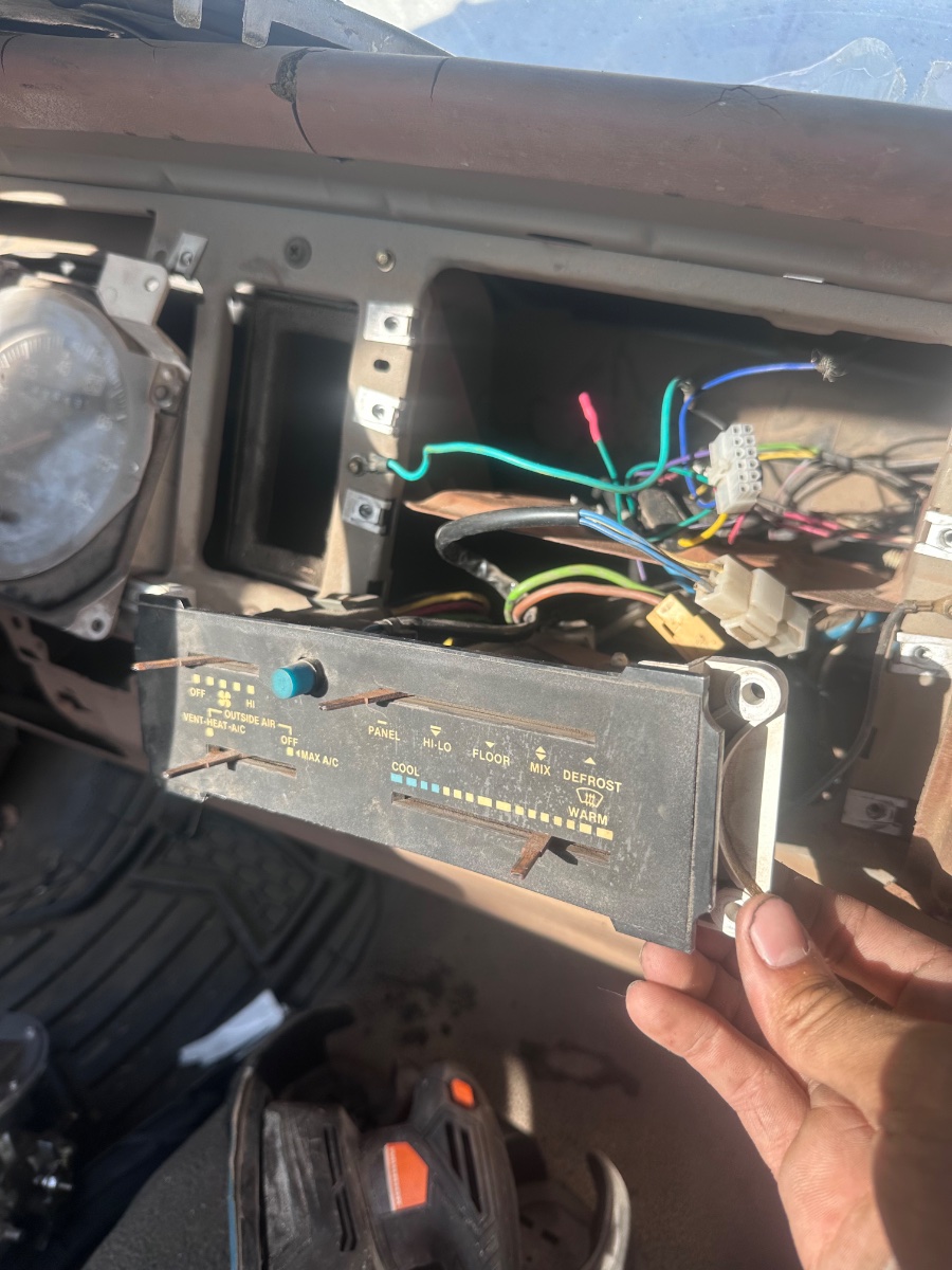

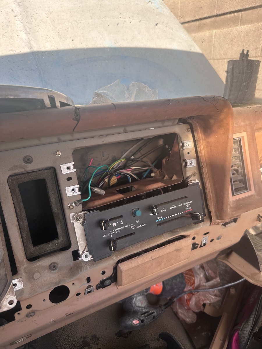

Out with the old faceplate in with the new. Just sanded the plastic rivets enough to pop the plate out and swapped them. Snapped back in, ill glue it when i put interior back together.

When i get around to doing my valve stem seals, is there anything else i should do while i have covers off? Spring , pushrod, or rocker upgrades? Or just leave it all alone and do the seals?

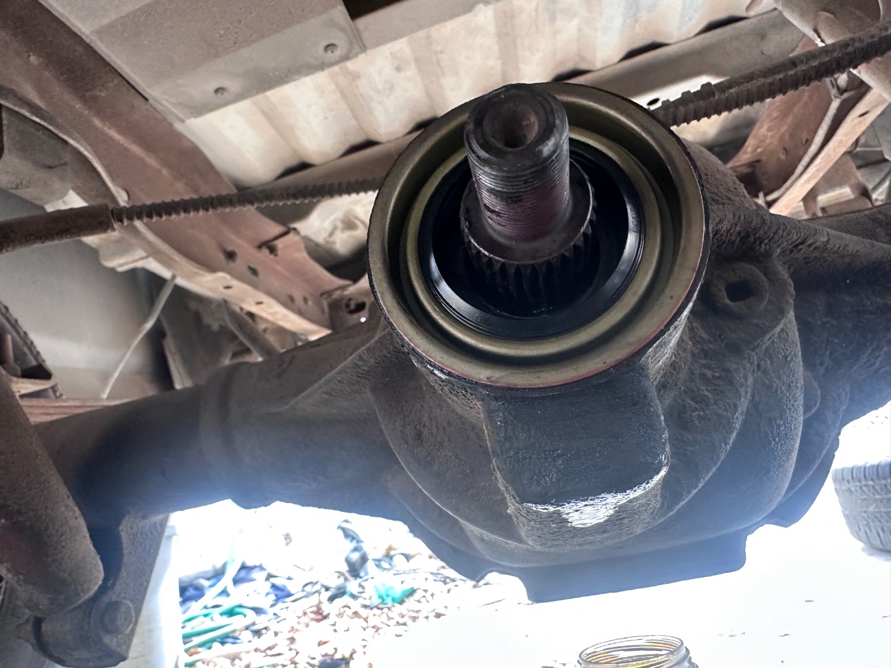

Did the rear pinion seal, bolts from the shaft to the yolk was very loose already , used loctite after putting it together

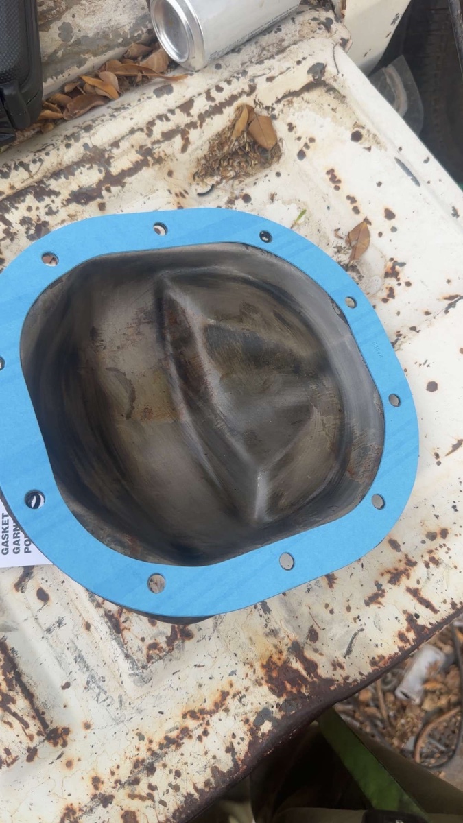

Originally someone used gasket maker, cleaned up and replaced diff cover gasket, added new fluid 80w90. Open differential.
Whats the rotational ft lb for the pinion bolt? I marked it , but not well enough.

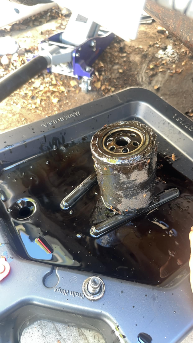

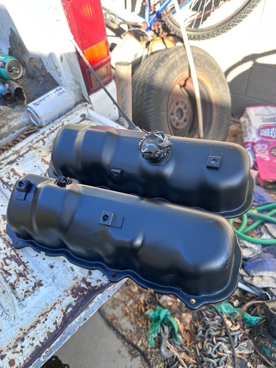

working on oil pan gasket, fresh oil, and servicing cooling system. Valve stem seals and valve cover gasket is next on my to-do list.
is there anywhere else i should check for leaks? seems like i got almost everything, power steering fluid is good, any other places it could leak from? Front seal should be OK its just the lower portion on the oil pan that leaks.
Update, oil pan gasket job is NOT as easy as i thought, almost done though.

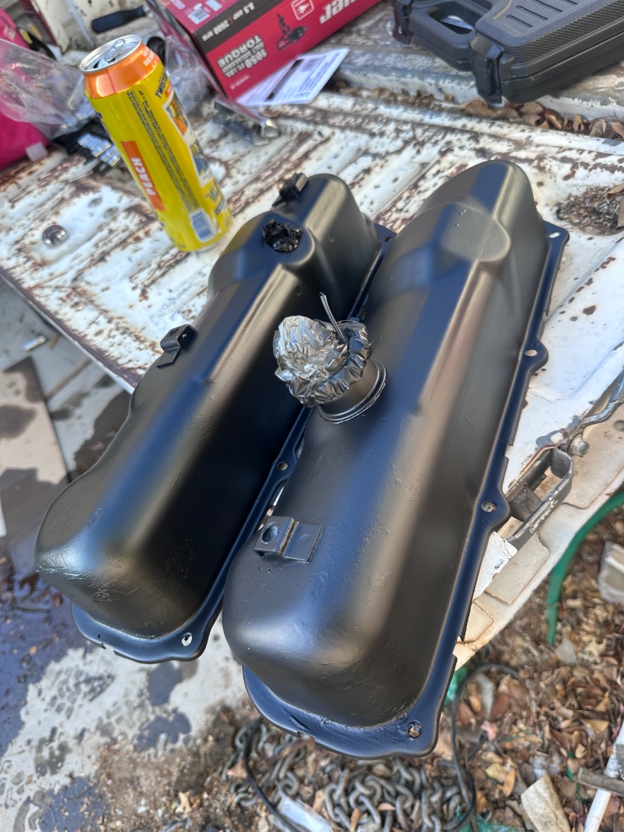

Oil pan job is done, doing the rocker covers and stem seals over the weekend. Using the rope method. As far as valve lash, what am i aiming for? Seeing mixed answers. Almost ready to daily again 😎
