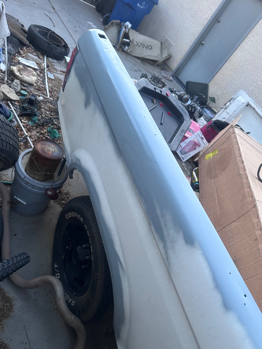

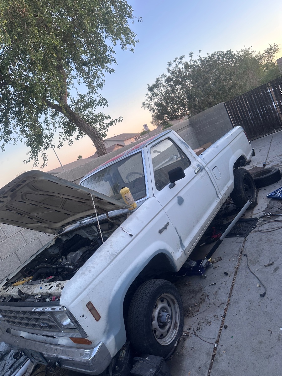

85 Ranger V6 Restoration

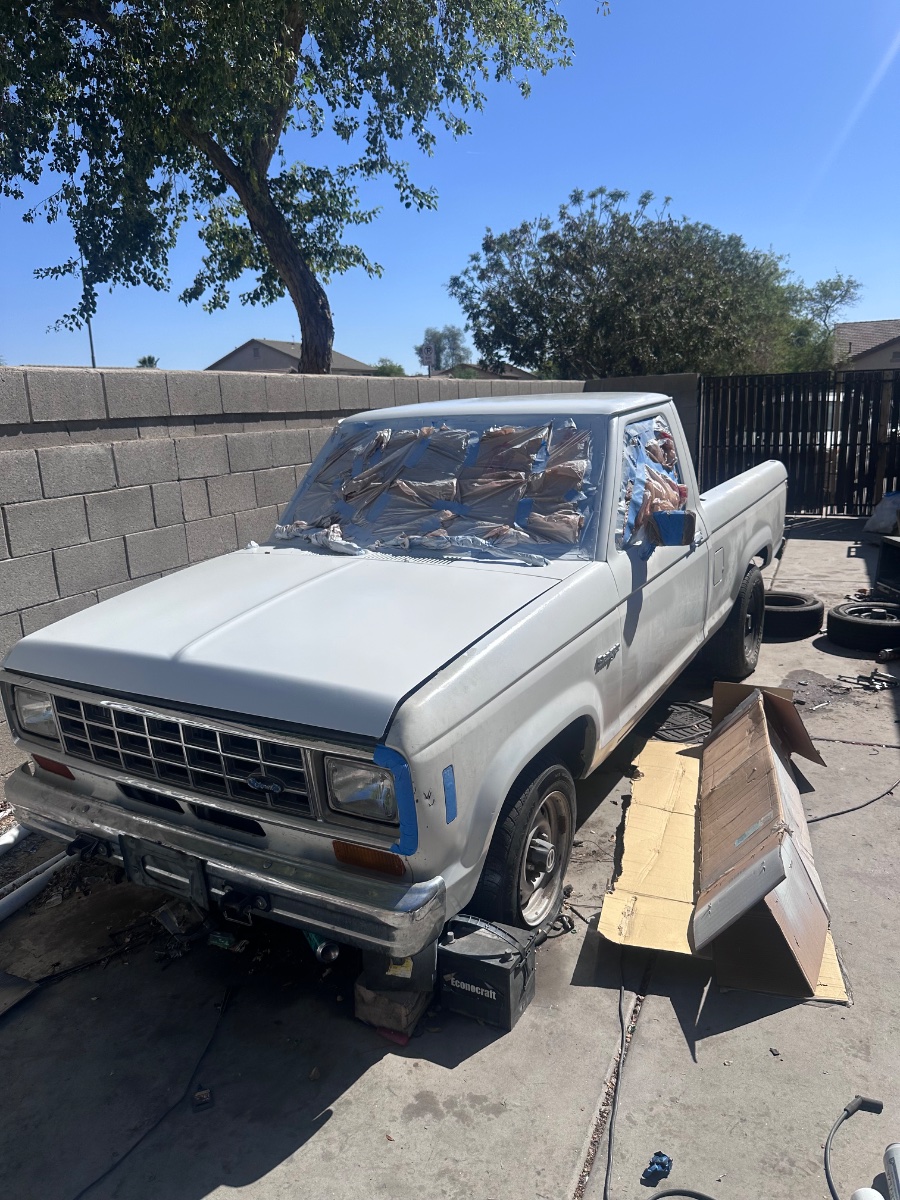

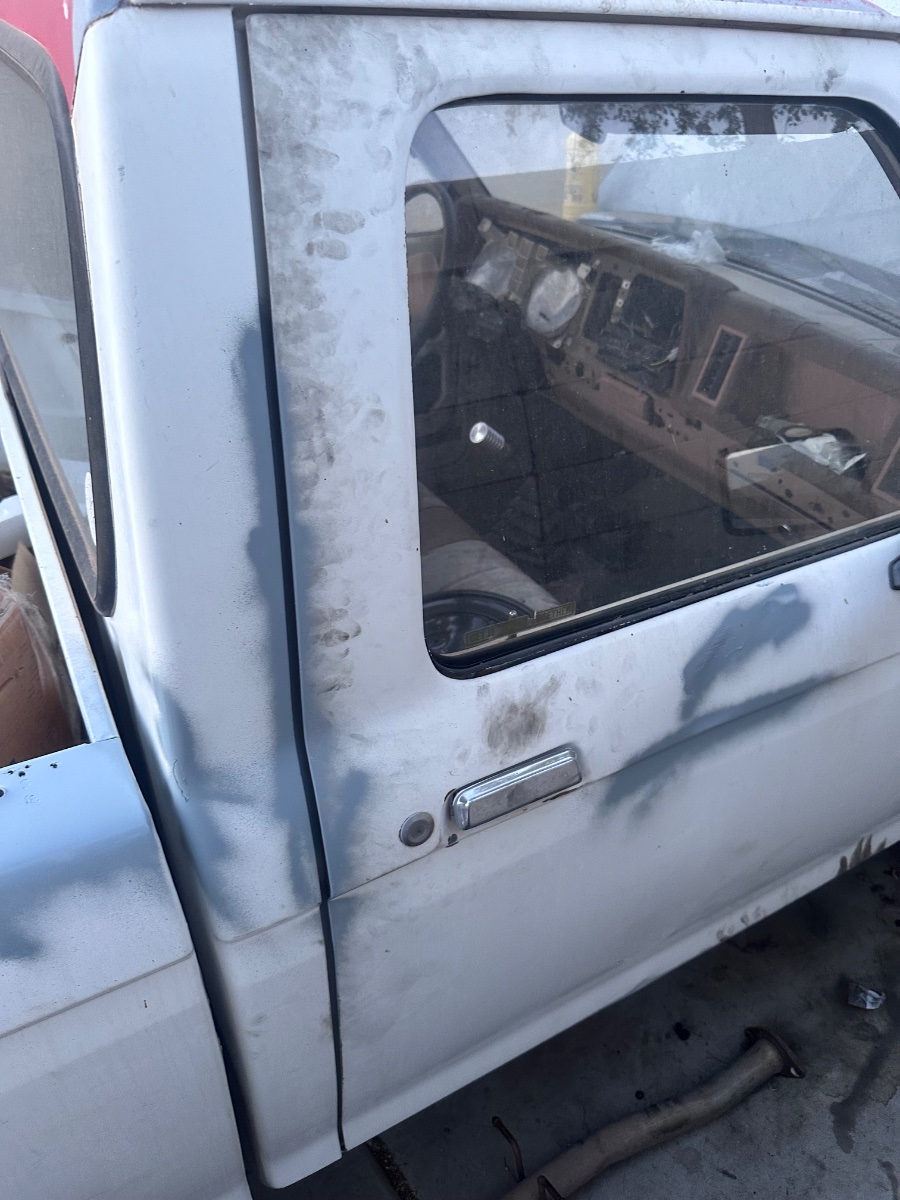

i half assed cleaning up the surface rust, going to do wrap instead of paint…
For some reason these sellers are a PITA and arent shipping my sending unit. 3rd time is a charm.
Literally i just need fuel system going and it should be daily ready. I fixed most of the leaks.

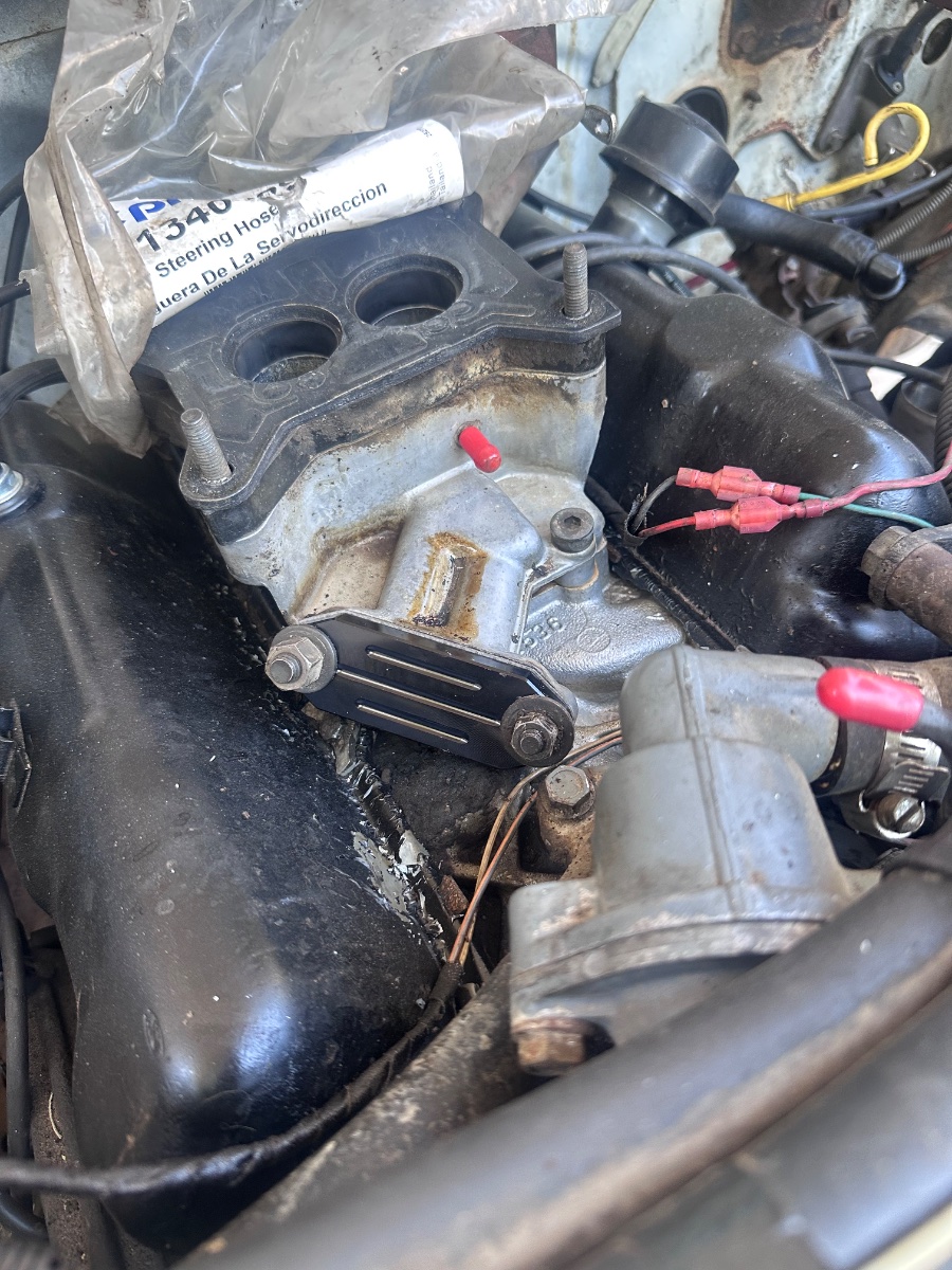

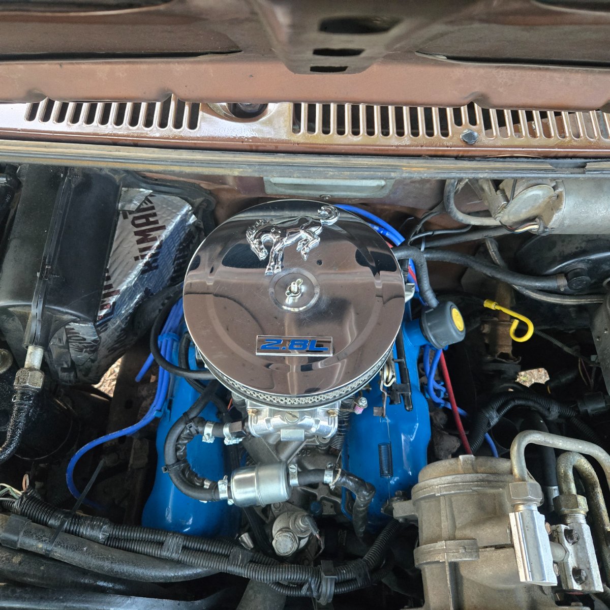

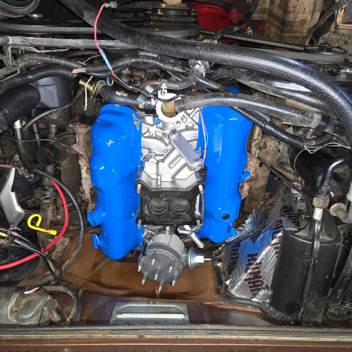

Blocking plate from china came and fits. Only 17$ too.
  • 85 Ranger V6 Restoration

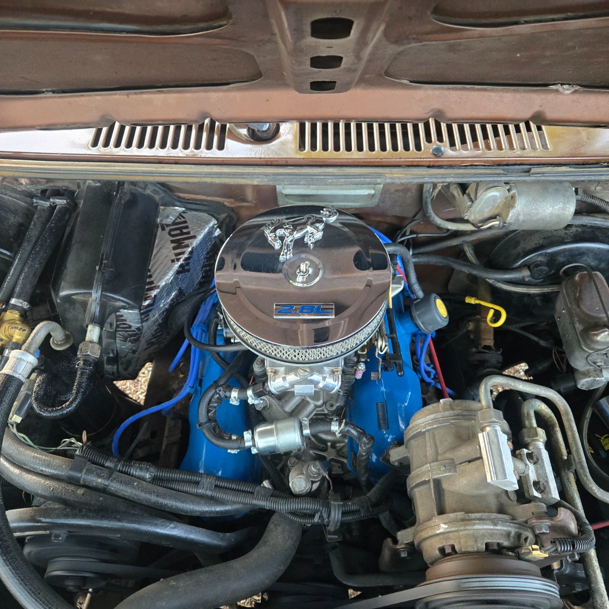

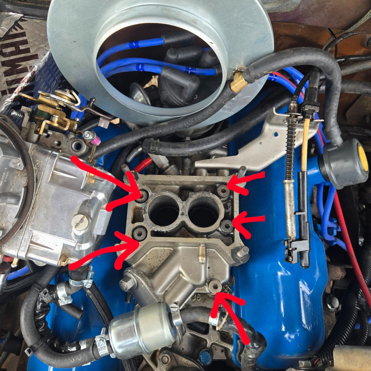

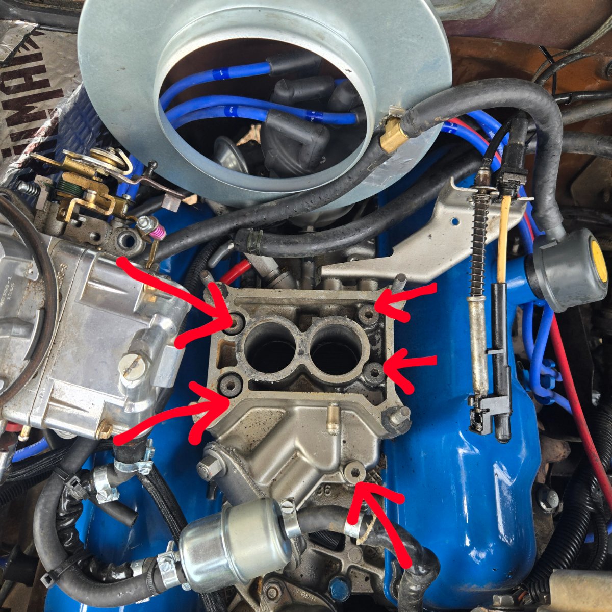

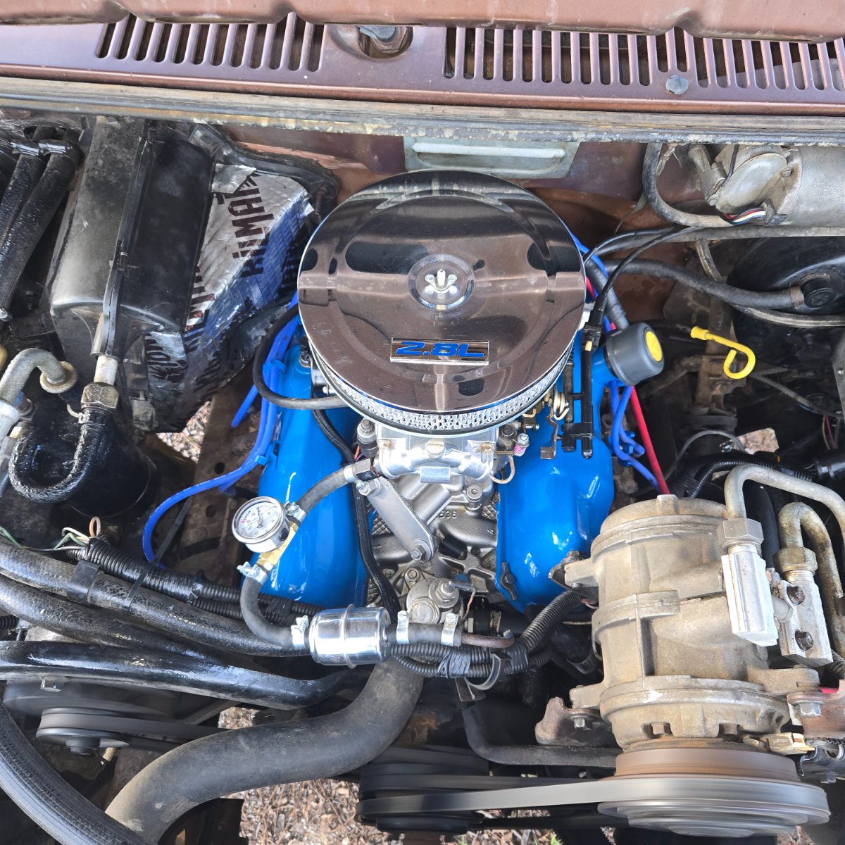

Virtually been doing the same thing! Just now seeing your thread. Awesome job! Here are some pics of my 2.8 rebuild. Bolts with red arrows came loose after first month of driving causing a bad vacuum leak! Retorqued with thread lock. Hit me up! I can help with any problems! I made my own EGR block off plate. Might invest in that one you got.

Ordered blocking plate for EGR
Does anyone happen to know what blocking plate fits the mechanical fuel pump? I want to remove it since it wont/ not

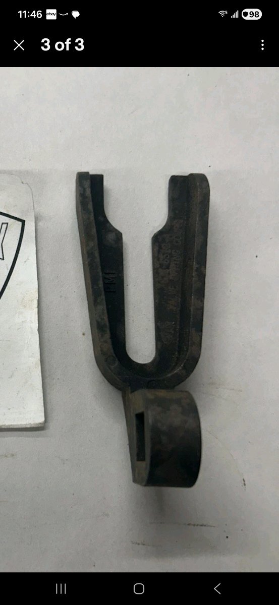

I found this tool on ebay to do my valve seals. Did all of them easily!
I love you for this recommendation.
Peep the kilmat! Looks really good. Ill have my engine bay clean soon!
I’ll definitely need to know where you got this. I’m about to remove all that from mine.

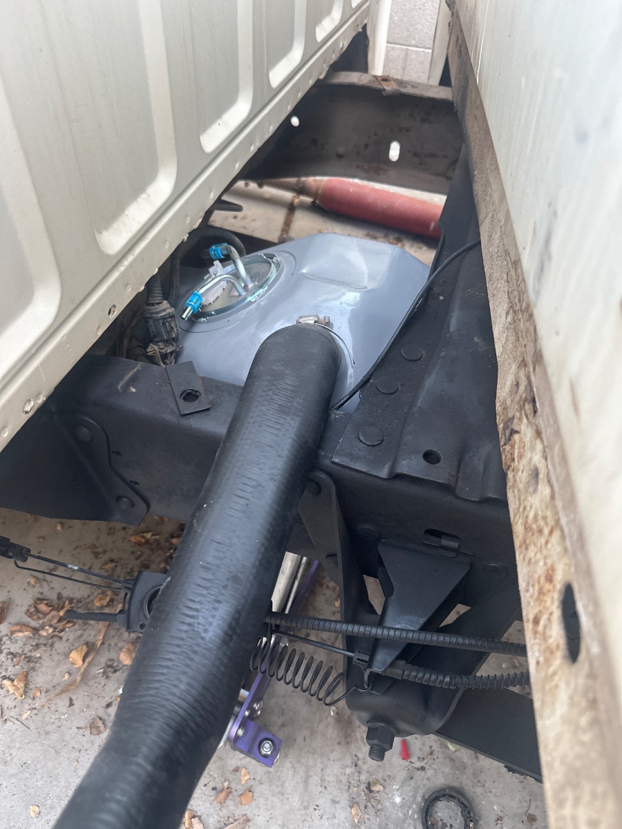

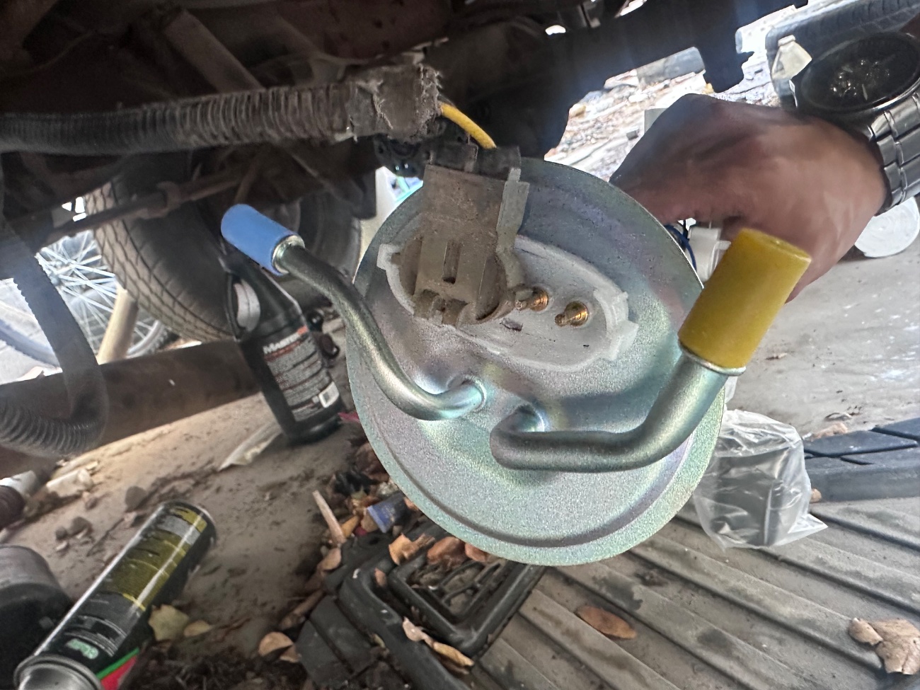

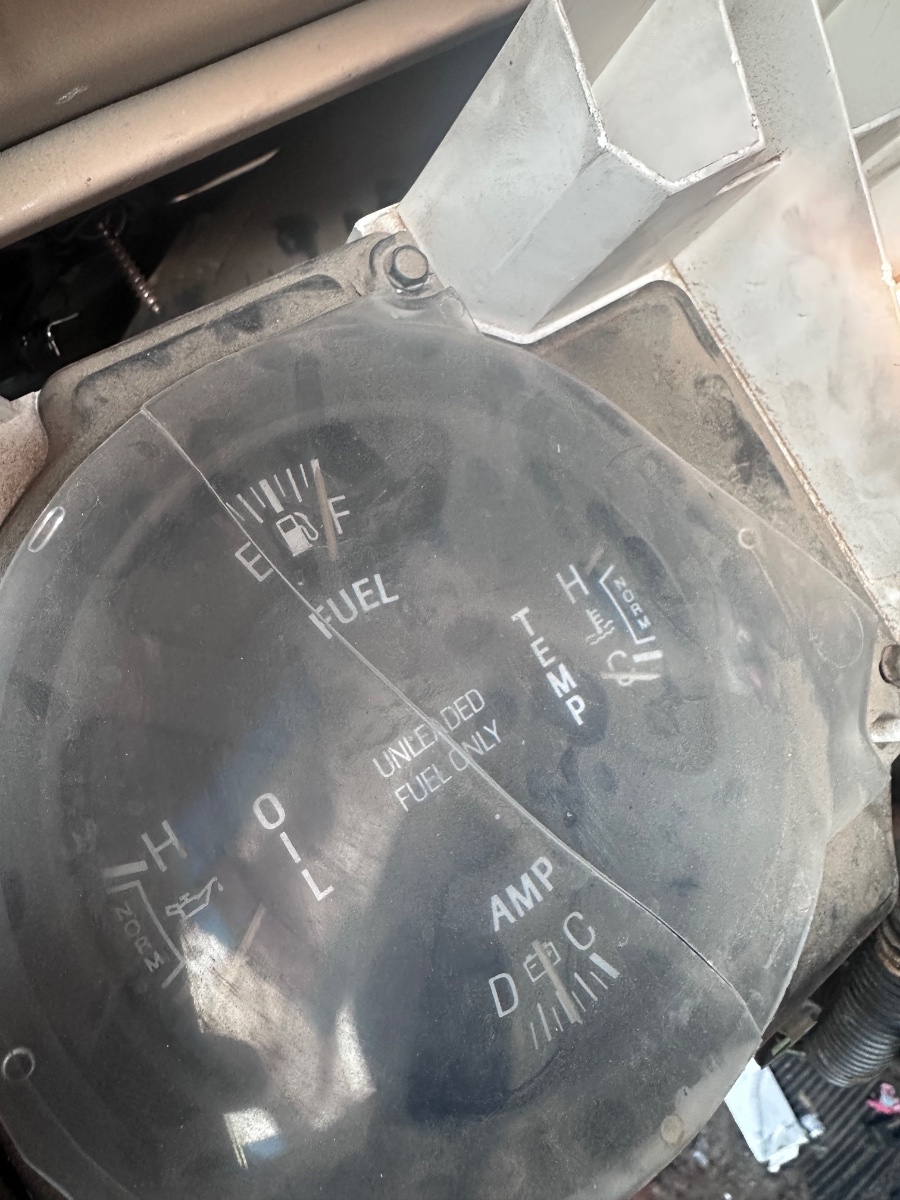

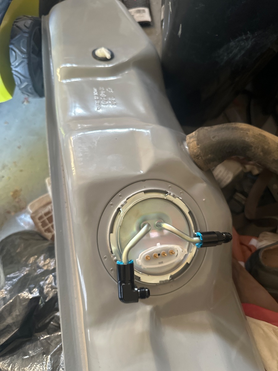

Fuel sending unit works and is installed. Managed to get by using the original 2 pin harness by breaking the retaining clip , but it fits really snug. Ill still end up getting the 4 pin connector so it doesnt look janky.

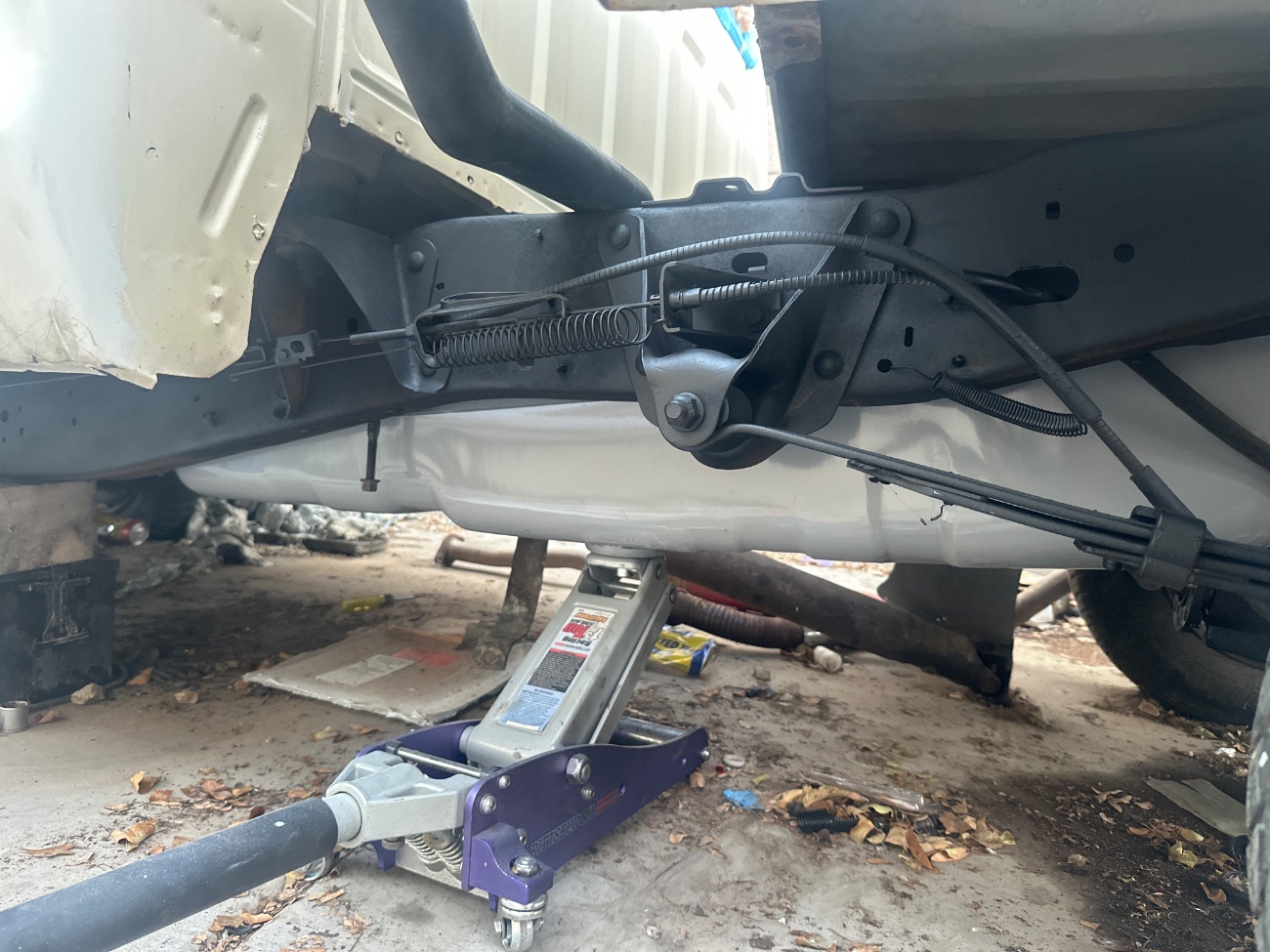

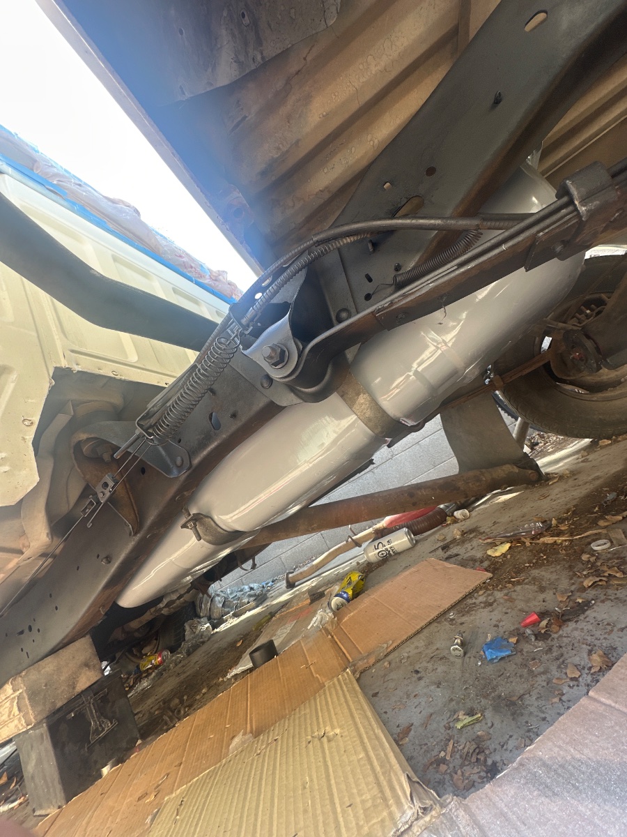

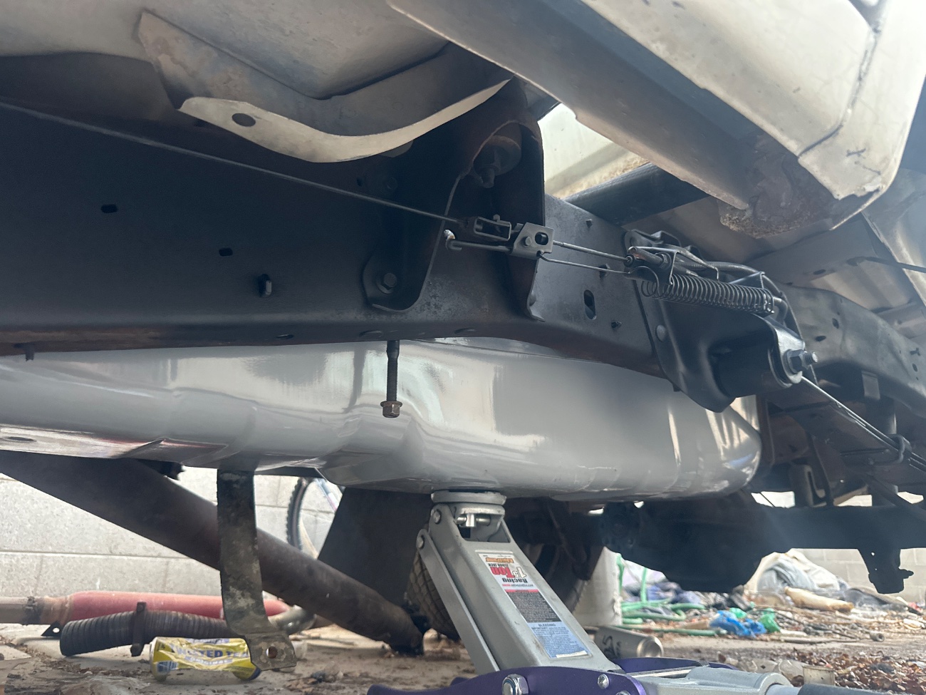

New tank?
17 gallon tank now with return style sending unit , still got the in tank pump 😏
So far pretty easy job, little at a time.
17 gal tank install complete, brand new bolt and lock washer 😎 just need to order kit and run the fuel assembly and do more wiring

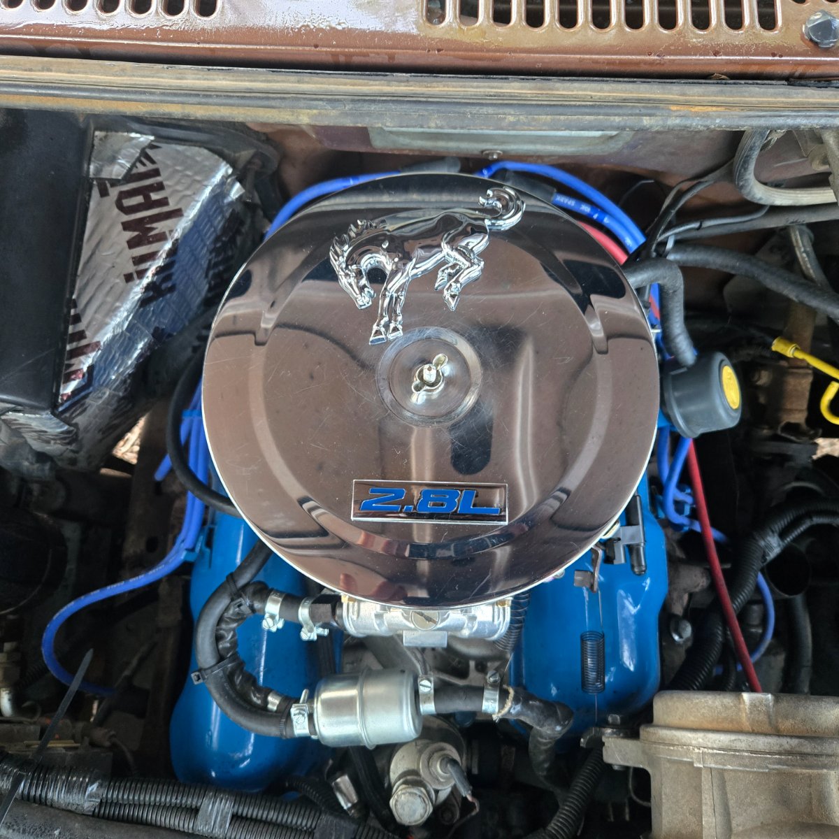

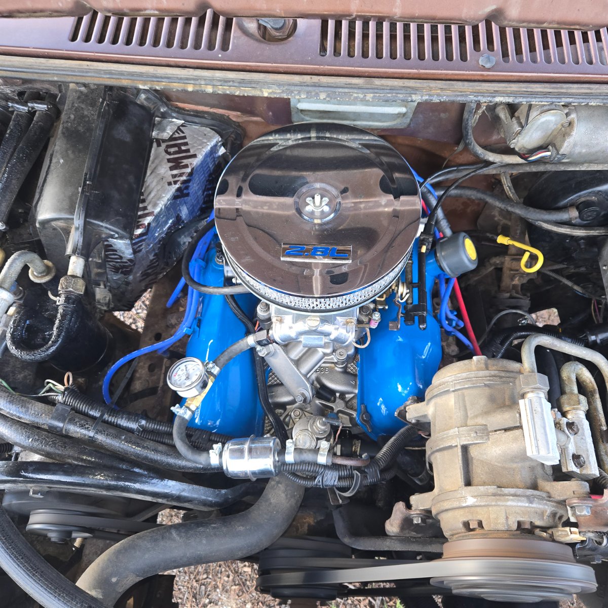

Did you do the Aces EFI? I have completed the Dura Spark conversion. My next step is to improve start and drivability with an ACES WILD 2300 kit.
Not yet, had to tidy up some stuff with the truck first. 1200$ is a hefty tag so im saving up then ill finance for it. Thats pretty much whats left on this truck for it to run and drive, other than tires.
I think once everything is together, instead of doing a traditional AC compressor i might opt into a electric one, quality air makes them for 400$. That way i wont have to source mounting brackets and other stuff
