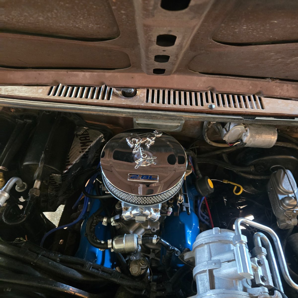

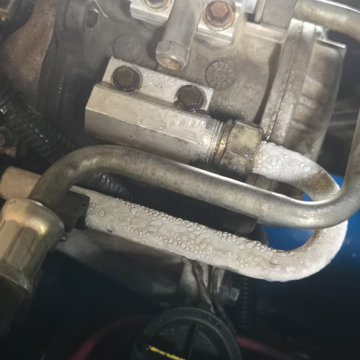

Just changed out my ac compressor clutch. Blowing 38* F. Now. Swapped out my Holley avenger 2300 jets from 63 to 58. Hoping to get better mileage!

LMFAO dawg am i tripping or you got your ac setup like a icebox?? 38F sounds amazing, just make sure your system isnt working overtime i suppose 💪
38F at the vents is reasonable for a top condition system. Wife's dad got his 97 F350 Somewhere under 40F. I can't remember what exactly.

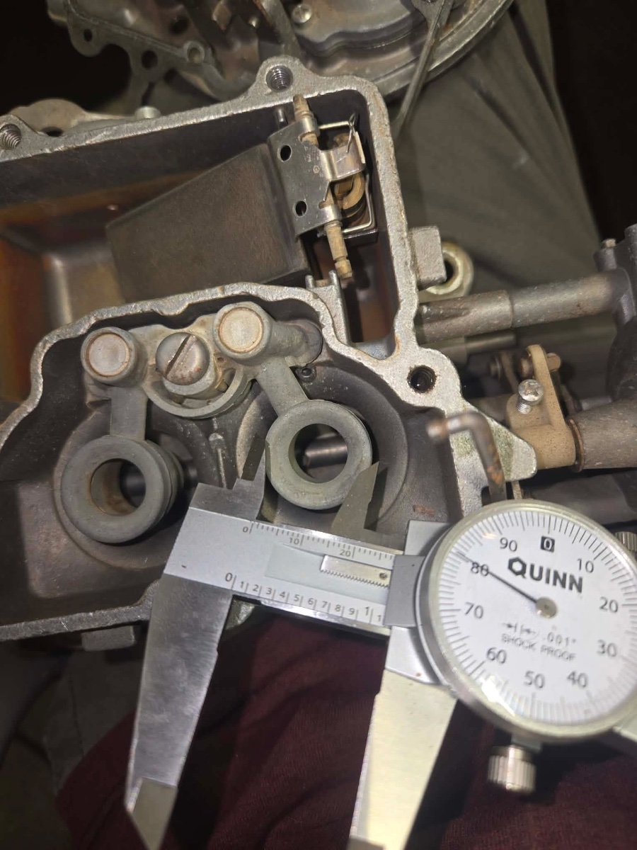

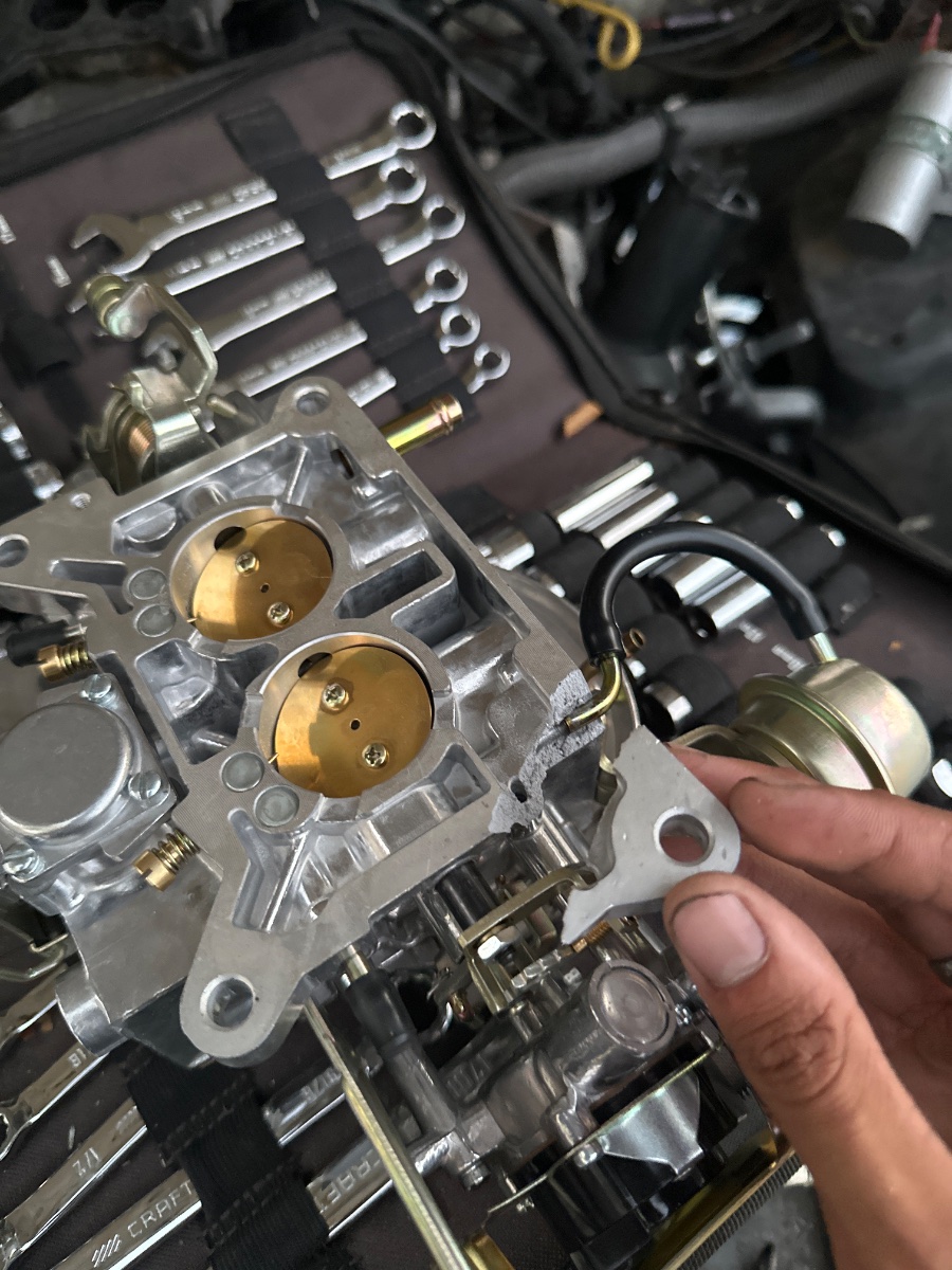

Update, bought cheap china carb so i can at least get this moving but 2nd one was trash.
Found someone local to me who rebuilds carbs and happens to have a non feedback 2150 1.08 venturi carb.
Once thats in place ill order ptfe lines and a new inline pump and pressure regulator so i can run a return style fuel system.
Honestly might just get it cleaned up at leave it at that and just use it as a service truck.

lmao not sure, got my refund. found someone who rebuilds carbs, you can find him on facebook as "southwest carburetor" out of tucson arizona. He has plenty of original 2100/2150 carbs.

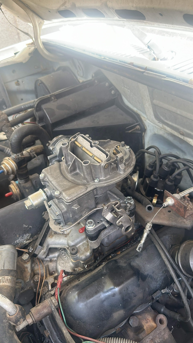

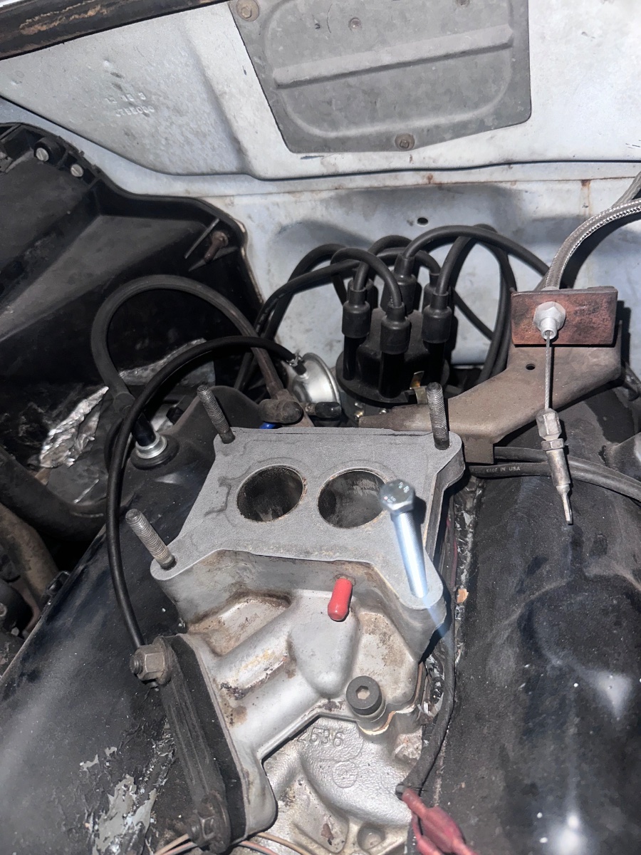

I want to add a throttle return spring, via
However seems like my stud isnt long enough, can i get longer studs or is it ok to run the carb without the spacer?
I messaged seller to see if he can make the plate not as thick maybe?
Link not working
EDIT: Might be eBay having issues.

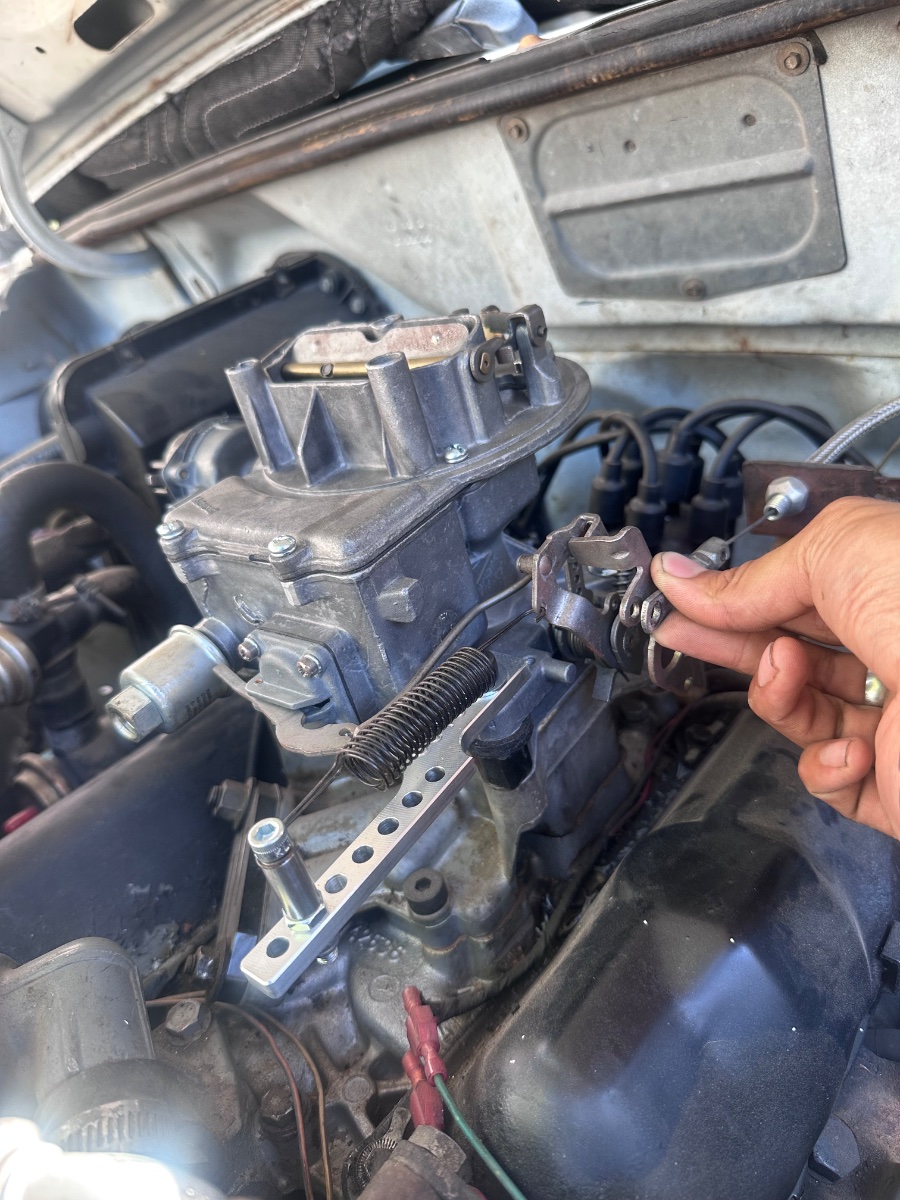

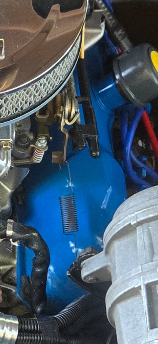

Here is what I did. Drilled a tiny hole in the A/C bracket.
  • 85 Ranger V6 Restoration
Confirmed it works for me.

@ISX_15 that's a chunky little bracket. You don't need anything near that beefy for a throttle return spring on these. Might want to try the Jegs or Summit kits (or Amazon/eBay equivalent) for the Holley 2 barrel carbs (2300 IIRC) since it uses the same mounting pattern as the Motorcraft 2100. They are less than $20 and much thinner.
At the time even the eBay homepage was giving it's version of the "something went wrong" page. Started working fine a while later, the homepage that is. Just now looked at the link again.
Im gonna try to see if he can make it much much thinner for me
But yeah i seen those kits i could do it for sure
Ended up just getting a long bolt, should work out to run the spacer + throttle return bracket + carb with this. Seller provides a bolt but its for the jeep engines so i dont want to chance it not fitting.
Throttle return worked out perfectly, had to make a little modification but its okay.
