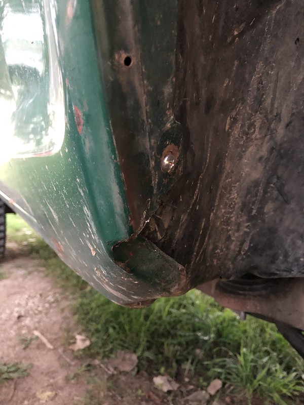

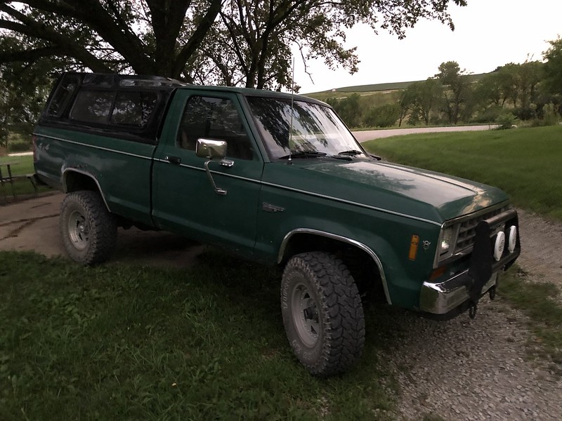

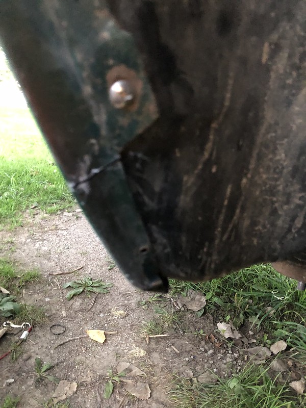

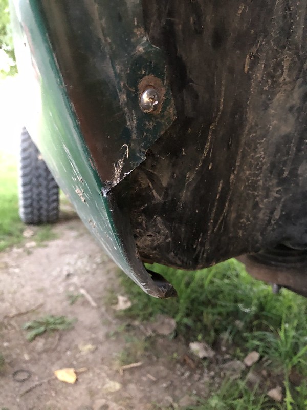

Modified my fenders so they cleared the tires. I just cut a notch with my oscillating cutter, pinched it with vice grips and then rolled it in to basically make the same kind of flange but farther back. Then reshaped it to flatten it out with a hammer.
Bounced it thru the washout at the end of the driveway and hit the approach to the barn a couple times and couldn't get it to rub at all.
