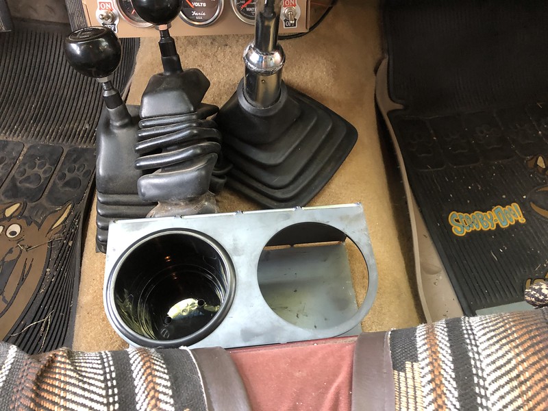

Anyway, a week late but my cupholder is cut out:

Very nice! You did all that by hand with a drill, hacksaw and file, didn’t you?

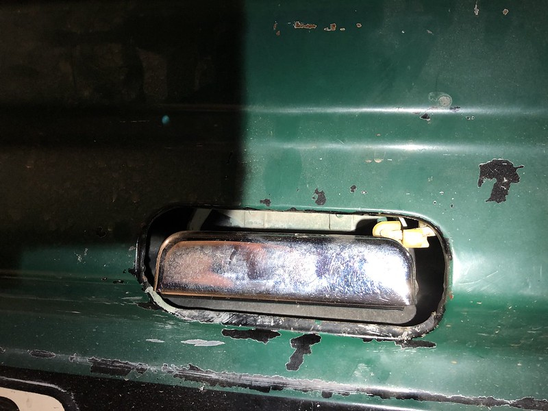

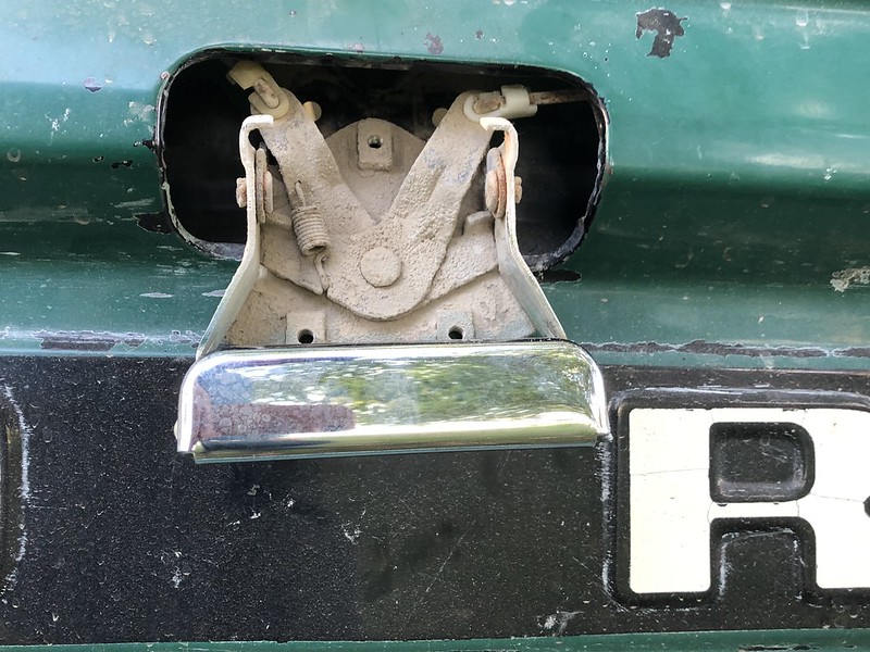

Got home Monday night and pulled the necessities out of the truck. Mainly our two suitcases, the cooler and the bag of snacks. I went to get the tent out day before yesterday and the tailgate would not open. I did a little investigating and found the plastic clip broke on one of the rods.
'85 Ranger Restomod
Three bolts and the handle drops out, easy fix.

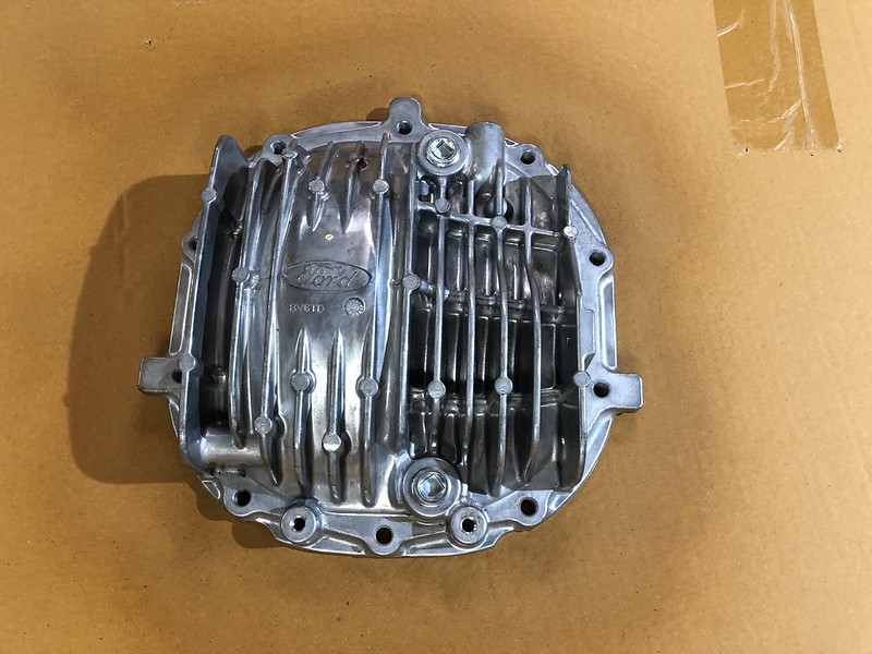

Checked the axles, front axle oil looks new. Rear axle is dark and thin, still smells like oil/good but not 85/140 consistency. Both levels were spot on. I need to finish my GT-500 diff cover and just change the rear axle oil.

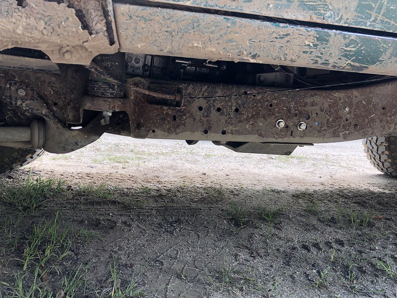

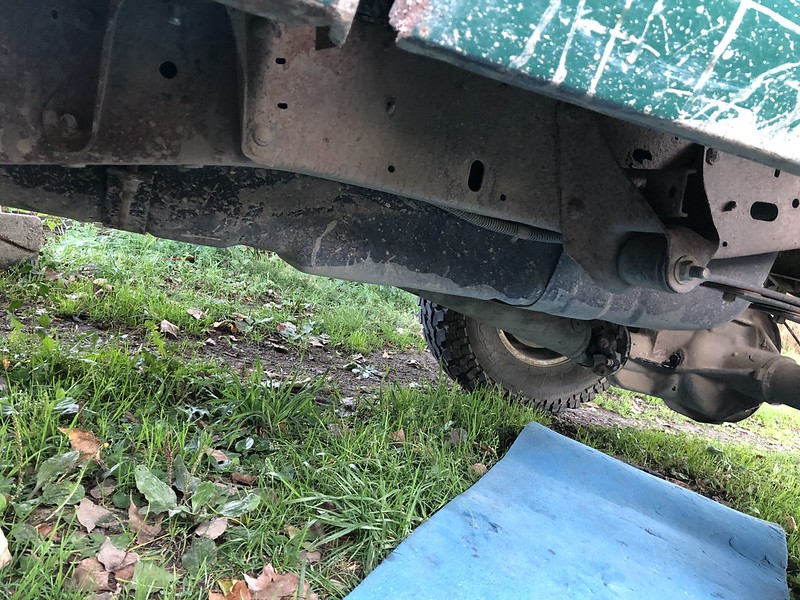

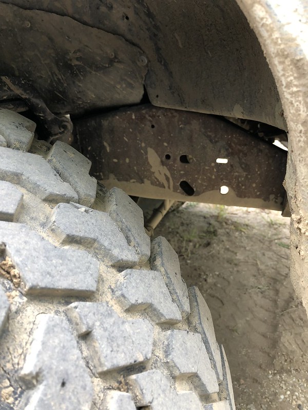

Water lines are consistently about that high as shown on the fuel tank, about half and inch of the forward frame too.

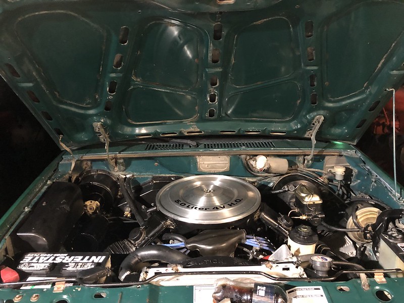

Cleaned the engine bay:

And test fit the cupholder:

Around Albia on the way home I noticed it was running a hair warm. Not really hot but instead of running its usual 195* it was a tad over 200*. It was mid 80's so it was one of the warmer days of the trip. I stopped and checked the coolant level at supper that night at Albia. Level was fine and it wasn't that far out of the norm so we continued on, hit a cold front and some light rain and it cooled down to normal.
While checking oil levels I noticed this, that won't help cooling any.
'85 Ranger Restomod
I have always hated the flex hose. I had a shorter one on it for years until I did the body mounts, I noticed it had almost rubbed thru on the steering box. So I got a longer one that swooped down more and missed that corner of the steering box. I suppose the hose got nice and supple on the drive and the wire shifted, it actually feels like it is broke where the crease is. I tried to squish it open with a ziptie to aid in troubleshooting which did nothing.
4.0 radiator has that stupid angled outlet so fearing the worst I bought both a '94 Explorer lower hose and a '01 oil cooler delete 5.0 Explorer radiator hose and a hunk of 1.5" pipe figuring I could splice something together.
5.0 Hose on its own ain't gonna work.
'85 Ranger Restomod
I get to poking around with the part I trimmed off...hey we might be on to something.
'85 Ranger Restomod
'85 Ranger Restomod
'85 Ranger Restomod
So moral of the story... I shouldn't have settled for good enough years ago.

I finally got the rib ground down that is supposed to interfere with the tone ring on my diff. After various die grinder bits a flap disk on an angle grinder was the way to go.
'85 Ranger Restomod
Also got it clear coated. Now I just gotta remember what I did with my ARP bolts...

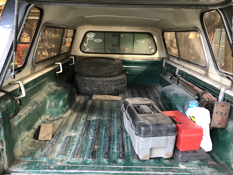

5. Spare Tire - It would be nice to make a bumper with a spare tire carrier so i can get the tire out of the back of the truck.

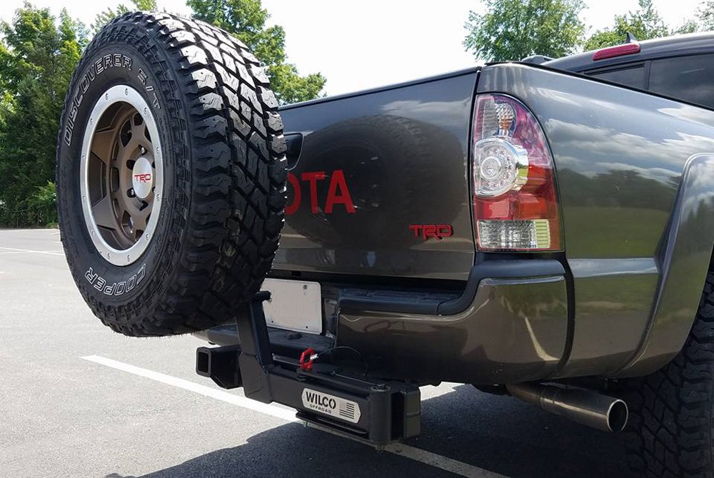

I have a B2 tire carrier here. Wanted to adapt it to my bumper, but decided against it. Also have a spare under bed carrier here. Pm me if you want either of them
I have been thinking about these:
Here is what I have for a tire carrier:
I think my spare carrier is in one of my dad's sheds yet, I don't think it would work with my exhaust at any rate.
The hitch to what I want is I don't mind the look of it with the topper, I think a pickup with just a box looks kind of goofy with a rear spare so i want it to be removable.
I agree. That's why mine turned out the way it is. I just didn't like the look of a vertical rear spare, at least not a 35" diameter spare.
Your receiver mount is what inspired me but for what I am doing I gotta keep the tailgate and I gotta be able to open the tailgate and back window preferably without wrestling around pulling the spare tire carrier out of the receiver.
