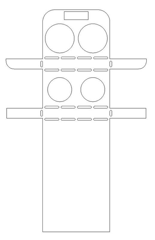

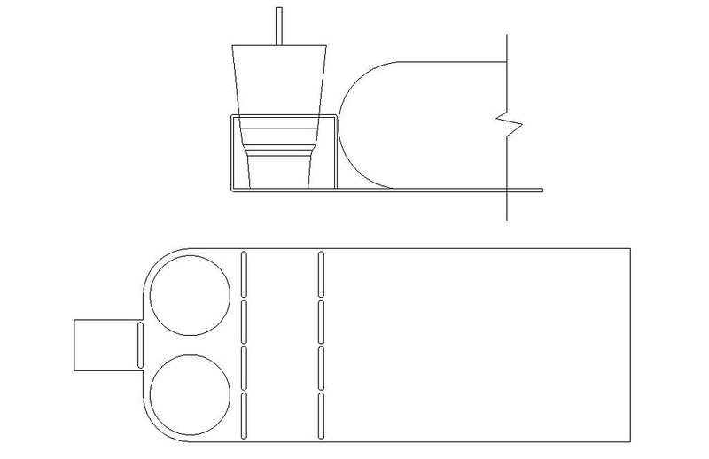

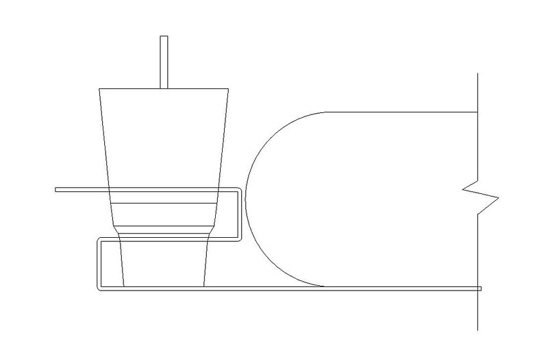

I have been thinking on the cup holder situation in this thing. Seat mounted stuff is a no go because it interferes with shifting, I have too many shifters on the floor it work with off the shelf floor mount stuff. I could cut one down and make it fit but it would have no stability. I did notice the seat was really close to the floor, I can't get my fingers between the floor at the tranny hump and the seat so that would be a good anchor point if I could get something to stick between there. Using a 32oz gas station foam cup (from Casey's) I came up with my own solution:
'85 Ranger Restomod
All folded up with the side flaps omitted:
'85 Ranger Restomod
It will have to be thinner metal than my gauge pod so I can fold it with the multiple folds. The side flaps are so I can weld it together to create one rigid big block. Rectangular hole will fit a smartphone but it was mainly intended for the case to my sunglasses clip. Plastic fast food cups are smaller than the foam, a 28oz Gatorade bottle will fit thru the first hole which is how they work with the factory cup holders in my wife's car. Since they reseal with lids I don't consider that a big deal.

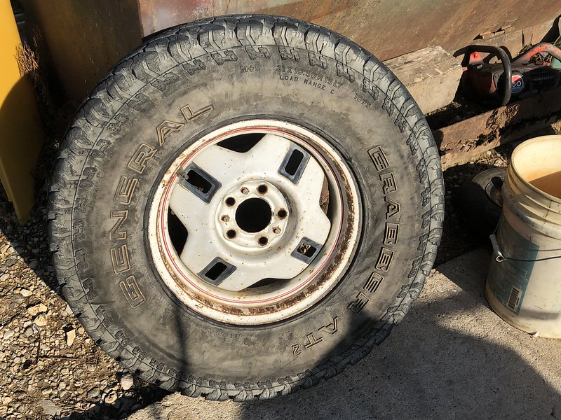

Spare is mounted:
'85 Ranger Restomod

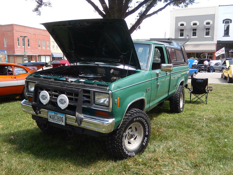

Truck is washed, prepping for annual car show this weekend (my once a year reason to clean the thing)
'85 Ranger Restomod

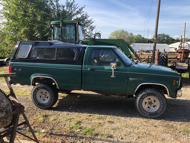

'85 Ranger Restomod
This year we featured vintage campers. Since there is no way I can compete with the classic cars in my club for a host class trophy I decided to try to lobby the vintage camper crowd for their votes by making my own vintage camper.
'85 Ranger Restomod
And of course that failed miserably because only one vintage camper showed up.

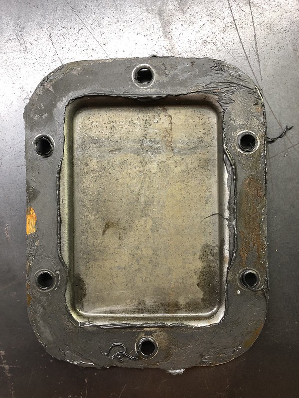

Found out why my t-case would seep when I drove it but not when it was sitting. There was a little channel in the silicone that didn't fully make a seal and thus would allow a leak as the gears threw the oil at the cover.

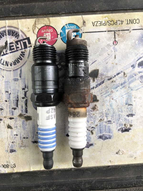

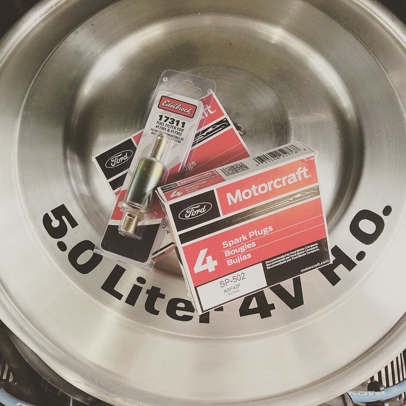

I think the t-case is buttoned up, it is staying dry for now anyway. I did a tune up on it yesterday, it was kind of fun changing all 8 spark plugs AND the fuel filter for about $30 and in less than an hour:
'85 Ranger Restomod
I have noticed some slobbering below the headers, I didn't now if it was valve cover seepage and the headers just kept it cooked off or what. So I change the plugs and the new ones that both the manager of O'Reillys and Rockauto say should fit my heads look totally different than those that were in the truck. Looks like the seepage was because there was no way for the plugs to properly seal. And then they protrude a lot more too. Looks like they were running nicely otherwise though, all 8 had a nice toasted marshmallow look to them. They haven't been out of the truck since the head swap in 2012.

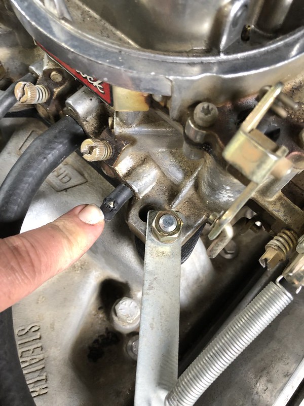

I also noticed my rubber vacuum cap must not like engine heat:

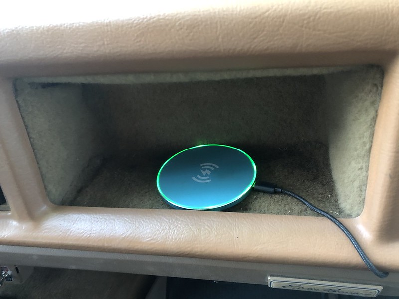

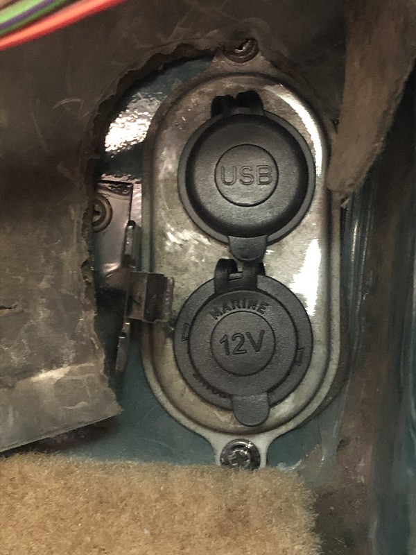

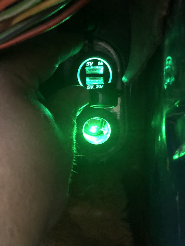

And we are officially in the 21st century! USB chargers galore AND wireless charging!
'85 Ranger Restomod
It works good on smooth roads. Rougher pavement or gravel not so much as my phone moves around. I also added a 12v power port that is ran with the key so I don't have to keep plugging in/unplugging the GPS.

A rubber band goes well with the wireless charger.
Hopefully there won't be much for rough county highways and gravel on our trip. After the trip the charger can go back beside my computer at work. Gonna have to find a rubber band now just in case though.
In February, the charging port on my phone died while I was on a trip. A quick stop at Walmart for the cheapest wireless charger they had plus a bag of rubber bands kept me on the grid until I could get home and swap it under warranty.
