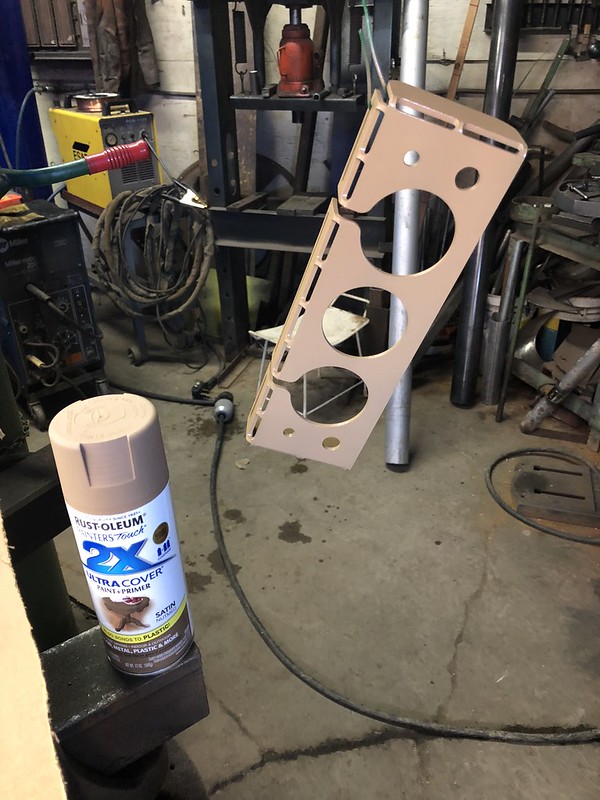

Painted the gauge bracket:

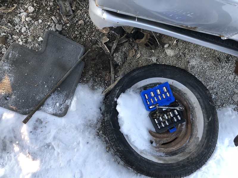

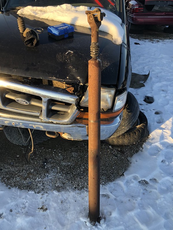

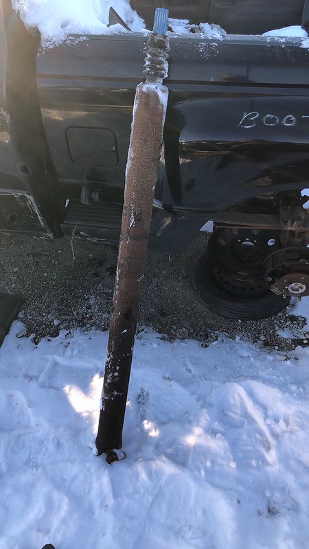

Hit the JY today, couldn't believe what I found in the back of a truck:
'85 Ranger Restomod

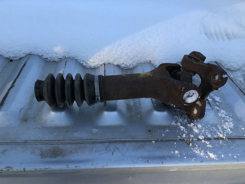

Crap, whoever took the powertrain took the yoke too. :annoyed: Scraped the ice off the best I could with my knife and could see no damage, propped it up in the sun while I looked for another yoke.
Found a yoke, it was a fight. Couldn't get the yoke off without dropping the whole bent in a U shape driveshaft. Did a pull up on my little ratchet and had to scrounge for a cheater pipe. Little peice of Dodge jack hardware proved its worth. Neither yard showed anything old online and driveshaft searching had been a bust for 6 months so I was packing light and only had my little 12pt socket set/ratchet with me (and my leatherman of course)

Bingo, my $23.50 driveshaft that only needs shortened now:

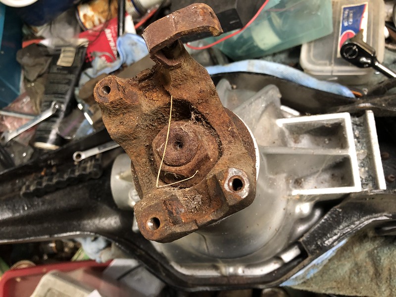

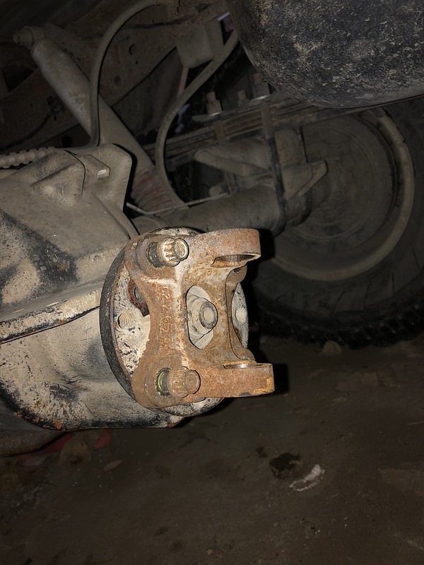

Tapped the front flange off, slight upgrade over what I had (for the rear anyway)
'85 Ranger Restomod

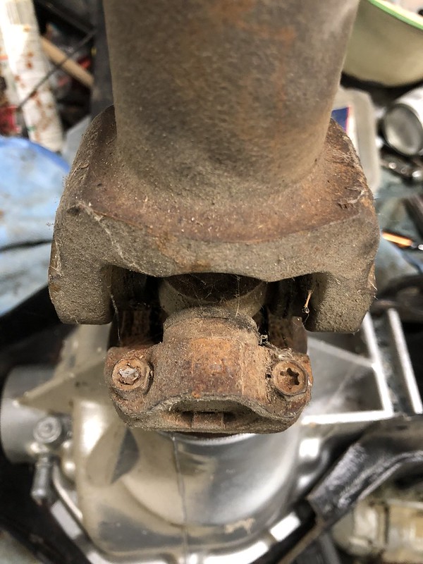

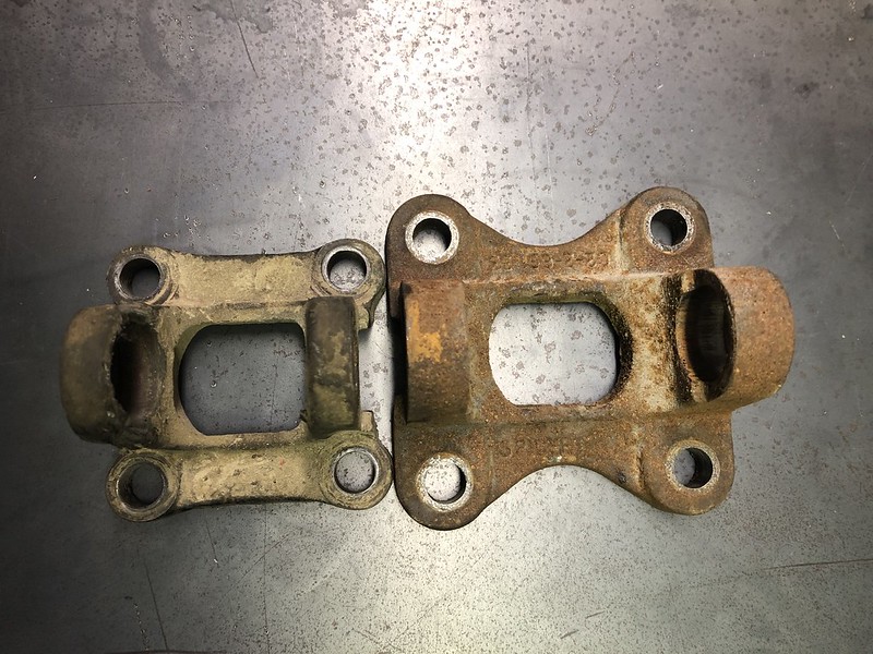

I had previously researched cross sizes, a '96 Explorer and '77 F-Series both use 1310 crosses for the rear, '95 Ranger uses the same for the front. Didn't think much more about it, kinda assumed a '98+ would be the same as the Explorer. I was taking off my flange and thought it looked kinda big so I measured it, bigger than either. Looked up a '99 Ranger 4x4 on Rockauto and it uses 1330 crosses. Crap, did a bing search on the difference between a 1310 and 1330 to see how screwed I was and a TRS write up on crosses (which was awesome) came up, gotta use a conversion cross for the front but it didn't say anything about flange bolt patterns changing which made me uneasy so I checked:
'85 Ranger Restomod
https://www.therangerstation.com/ho...r-case-driveshaft/all-about-universal-joints/
Ok, just gotta run a 1310-1330 conversion cross on the t-case end to adapt the "puny" Ranger 1330 shaft to he "beefy" 1310 NP205. 1330 will end up on the axle end (usually more problematic than the front one) so that will work out for the better.

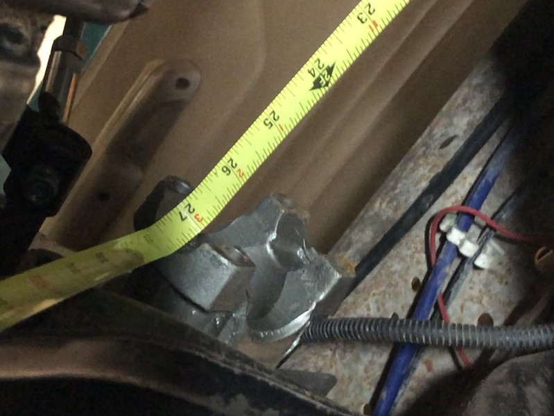

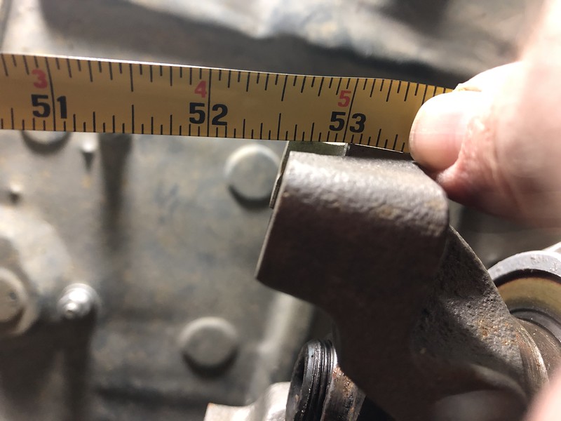

While there I measured the rear driveshaft, the stock '99 shaft measures 61":
'85 Ranger Restomod
And the front:
'85 Ranger Restomod
If I could get that front stub off the front diff I could get the front shaft done while I am at the driveshaft shop...
'85 Ranger Restomod
POS worthless screw will not come and it was freaking cold in the garage so I adapted and overcame. It will need dealt with but isn't holding me up for this project at the moment now. Gotta remember to knock an inch off for when I get the D35 in:
