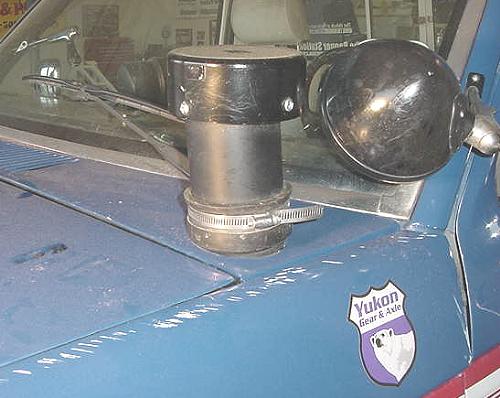

That is pretty clean, looks a lot better than the homemade ones that go out the fender. I don't think I have ever seen an underhood shot of TRS1 so that is an added bonus too. :icon_thumby:

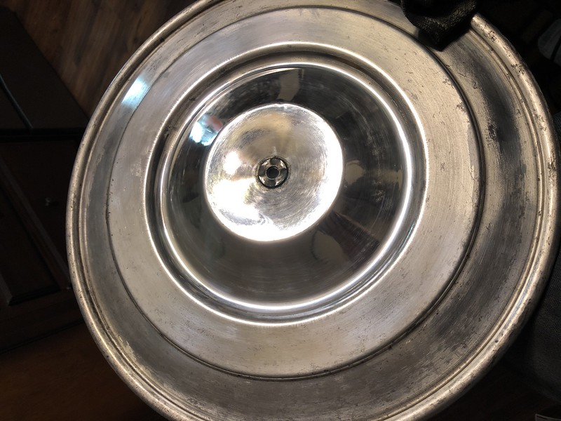

Air cleaner lid polishing was a good snowy stuck in the house weekend project and is progressing nicely.

Air cleaner lid polishing was a good snowy stuck in the house weekend project a:
I refuse to ever be that bored but I applaud your efforts at beautification.
This message composed solely of recycled electrons. Go green!
That's about an hour with a dremel, buffer wheel and mother's wheel polish. I might have another hour into it before I am ready to swirl it.
If I could find a lid ready to go I would have, the regular Mustang ones are stupid priced. So I am polishing out 30 years worth of stains and oxidation so I can chuck it in a drill and redo the original brushed finish.
A new chrome Saleen lid is $80 but I like the brushed aluminum look better. And yes I am going to clear coat it so I don't have to go thru this again.

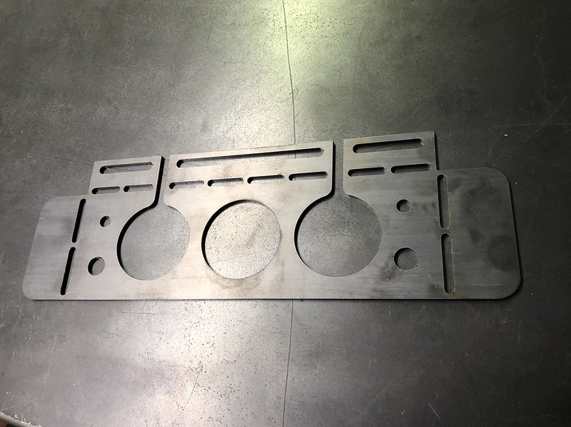

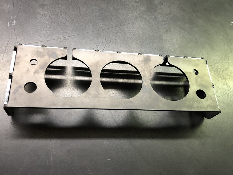

Buzzed down to the local fab shop and picked up my gauge pod:
'85 Ranger Restomod
Was a little skeptical when he handed it to me, didn't know how it was going to bend. It is a little thicker than I had imagined. Went pretty good though and is plenty beefy.

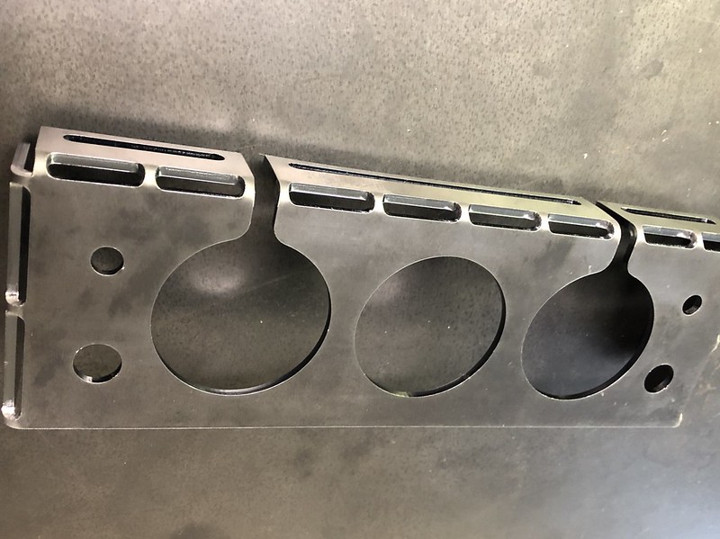

How thick is that material? That looks intense.
1/8"
It wasn't bad to bend by hand though, not really any complaints with how it worked out.
14 gauge would of been plenty lol but looks hardcore!!
Those notch outs on the bend lines will really help.
Sent from my SM-G930W8 using Tapatalk
It is a quarter inch between the slots so there is 3/4” of meat on the outer mounts and 1-1/4” on the center.
I got the notch idea from pen holders they made, for low stress stuff like this they work great.
