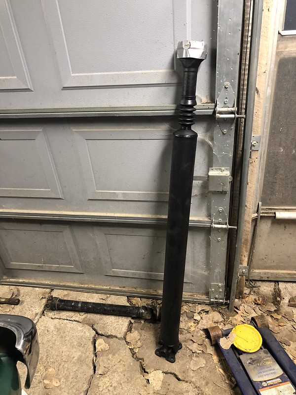

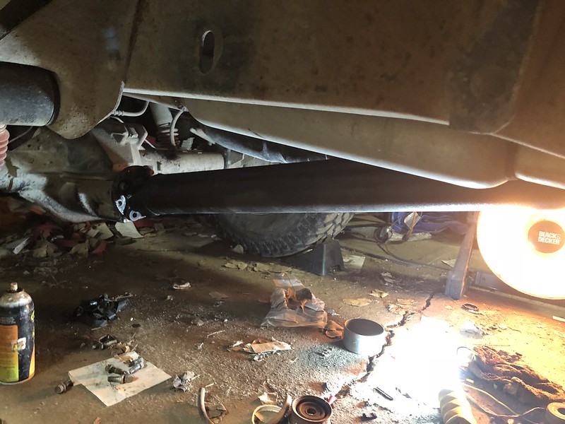

Driveshaft is home:
'85 Ranger Restomod

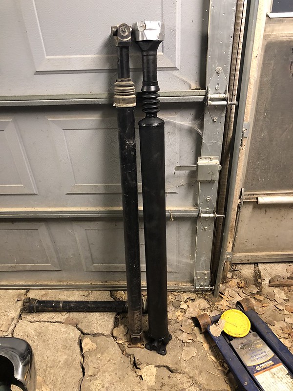

Slightly more substantial than what I had:
'85 Ranger Restomod

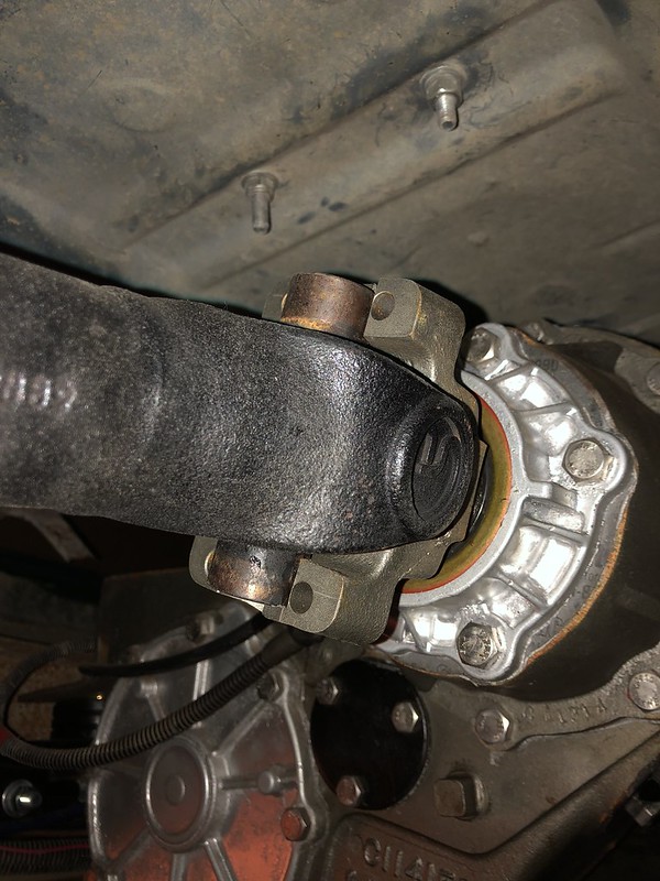

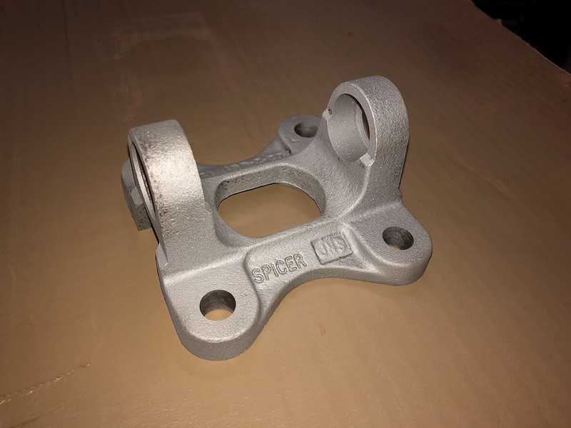

Chased the pinion flange holes to clean out 7 years of gravel dust and stuck the shaft in:
'85 Ranger Restomod
'85 Ranger Restomod

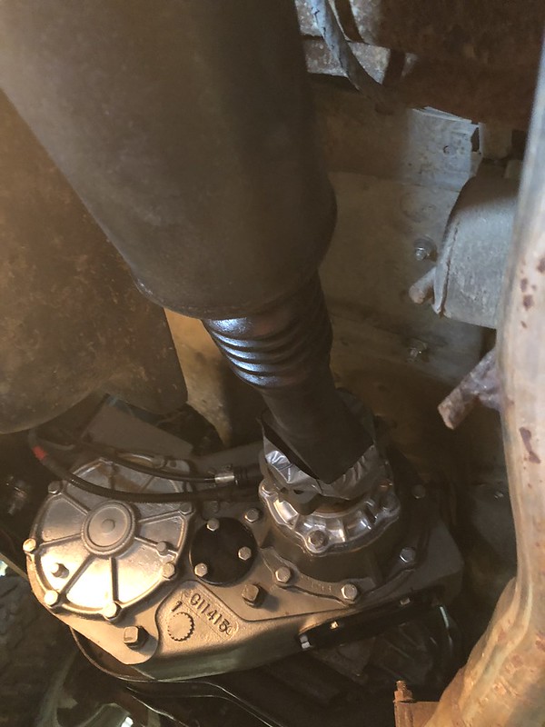

Sure fits nice at the t-case, what is that for a deal? Get this tape out of the way...
'85 Ranger Restomod
Apparently my t-case is from a '250. I had just looked up a F-150 which only called for a 1310 cross. F-250 calls for a 1330. :yahoo:

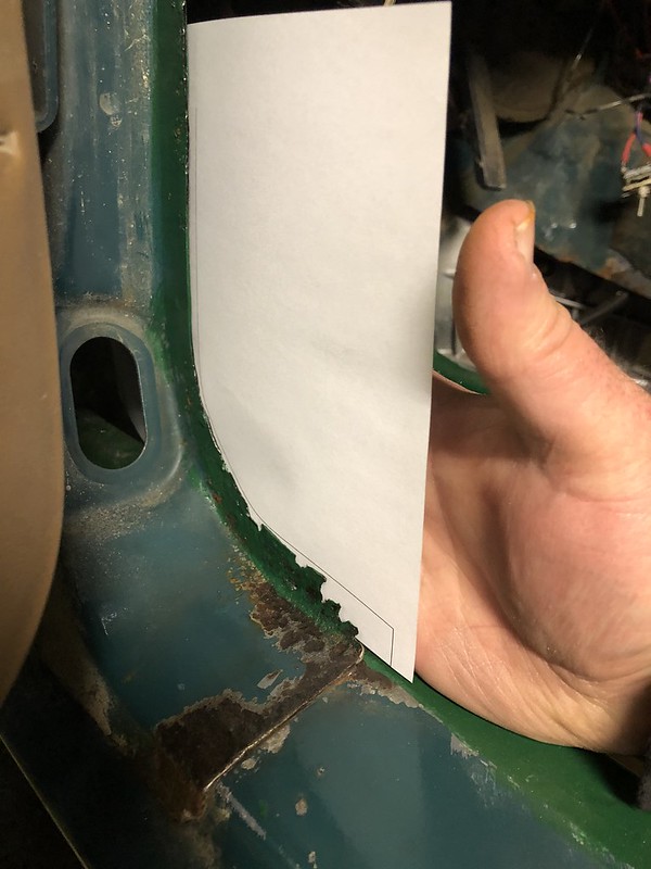

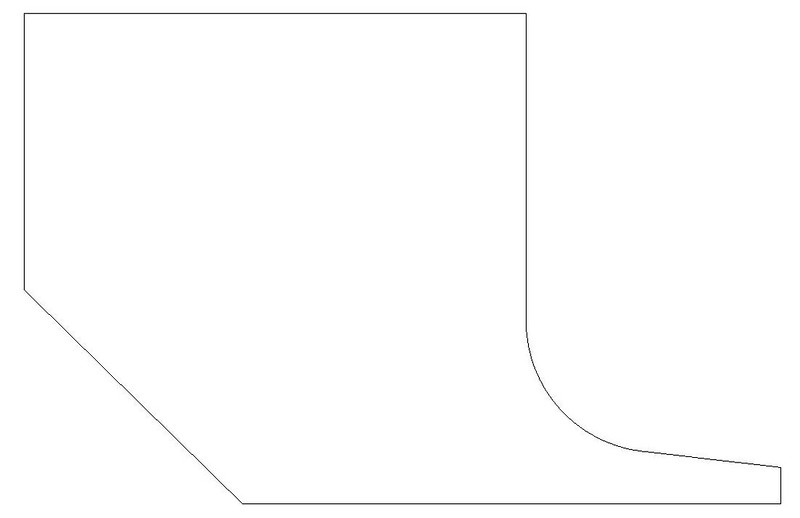

Due to some unforseen circumstances at work I drew up my torque box patch to have it burned out.
'85 Ranger Restomod
Take plenty of pics on that torque box. I'd love to see how you lay the panel in and weld it up. I have to do that with my 87 sooner or later..

This is the patch I have drawn up:
'85 Ranger Restomod
Its more than I need but it is easier to make it smaller than bigger after it is cut out.

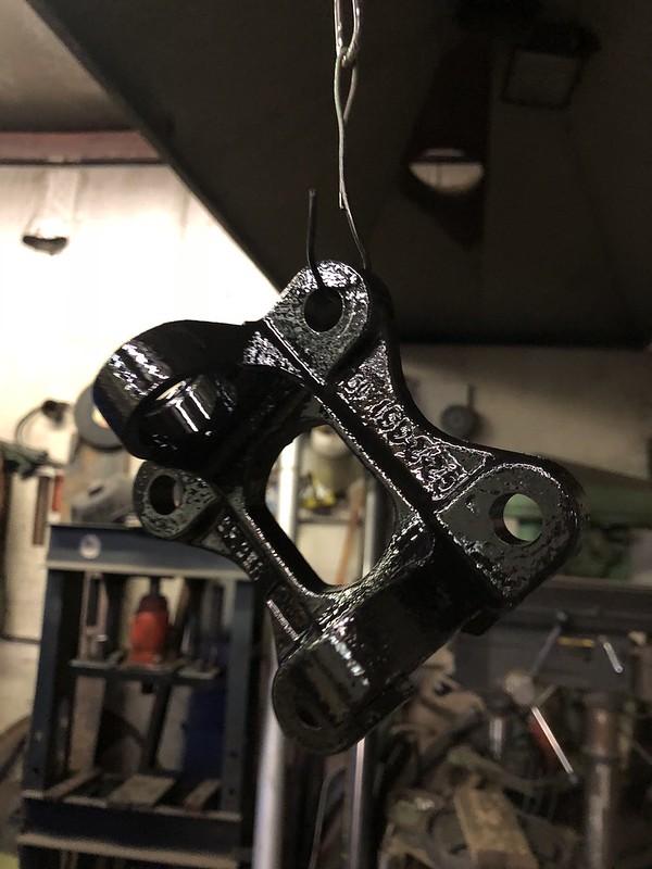

I went ahead and knocked the crosses out of the driveshaft, cleaned up the flange and threw some paint at it.

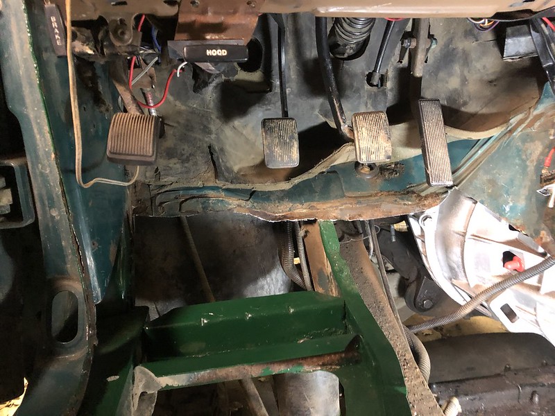

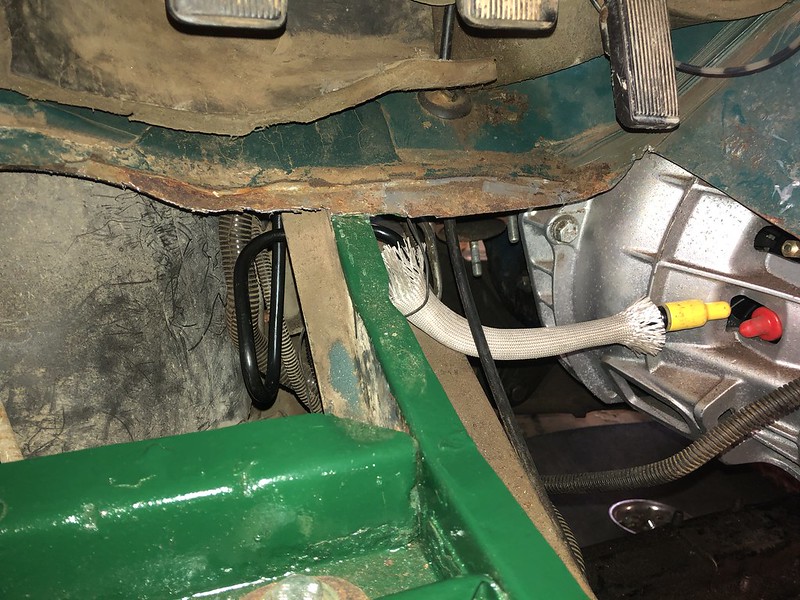

And it took us 34 years but we finally sprouted a fourth pedal! :yahoo:
'85 Ranger Restomod
I decided with a driveshaft in hand the truck is only the clutch hydraulics and LH exhaust pipe away from being self propelled, might as well go for it.
Also hooked the battery up to test the starter and starter wiring, it all worked/sounded good so that mystery is solved.

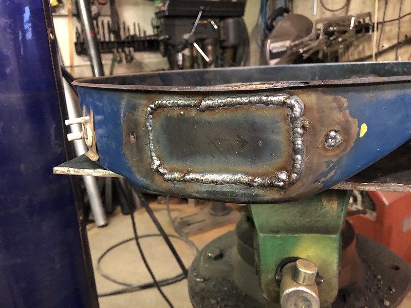

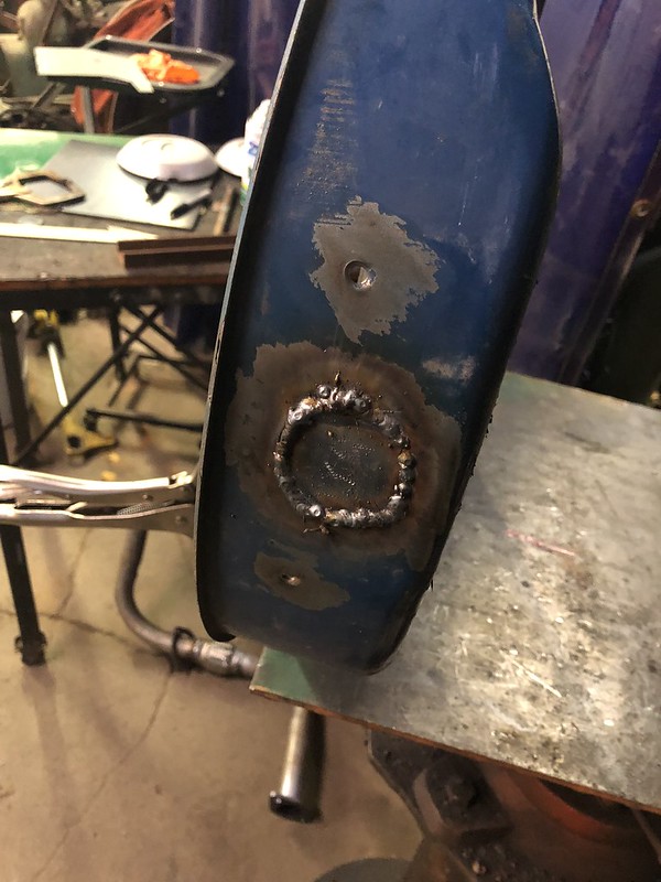

Air filter housing is welded up:
'85 Ranger Restomod
'85 Ranger Restomod

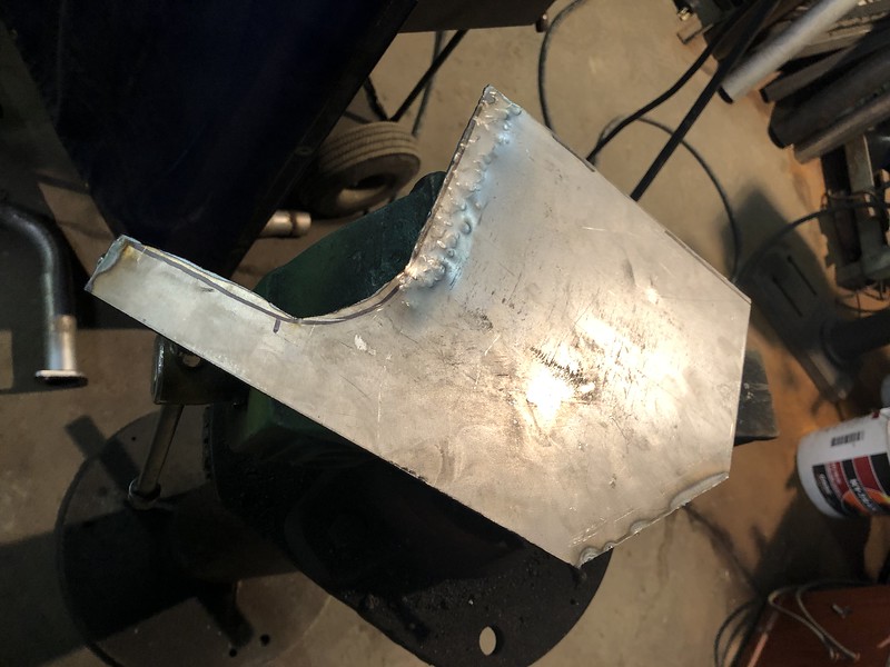

Torque box is cut (by hand, not CNC)
'85 Ranger Restomod
Needs some trimming, it is a pretty good start though.

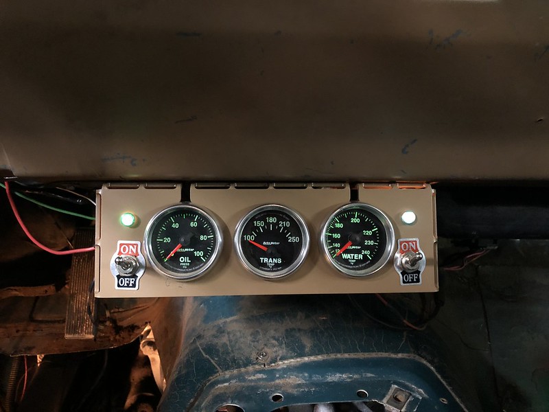

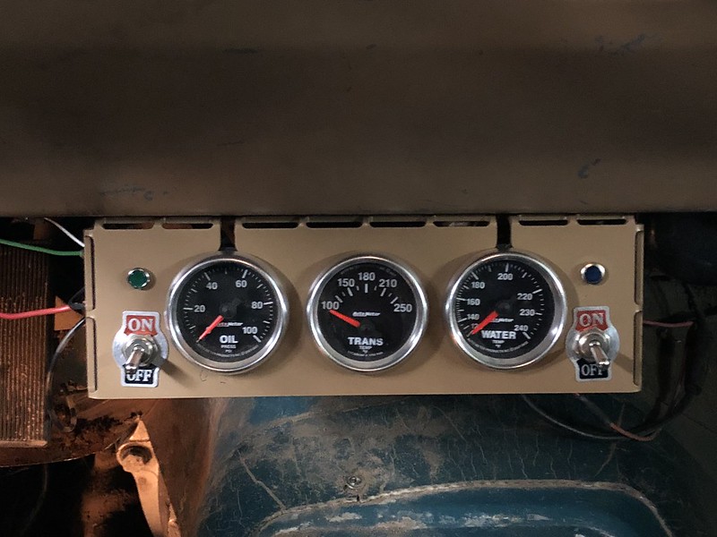

And installed gauge pod:
'85 Ranger Restomod
'85 Ranger Restomod
U-joints are changed in rear driveshaft, it is bolted to the pinion and sitting in the t-case yoke. Carquest gave me the wrong u-bolts to finish that. I found some in my JY toolbox but I need to get nuts for them.

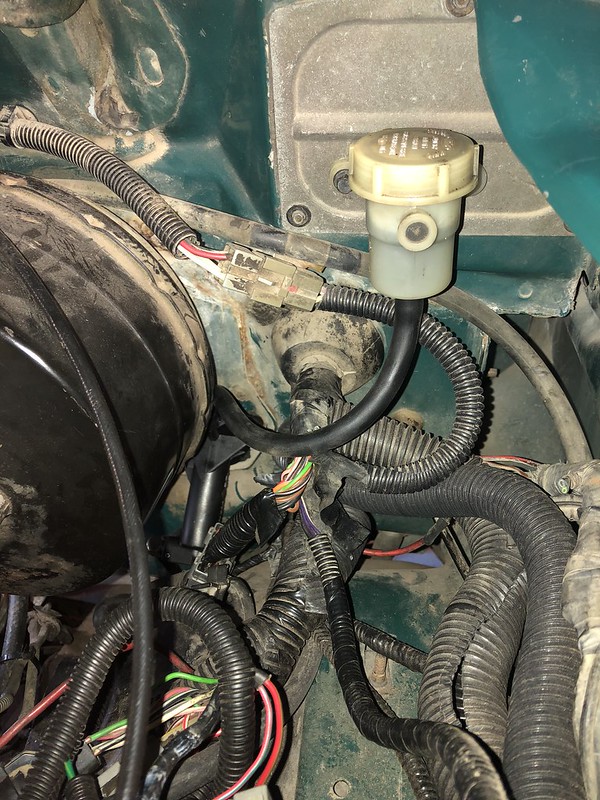

Wife had to work Christmas Eve so I was unattended... I got the cutch hydraulics mostly installed. I need to hook it up to the pedal and the trans yet, had a Christmas party that night and didn't want to mess with it and was running out of time.
Felt kind of silly, went in the house to get my drill, sized a bit to mount the reservoir... the "knock out" dents in the panel are actually holes with the foam insulation behind them so no drilling required.
'85 Ranger Restomod
So nice not having a floor in the way... I would probably still be trying to figure it out, its kinda weird how it straddles the frame.

Oh the V6 models it's really important how it straddles the frame. Ask me how I know.
