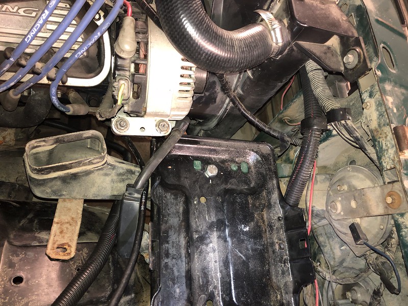

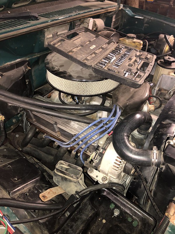

After a 8 year hiatus the 2.8 intake tube is reinstalled:
'85 Ranger Restomod
I like the angle of the elbow but it is getting kind of close to the air filter housing. Not sure I will have room for the accordion tubing. My elbow is pretty much shot too.

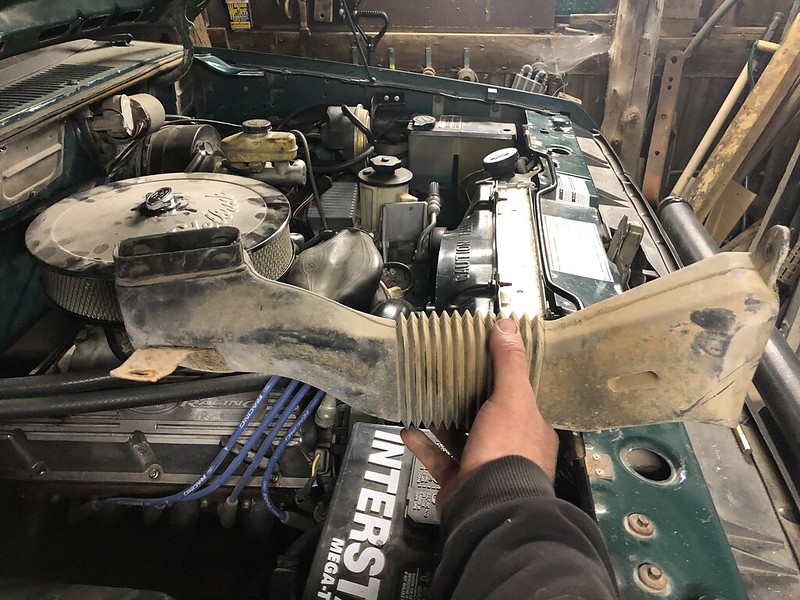

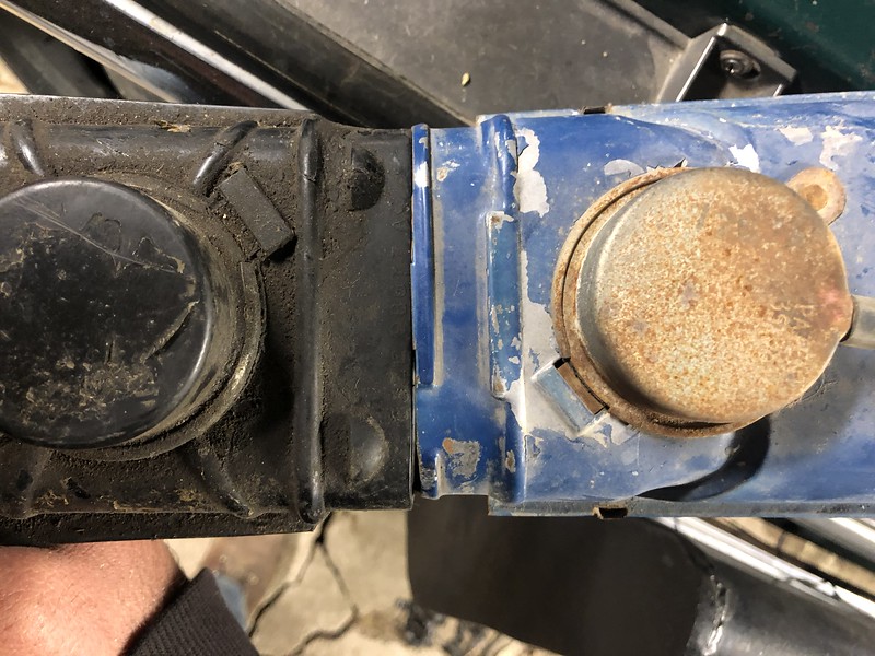

2.3 intake duct.
'85 Ranger Restomod
'85 Ranger Restomod
'85 Ranger Restomod
With a shorter snorkel I think it is going to work beautifully.

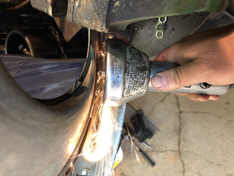

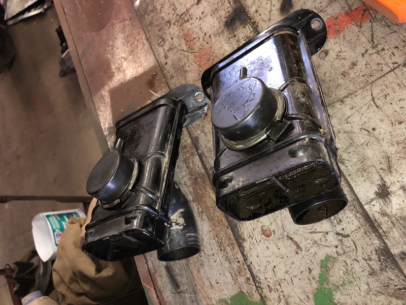

Custom modified my two 2.8 air filter housings:
'85 Ranger Restomod
Harvested two stubby snorkels:
'85 Ranger Restomod

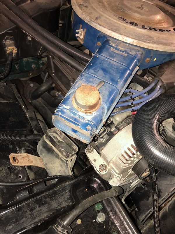

Very rough mockup:
'85 Ranger Restomod

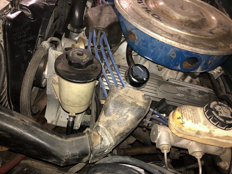

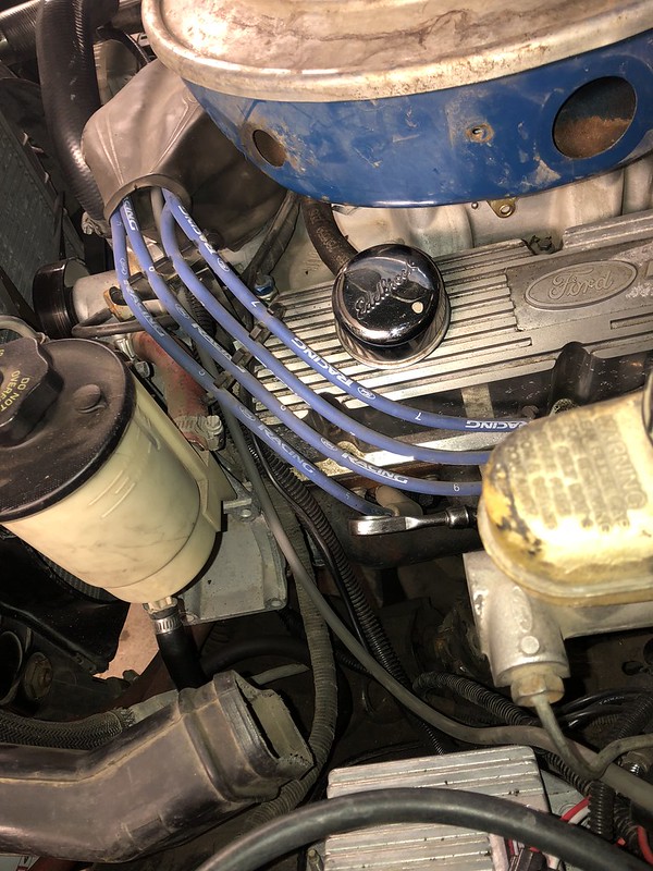

Pretty cool little setup. What about your oil dipstick on the driver side? Kind of looks like it will get covered up by the intake tube and may be blocked by your power steering reservoir.
It has to swoop around the PS reservoir. Its been like that since 2012, good point about the air tube blocking it too.
I have noticed it kind of blocks the oil fill cap which bugs me more than anything. I am going to try to move the tube a little farther back, just for the photo op the 2.8 elbow (minus the accordion part) held the tube against the housing nicely there.

It depends on what I find to couple the radiator support mounted tubes to the snorkels.
If I have to clamp it together it could be an irritation.
Foxbody tubes are available and I suspect would snap right on to the snorkels but the other end is round. I would like to find a used one to play with and see if I could reform the round end very well with a heat gun.

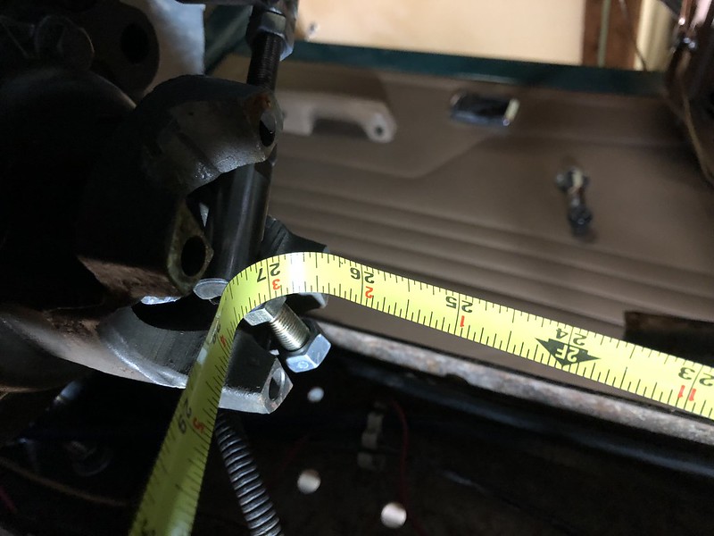

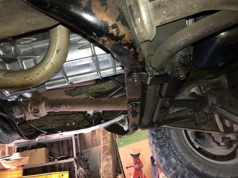

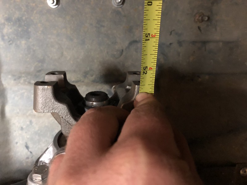

Had the brainy idea I could get another front driveshaft to stick in it so the thing won't roll around could be self propelled. I grabbed the rear half of my '95 front driveshaft (other part is stuck on the diff until I get the axle in the truck and can lock the hubs to hold the pinion) to test fitment. That is a no go...
'85 Ranger Restomod
Need a 27" shaft, I think knock an inch off for a D35 so make it a 26" shaft.
'85 Ranger Restomod
And 52.5" from pinion flange to t-case yoke.
'85 Ranger Restomod
I have a rear driveshaft from a bronco that is also too long and also much larger diameter. It is tempting to just cut and weld it myself to have something to move the truck around.
