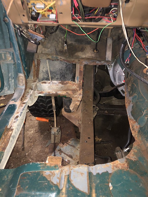

About done with demo:
'85 Ranger Restomod
'85 Ranger Restomod

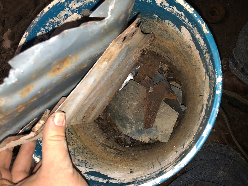

Bucket of shame:
'85 Ranger Restomod
This was pretty easy, I have a inkling fitting the new piece will be a PITA though.
I need to keep an eye on this. I need to cut cancer out of the F150 pretty soon.
What is that tool you are using for cutting?
The nibbler thing worked good for getting it opened up. Feed the steel in even, if you come out at an angle so one side is empty you can snap the blade (ask me how I know) Jaw does open far enough to take in double thick steel so when you come up to a support it just stops which is nice.
Tried a sawzall, it worked but is bulky/clumsy and likes to hit stuff on the other side.
Occelating cutter is working good. Handy size/shape and once into it cuts pretty nice if you don't push it too hard. No good for plunge cutting, takes forever cut that way. Mine (Craftsman) has a headlight which is nice so you can see where you are going. The "metal" blades may or may not be intended for steel, they work quite awhile. The original one that came with mine broke, I have knocked a couple teeth out of a replacement Dremel blade but I have covered a lot of ground with it. And it is neat in that there is no sparks. Also very noticeable when you come up against a hidden support.
And of course tinsnips.

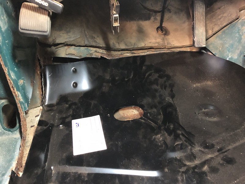

Initial plan was to drive it to work and use the plasma and cutoff wheel over the winter. Then I would have had a sandblaster to clean the floor support too.
But painting in the winter sucks and I don't have air (for tools) or plasma at home.
But it seems I am getting the worst of both worlds. No air, no plasma and still too cold to paint.
Kinda thinking I should have done the floor when I had the trans out. Then I could be putting the trans in whenever rather than waiting for warm snaps to paint/coat. Never figured it would drag on this long, canceled insurance on it yesterday since the odds of it getting on the street before snow flies are slim.

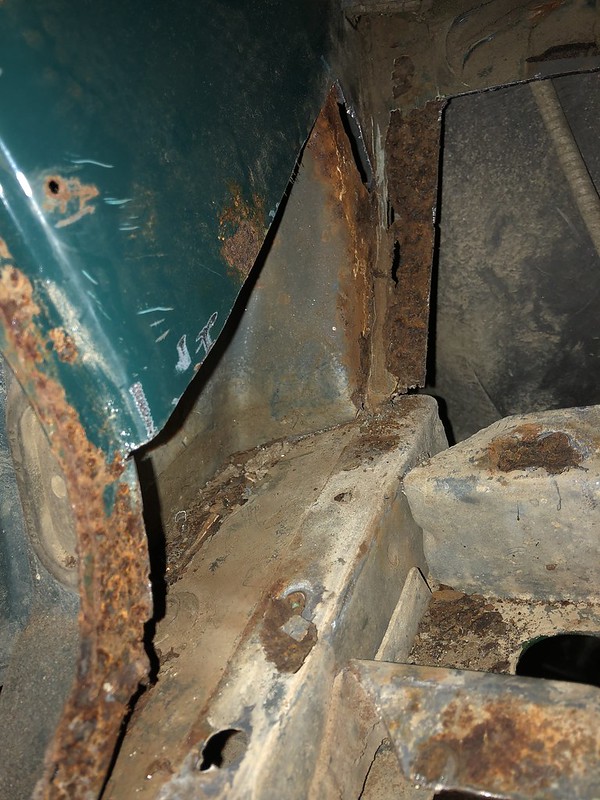

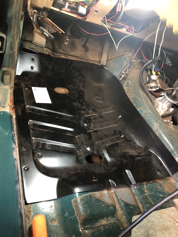

Broke out the grinder to clean up the spotwelds:
'85 Ranger Restomod

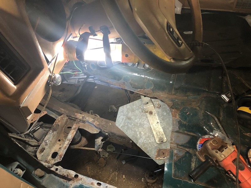

Went too far up the floor cutting...
'85 Ranger Restomod
Panel doesn't fit too bad though
'85 Ranger Restomod

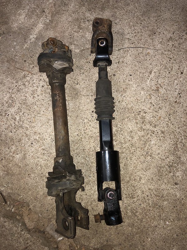

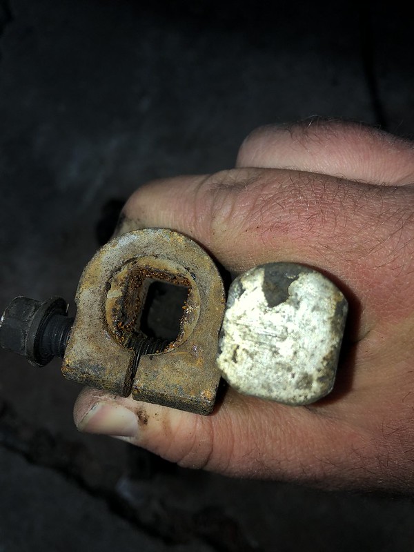

Popped out the steering shaft:
'85 Ranger Restomod
And hit a snag, steering wheel shaft on a Ranger is way bigger than that of an Aerostar.

you have the wrong aerostar shaft....need the earlier one.
Do you know what year range?

well....80's i assume for the shaft. i dont remember when they changed...maybe 89-91 is the square style like you have. i probably have a few somewhere:icon_confused: with various other steering stuff.
This one is from like a '93 or '94. I checked before I pulled it and was surprised there is no write up on it.
