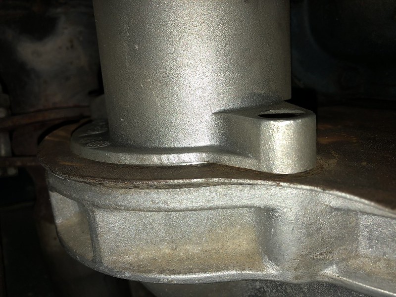

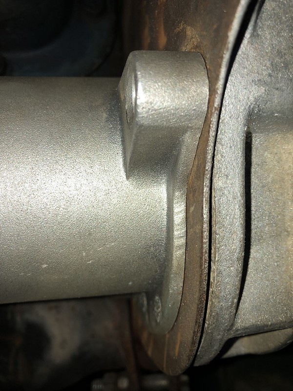

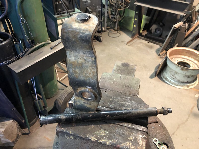

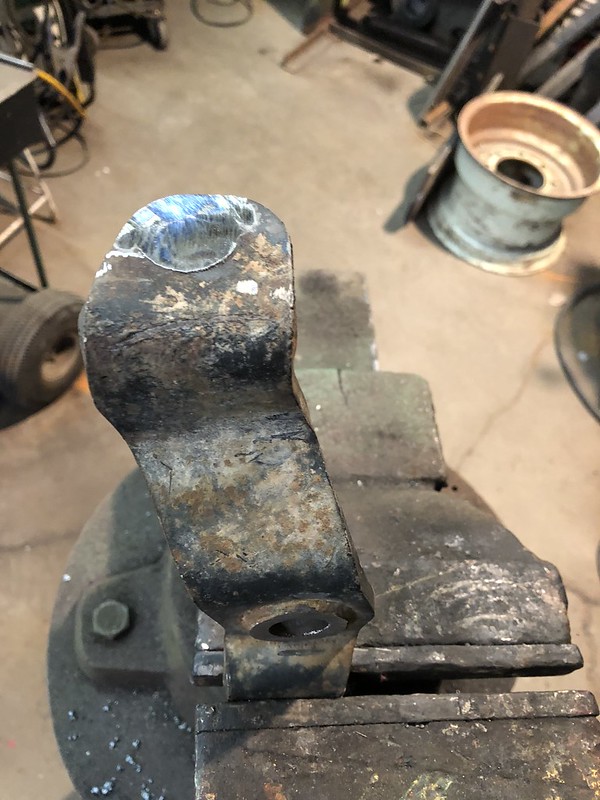

Welded the tab on the FWD rail and drilled a hole in the tube for the RWD rail. Unanticipated snag in that the RWD rail is tight enough to the trans that there isn't room for a nut on the bolt.
'85 Ranger Restomod
Overbored the bottom hole and welded a nut into it for a shorter bolt to screw into. If I had it to do again I would have used thicker tube and just tapped threads into it. Also bent and welded the piece onto the RWD rail tube.
'85 Ranger Restomod
Threw some paint on them, should fit nicely once I get the linkage put together to go between the shifters and the rail brackets.

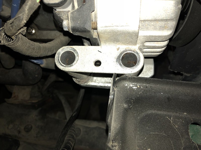

Had to pull the battery and alternator to change the front bushing, haven't put it back together to see if I am going to have clearance issues with the alternator and battery tray yet...

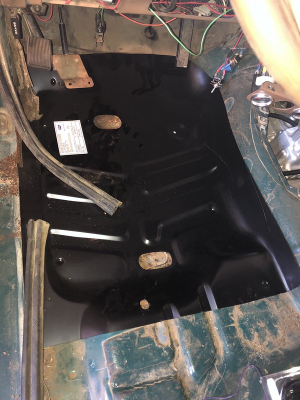

Nice floor pan! I was under the impression they aren't available
I think that is mainly the newer trucks they don't make them for.
Just about everyone has them for first and second gens.

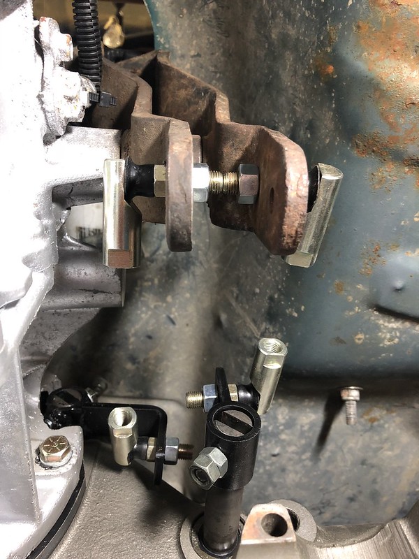

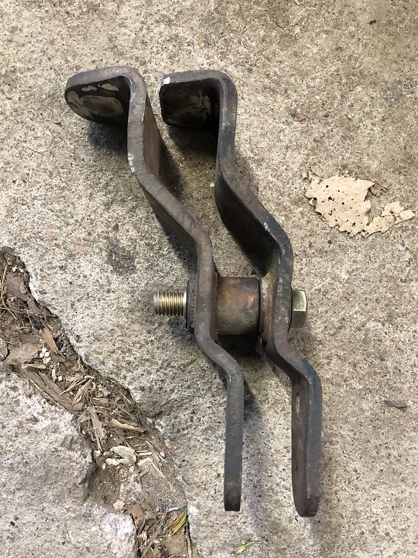

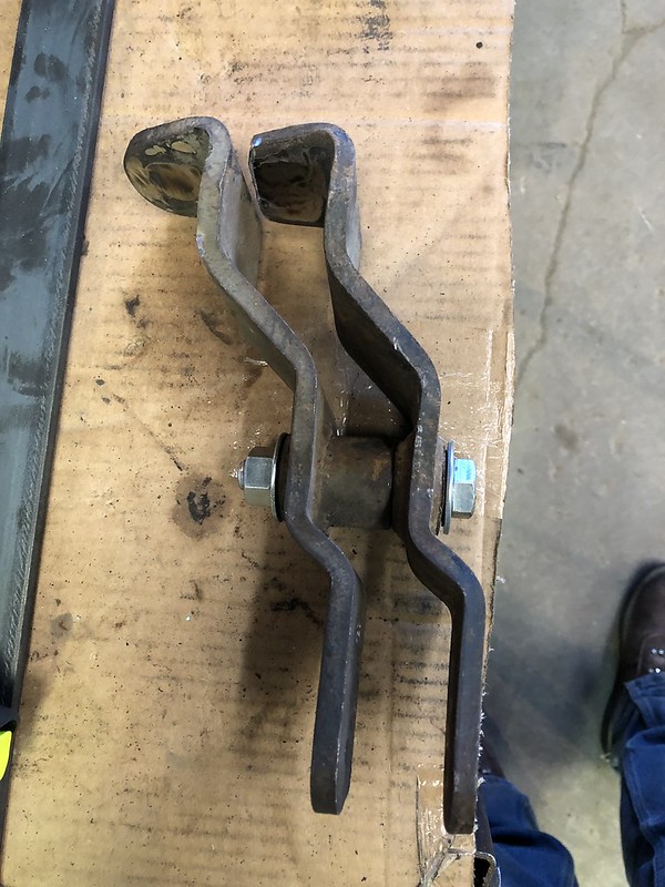

Modified the pivot of one of the levers to hopefully reduce some of the stress on the bolt and maybe give me room to reinforce it.
'85 Ranger Restomod

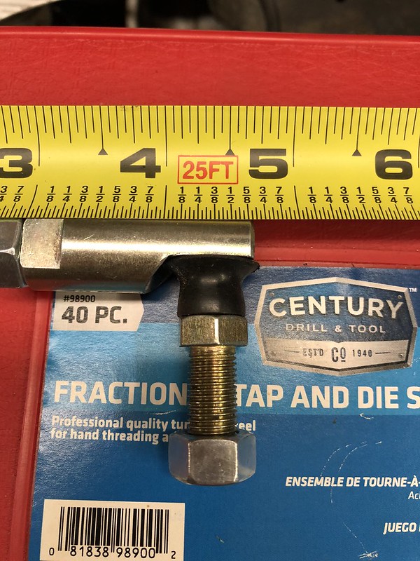

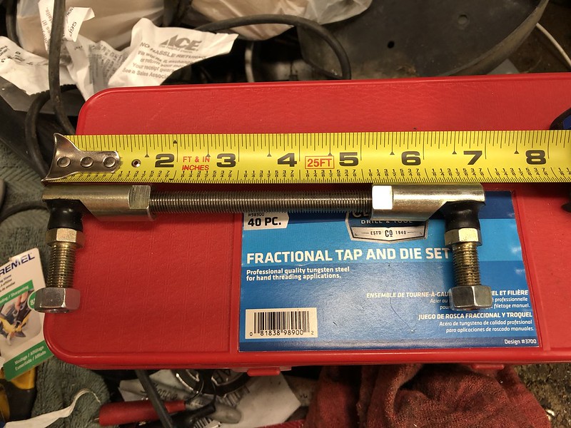

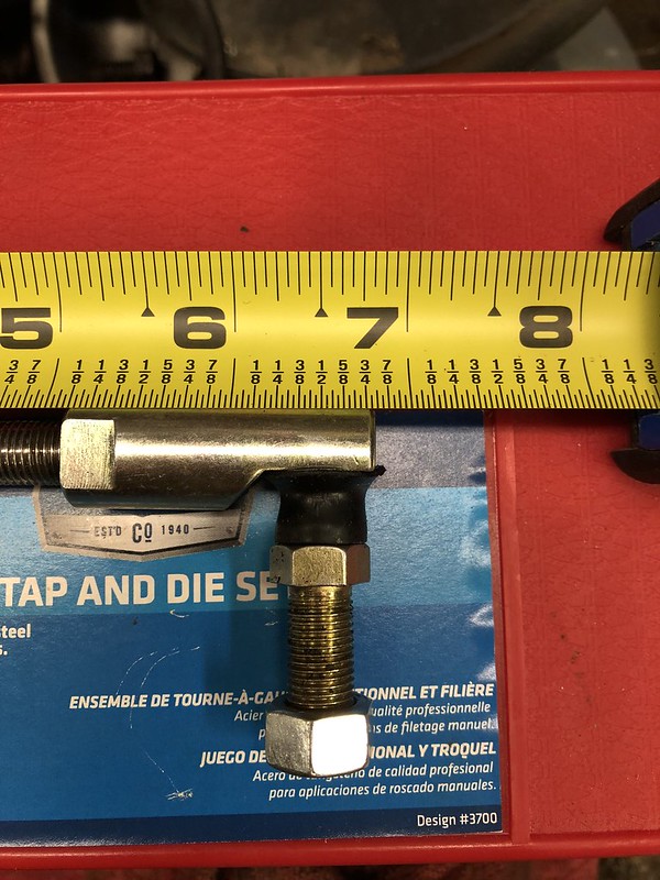

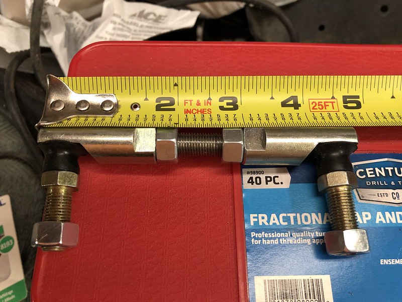

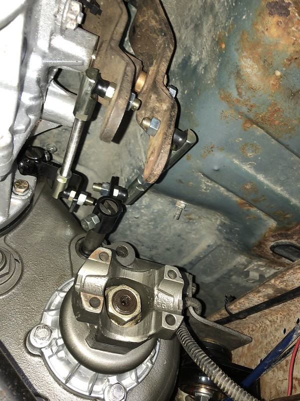

Picked up balljoints and 3/8-24 threaded rod for the linkage, I almost got the eye style ones like what comes with the kit but I liked the clearance and greater flex of this style.
'85 Ranger Restomod
'85 Ranger Restomod
FWD linkage:
'85 Ranger Restomod
'85 Ranger Restomod
RWD linkage:
'85 Ranger Restomod
'85 Ranger Restomod
Shifts very nicely, nice and easy. Throw is maybe a little more than I would prefer but it is what it is.

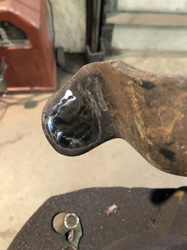

Lots of dremel time Friday night. .046" might not sound like much but it is quite a bit to dremel.

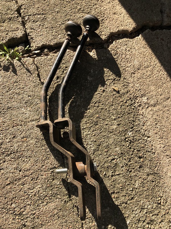

Got started building the levers on Saturday:
'85 Ranger Restomod
'85 Ranger Restomod
'85 Ranger Restomod
x2
Doctored the outside lever up so the top wouldn't hit the inside lever.

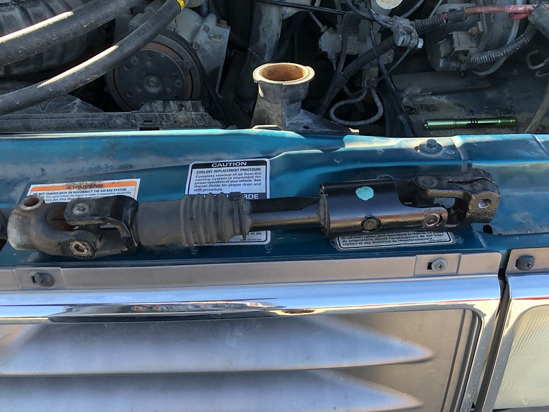

I also found a nice Aerostar and robbed the steering shaft out of it. I don't think I have ever worked so hard to spend $7 in my life, ended up running to Lowes and getting a chisel to spread the bottom yoke which then made it very easy.

Why an Aerostar steering shaft?

My steering shaft needs new rag joints, the Aerostar shaft is supposed to be a little better having regular u-joints which are more compact and also just plain better looking. Just eyeballing it when I got home it looks like I will have to take the extension out that came with my bodylift which will clean that up (more OEM appearing)

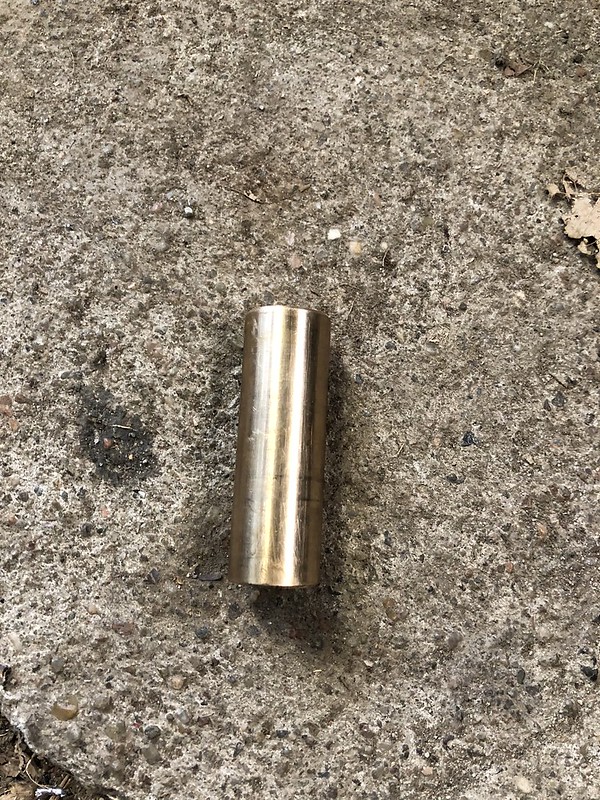

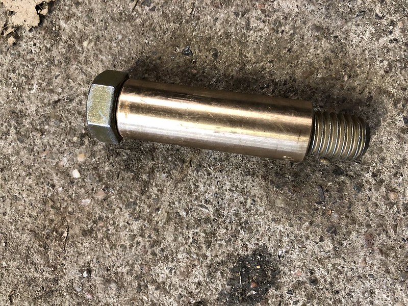

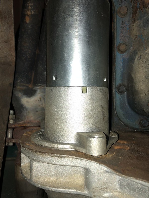

Figured out the thread for the 4wd shifter, 9/16 which is my least favorite thread. 1/2 kinda works and 12mm kinda works but neither are right. Anyway, I had to get a different bronze bushing. 9/16"x3/4"x2.5" Baum Hydraulic part # CB09-1218
'85 Ranger Restomod
Perfect shoulder bolt:
