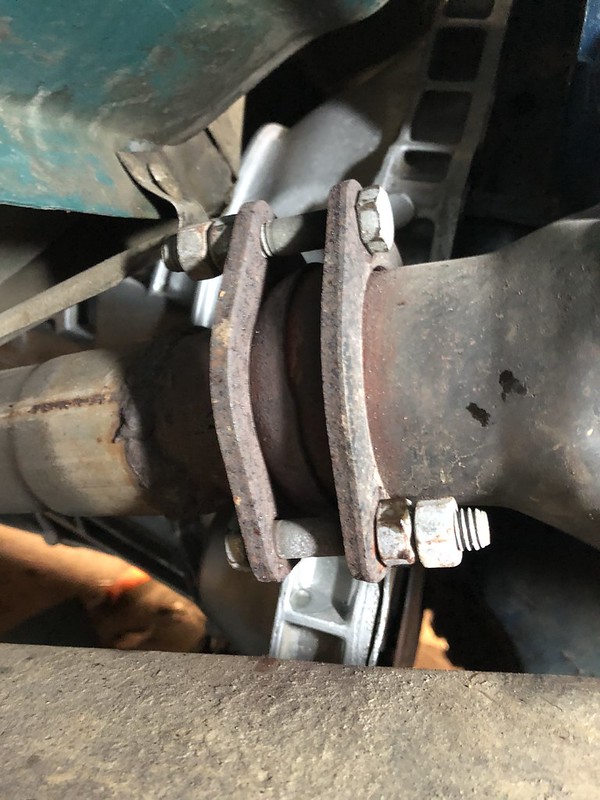

Not sure if the bolts stretch or what is really going on. The locknuts (yes full steel locknuts) are tight but I haven't touched the jam nuts. That is quite a bit of gap...

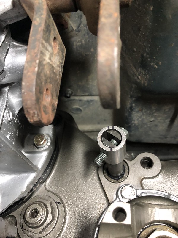

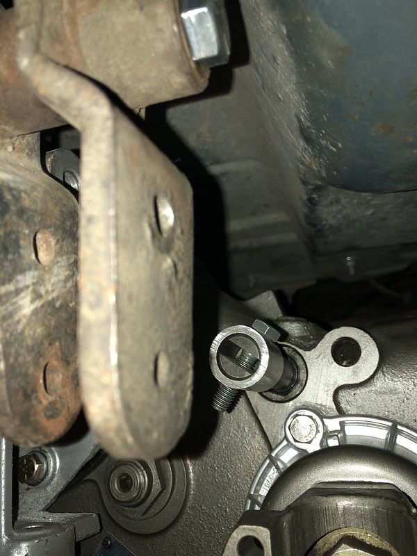

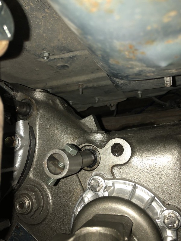

Front shift rail will be easiest, I am going to start with it. Rear rail is much higher and out of line, I would rather use use the upper hole in the shifter to keep it more in line. Going to do the front first and if I need more leverage I can flip it over and use the bottom hole.
'85 Ranger Restomod\

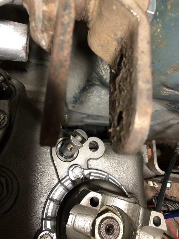

You can see the rear rail is in line with the boss for the shifter hence my concern having it reach down farther than it has to.

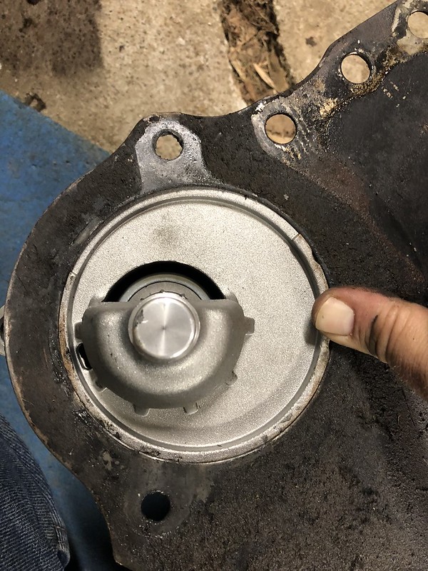

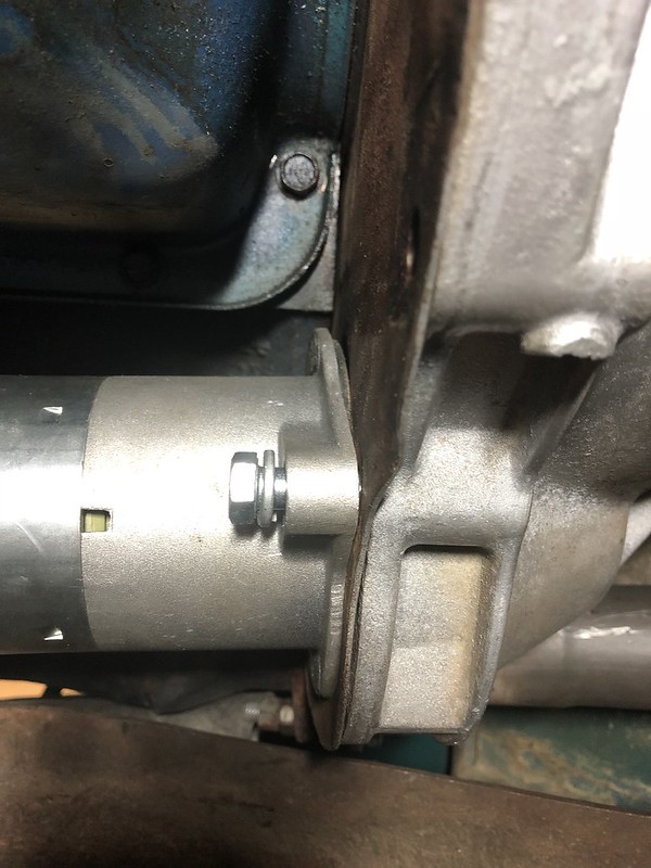

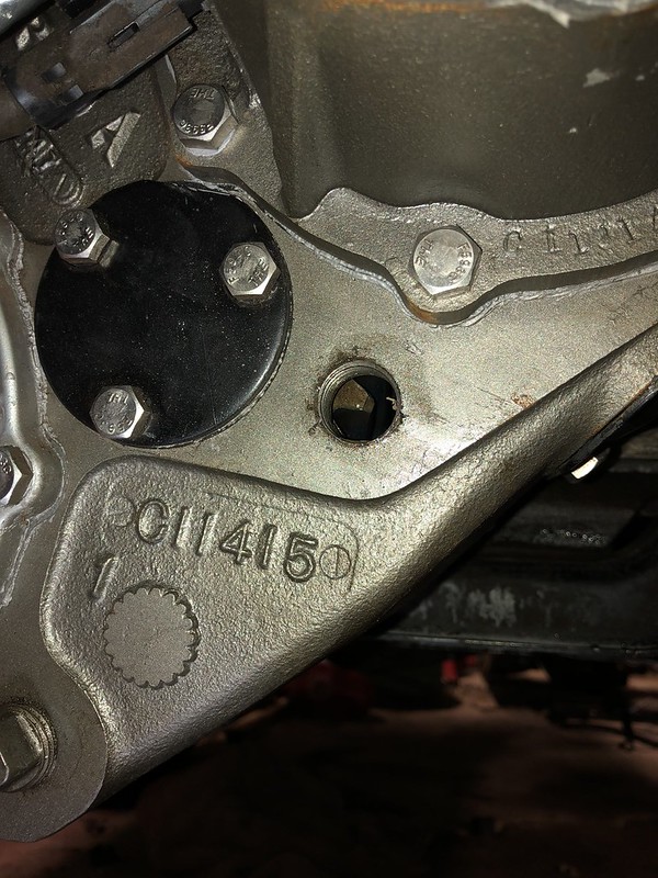

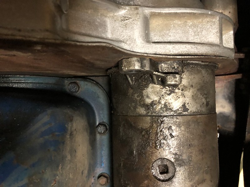

Tried and didn't get much accomplished tonight. Went to put the starter in, had to drill out the hole in the starter cable which was fun. Then the starter locating boss would not fit in the hole.
'85 Ranger Restomod
Ok, that is weird, go grab my automatic starter (an OLD Motorcraft that came with the '78 302 I got way back in the beginning)
Thunk, it goes right in.
'85 Ranger Restomod
Go grab my automatic separator plate and try it, same deal.
'85 Ranger Restomod
:icon_confused:
I am going to try to open up the starter hole and hopefully it all works out for that.

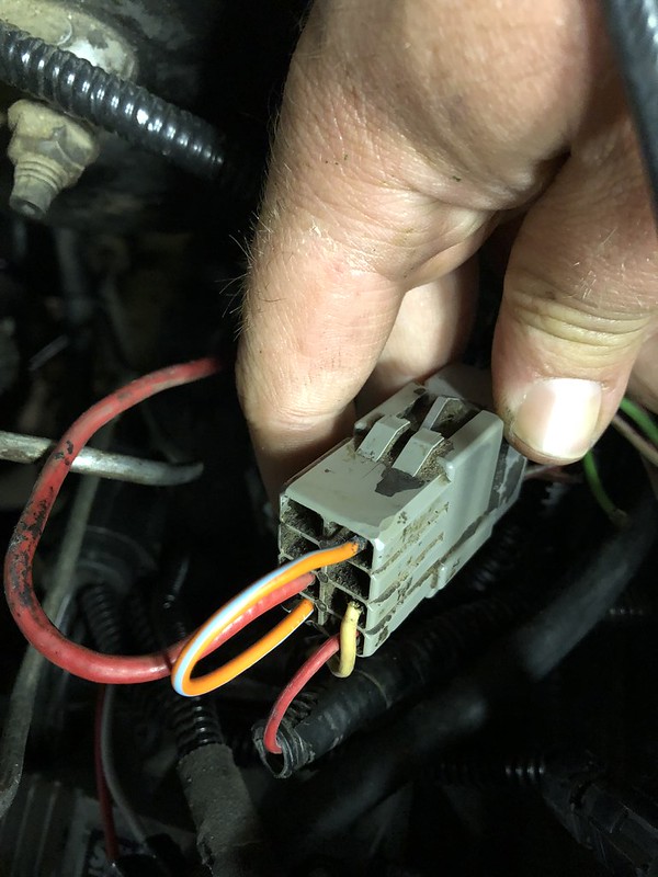

Eliminated the NSS system by taking a wire of similar color salvaged from a pigtail and putting another end on it and just looping it back.

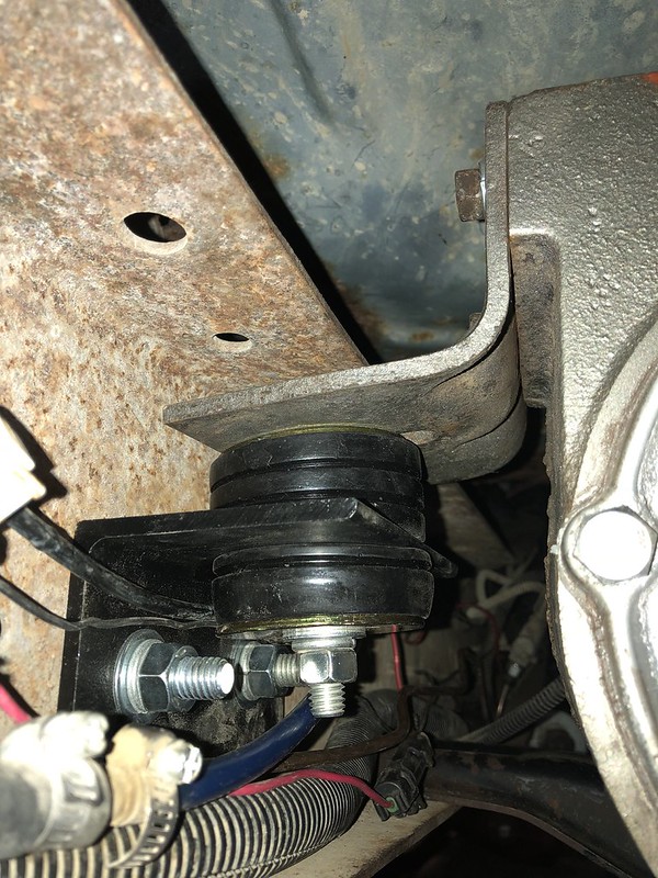

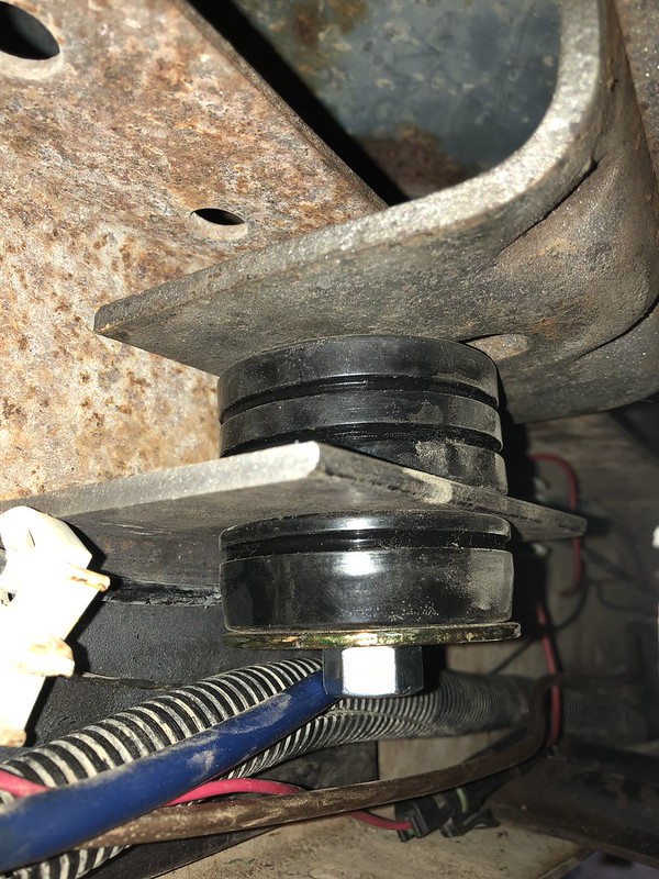

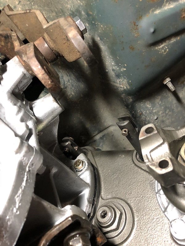

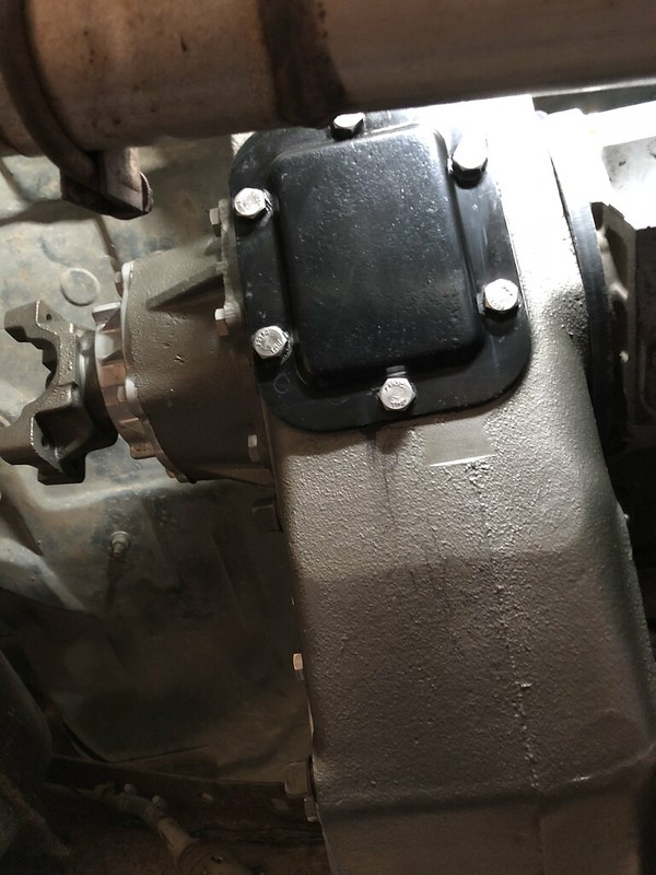

Picked up a 5" piece of 3" 3/16" angle iron, used a hole saw to cut a 1-1/4" hole it for the bushing. I roughly bolted it to the t-case to test fit it, works perfectly.
'85 Ranger Restomod

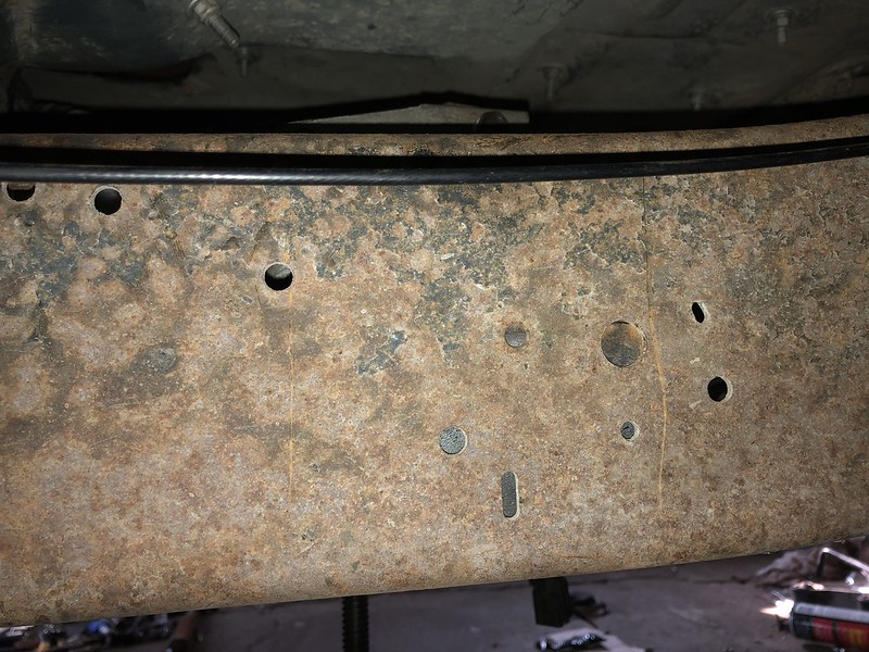

Scratched where the angle iron is on the other side:
'85 Ranger Restomod

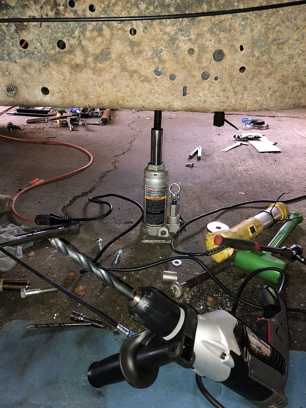

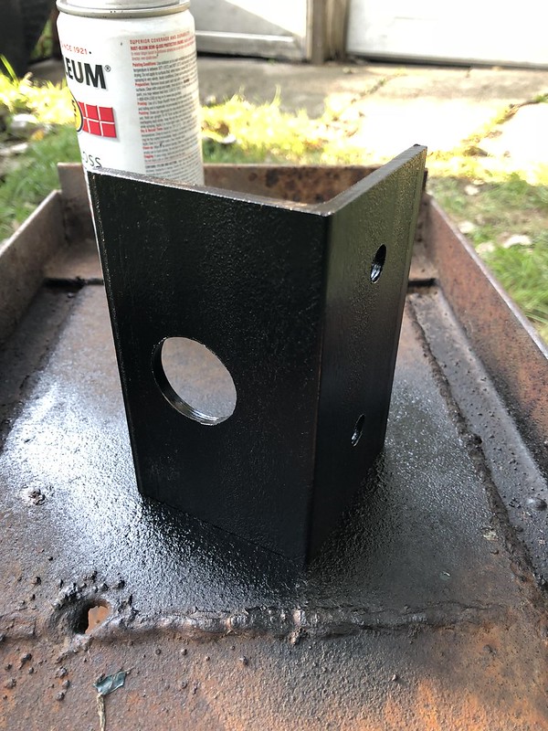

Used my new drill to punch out two holes in the frame. Started out smaller, pushed the angle iron up against the holes and tickled the angle iron with the drill bit to mark where I needed to drill holes in them. I used the angle iron to shield the wiring and fuel line.
'85 Ranger Restomod
I pulled it out and drilled holes in the angle iron with it in my vice. Threw some black paint on it for good luck.
'85 Ranger Restomod
I need to pick up bolts for it, my bolt that goes thru the mount isn't quite long enough either. With those the powertrain is physically mounted in the truck. Just gotta get the starter ironed out and get a rear driveshaft figgered out.

It does fit slick. I do wish I had checked it better before install. I took more off the corner of the trans than I had to but working under the truck with a hacksaw is hard to be very precise. Would have been much easier to do it with the trans out of the truck.
Edit, mount is done. Powertrain is now fully suspended in the truck.

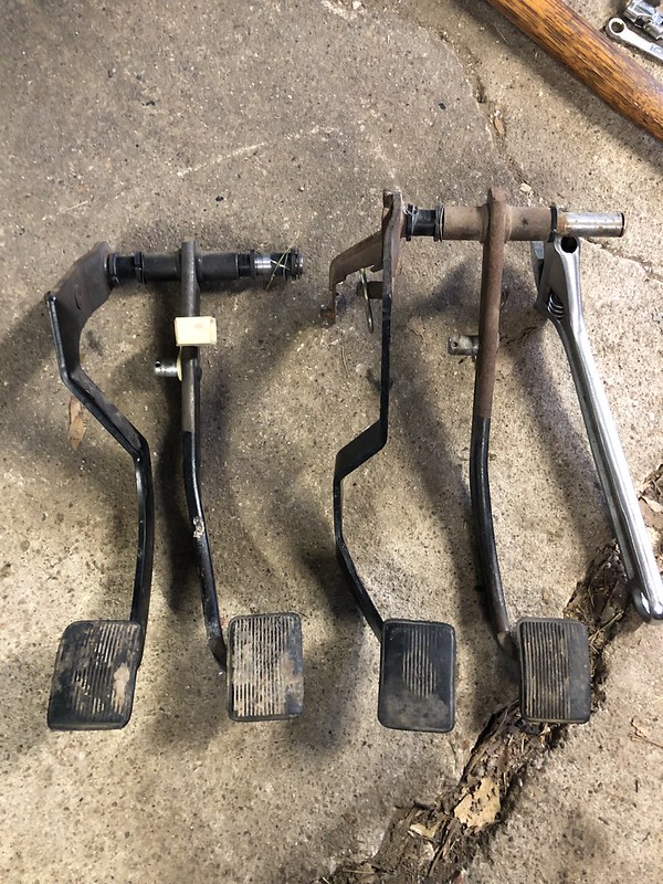

Comparing the '88 pedals on the left and and '83-87 pedals on the right. One zigs and one zags, makes sense why the older pedals have interference issues with the newer style clutch switch. Brake pedals are the same part number.

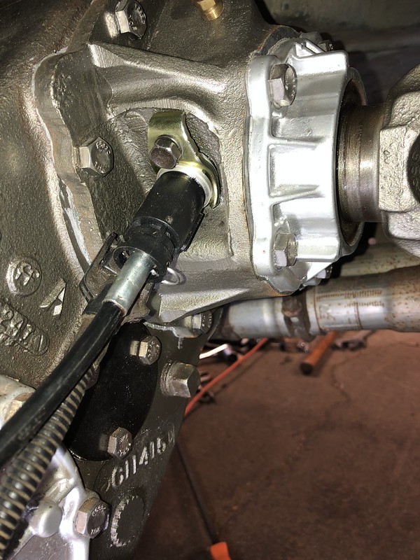

VSS is in. When I ordered the new cable I ordered one for the A4LD thinking that is what the truck had and is the longest available transmission. Well apparently that is also automatic. Not thinking that the cable goes into the gear farther with an automatic gear. 4wd uses the same speedo gears as a manual. So I had to nip about 1/4" off my new cable for it to work. :annoyed:
'85 Ranger Restomod

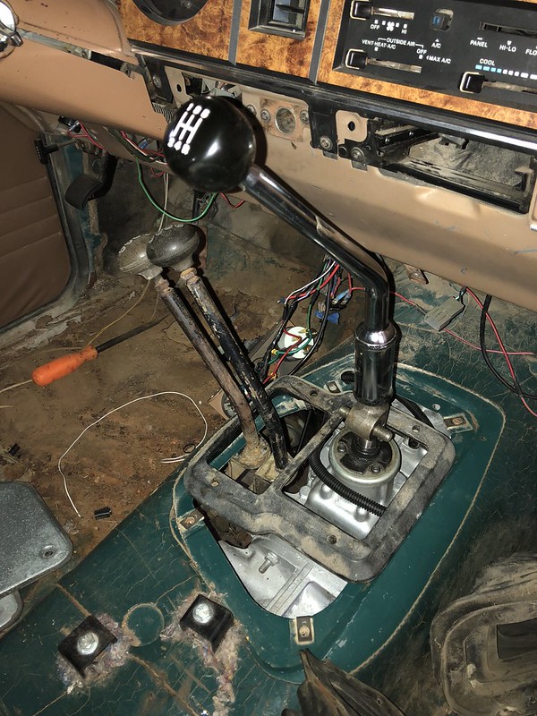

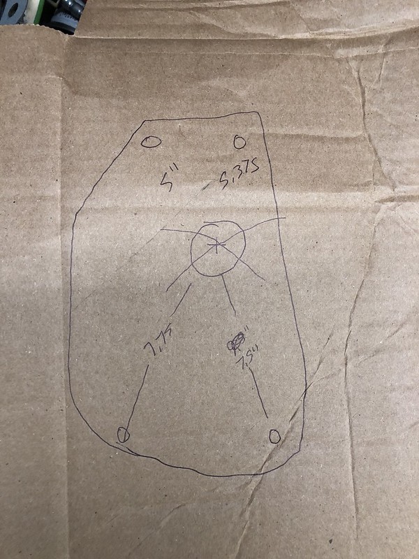

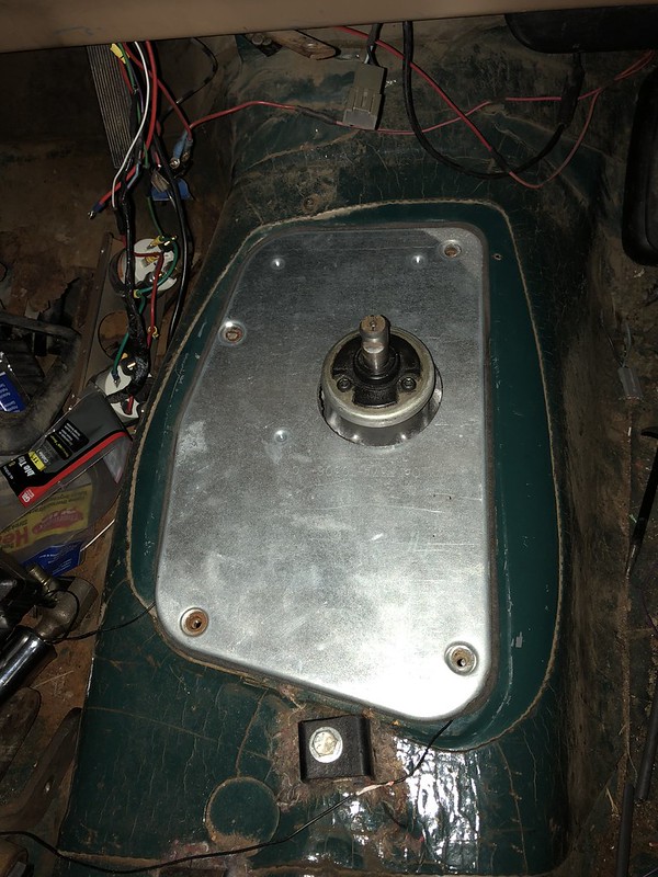

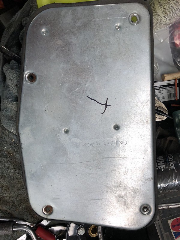

Measured for my shifter hole in the floor plate:
'85 Ranger Restomod
X marks the spot. All four measurements meet at that point so it should be pretty accurate.
'85 Ranger Restomod
I had to drain the rear oil sump when I did the rear seal. I drained the front one tonight, changed the filter and put new oil in.
Cut a hole in the floor plate for the shifter, looks freakily professional.
